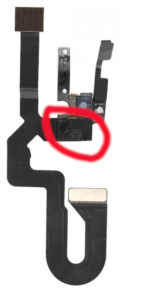

I used to repair Iphones a few years ago and at a temporary job choice. When you removed the sensor package originally, one of the adhesives act like an insulator against the metal of the of the phone. When you are changing screens it gets left behind when trying to remove the sensor. If I remember correctly it was a small black square of adhesive that needs to be replaced/reinstalled to keep it from happening. There are some metal contact pads under it. If you no longer have the small black adhesive pad, it is those contacts that ground against something and are causing your constant reboot. So get the thinest piece of tape you can to at least cover those contacts. The circle in the pic I attached is the black adhesive pad of concern. Hope this helps.

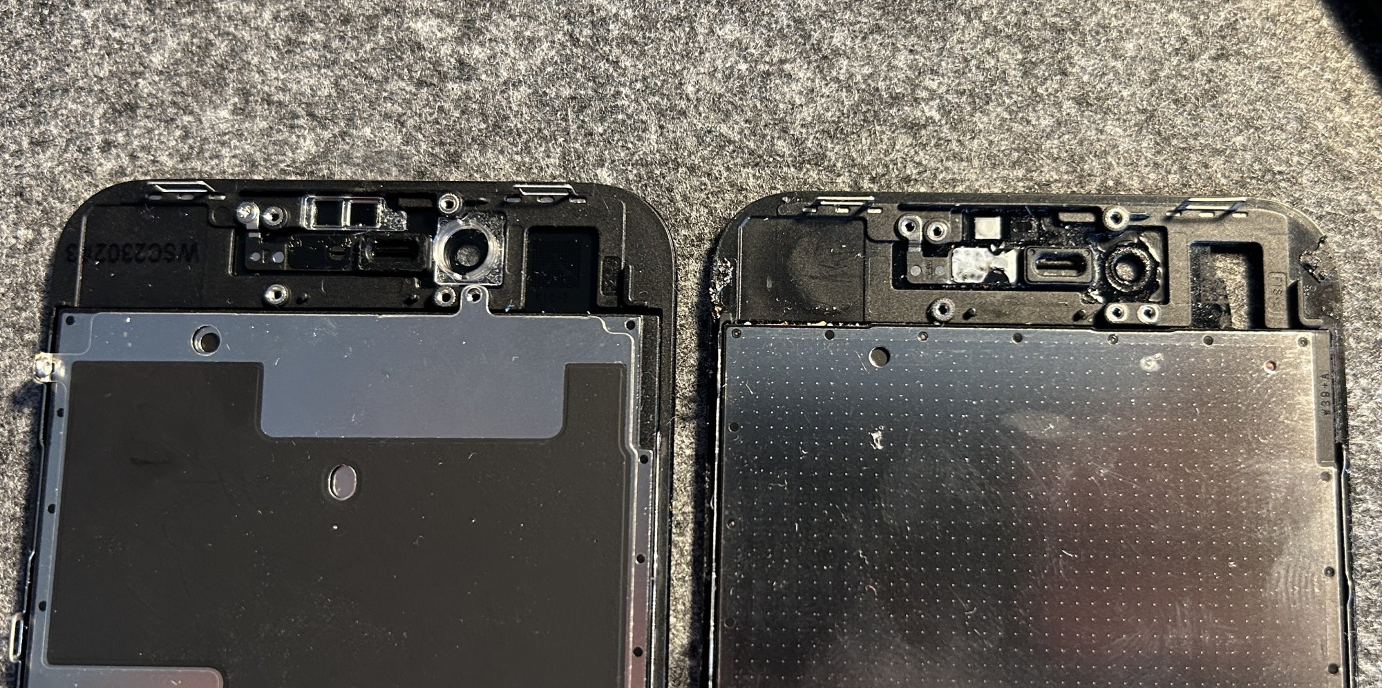

I just took photos of the screen assemblies.
Left is the new one - on the right is the old one.
Where would that adhesive go?

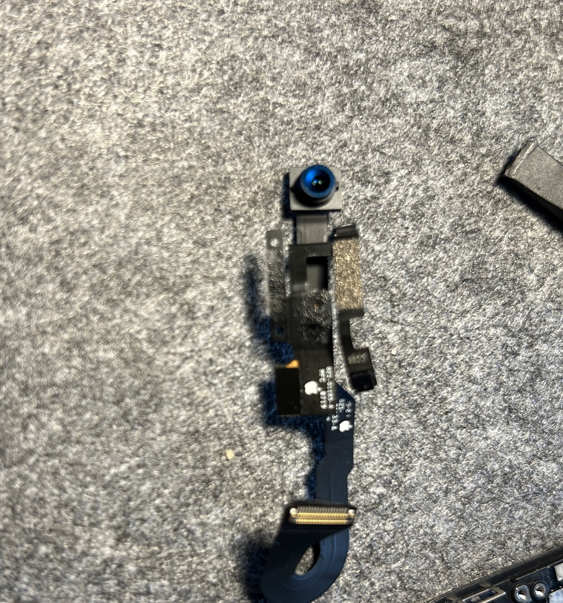

Here is my camera module with sensors - thanks a bunch!
