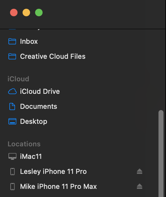

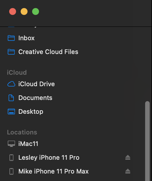

Open Finder and it should visible in the Sidebar like this:
It does sometimes need a bit of encouragement to appear. Use a cable if it hasn't been set to use to use wifi, and cable will be quicker anyway.

What is visible?
When i connect my phone i also see it in the sidebar.

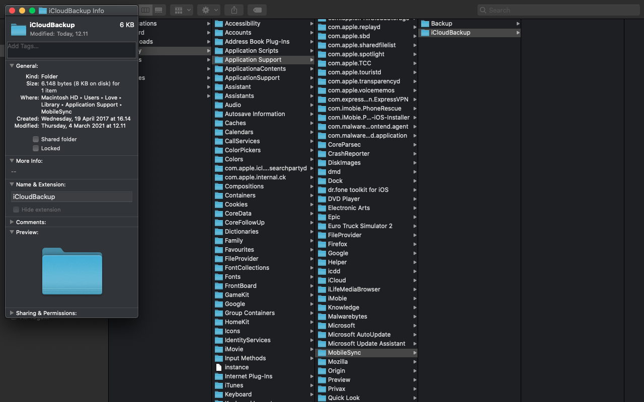

I moved it back to the originale location when i figured out i couldn't back it up from there.
I now did what the article told me to do / I made my user library visible.
I am using Mac os Catalina - Every article is just talking about iTunes but i have Music.

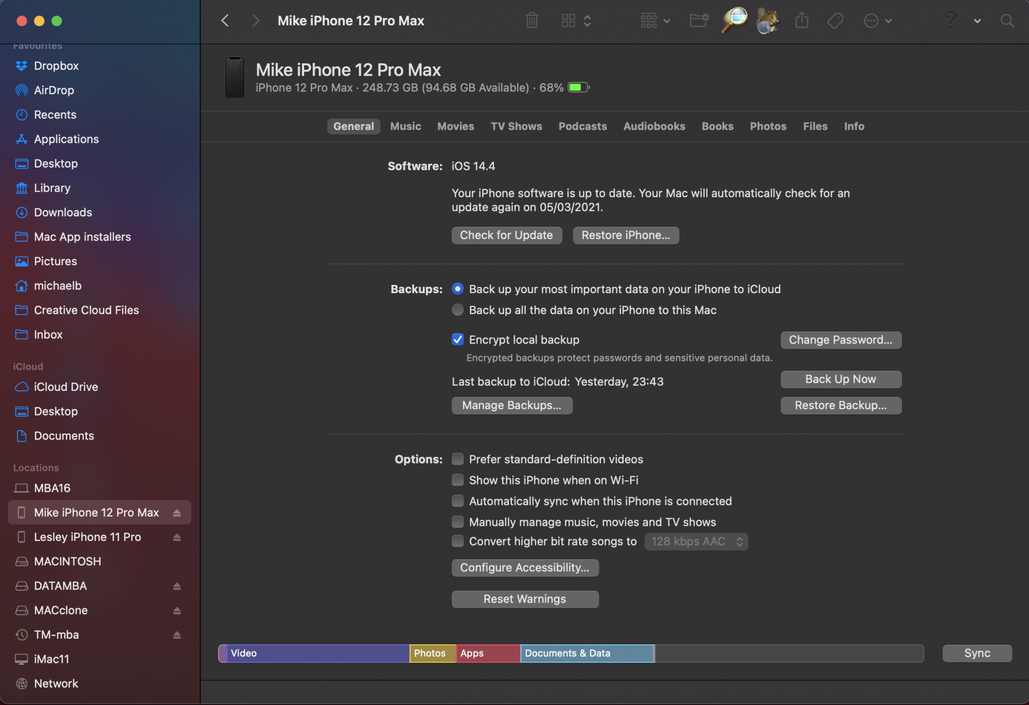

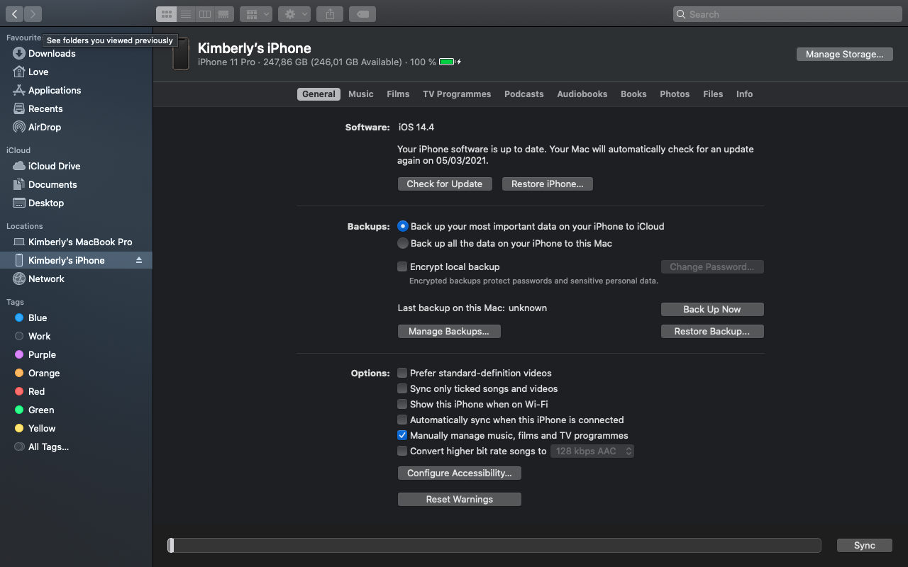

Finder does what iTunes used to do. This is the screen I see in Finder for my iPhone 12. Do you see this?

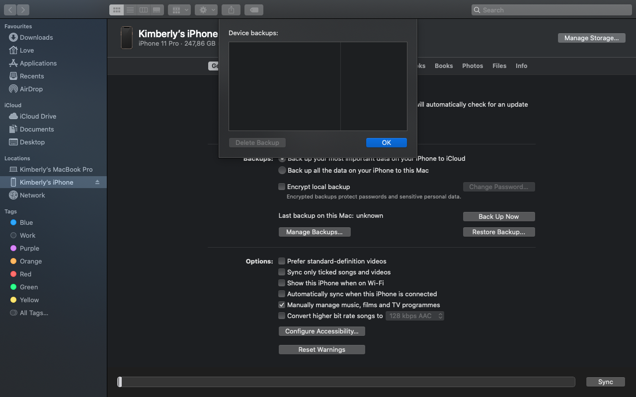

That explains why you are not being offered a backup. Maybe something went wrong during you attempt to move out it to iCloud and back again.

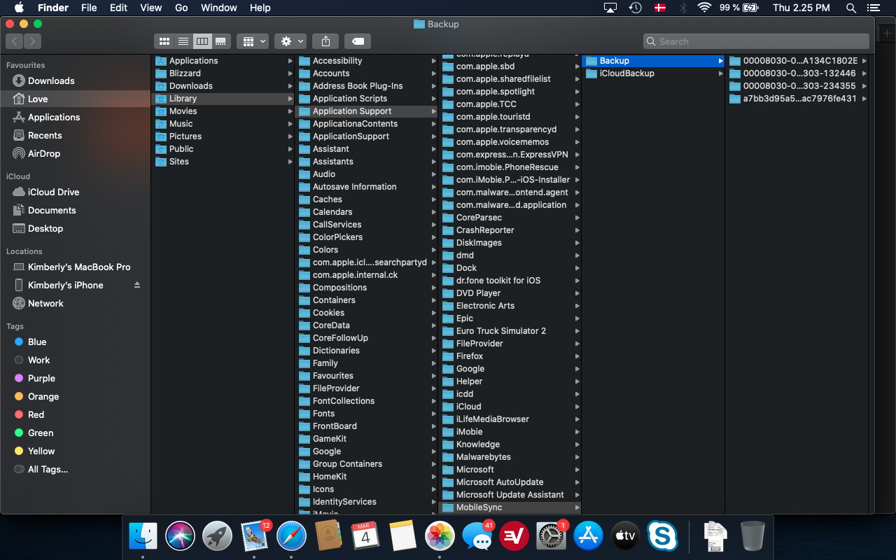

Did you definitely put it back in the User Library not the main library. Can you send a screenshot of your ~/Library/Application Support/MobileSync/Backup folder Mine looks like this: Ignore reference to iMazing and that my "Backup" folder is a symlink. Yours should look similar.
Before i moved the backup to iCloud i had the same empty box.
Here is a screenshot

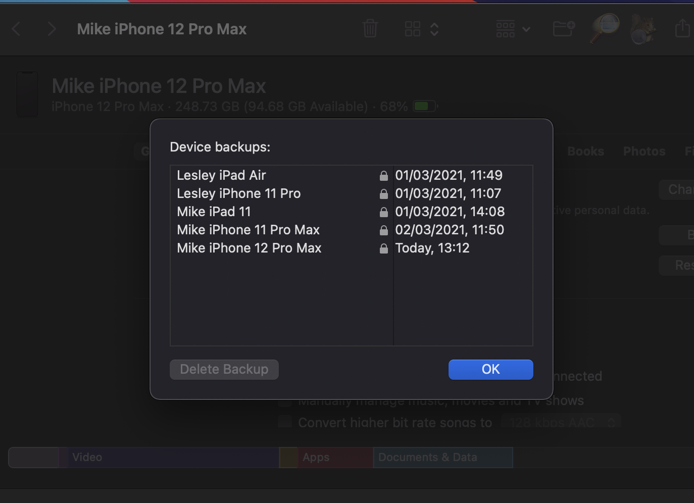

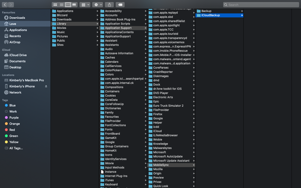

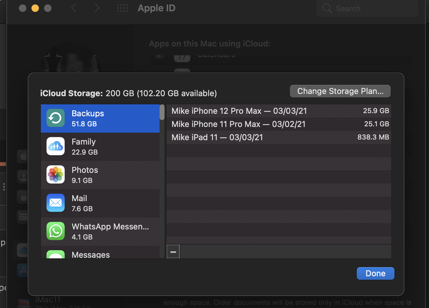

That has me stumped. From that screenshot there appear to be four devices backed up, but Manage Backups is not seeing any of them.
What is that iCloud Backup folder...is that something you created? I have never seen anything like that. If you put it there I would delete it.
You could try rebooting if you haven't already.

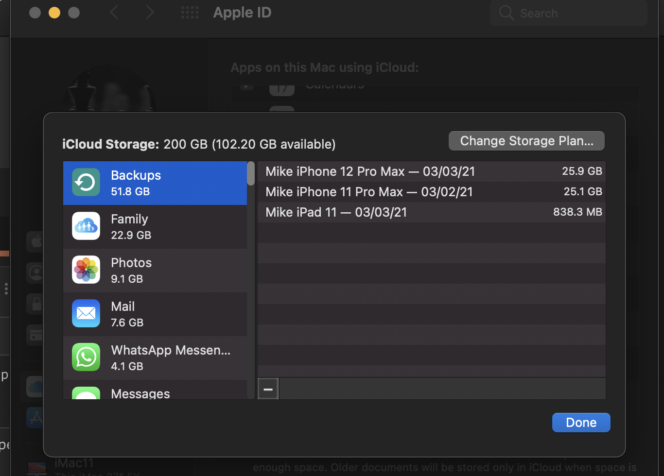

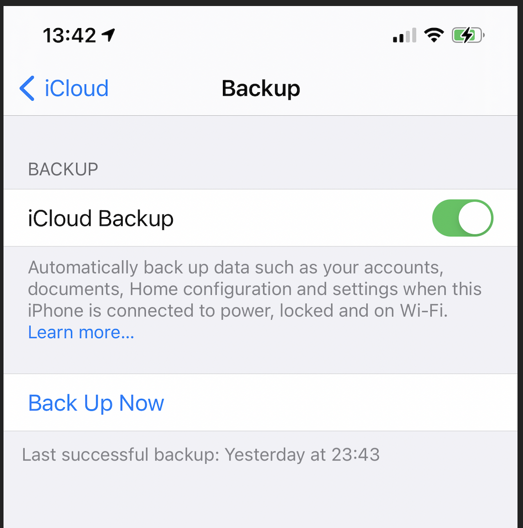

Is there any possibility that iCloud has been backing up the phone without you realising? Not sure whether it is on by default? You can tell by either looking at your iCloud storage usage in Apple ID or on your iPhone Settings > YourName > iCloud > Apps using iCloud > scroll down to iCloud backup. Bit of a long shot this as I think you should see in the Finder if it has been backed up to iCloud. Also don't think it is on by default.

There is nothing in that iCloudbackup file - See Screenshot.
I clicked on the Info of the file - See the screenshot.
Its modified because i moved the backup in that folder as well, because i thought that would make a difference but it is created in 2017.

I have never used iCloud backup before today. I have always backed up in Music, so i know that it hasn't backed up automatically - I wish...

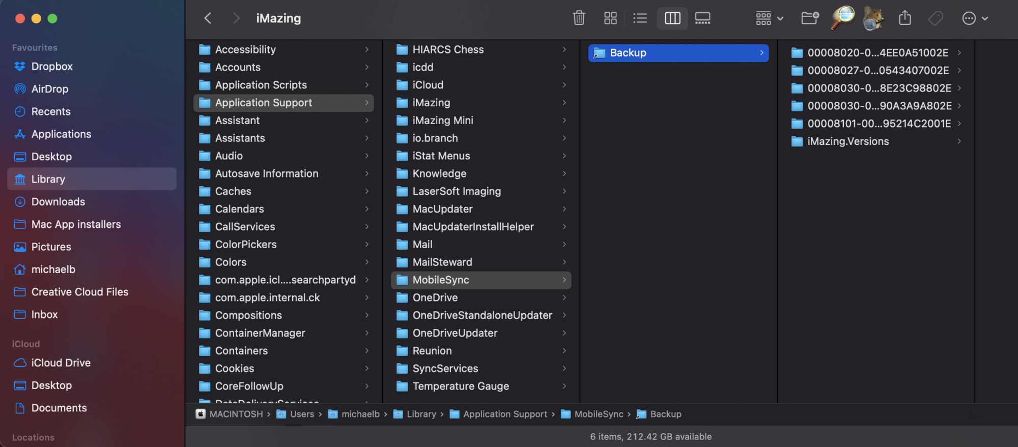

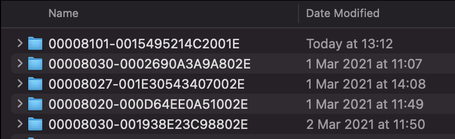

Here is a theory. The MobileSync/Backup folder had a few backups in it: your most recent one and some from 2017. When you tried to put the most recent one on iCloud and move it back, it went somewhere else. The ones left in the MobileSync/Backup folder are the 2017 ones, which maybe don't show in Manage Backups because they are so old.

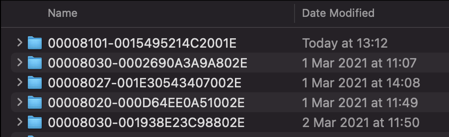

What does your MobileSync/Backup folder show in List view?...is your most recent one there? This is mine:

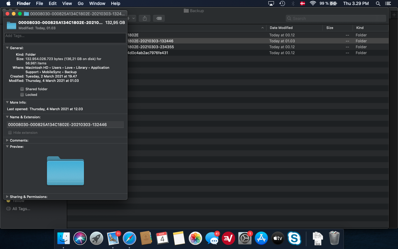

I have attached the info regarding the Icloudbackup file. I have removed it to the bin now.

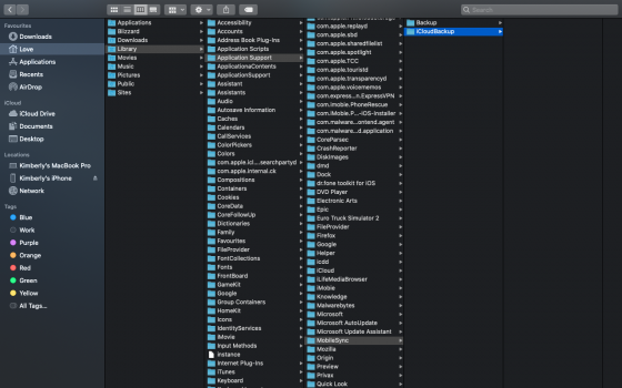

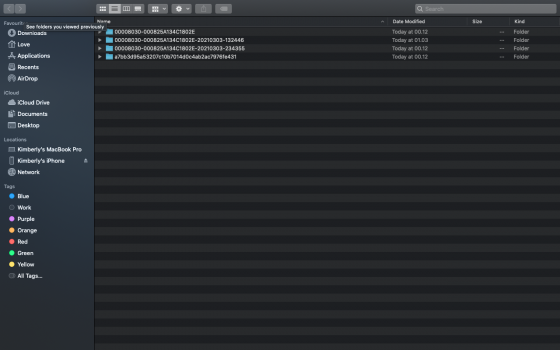

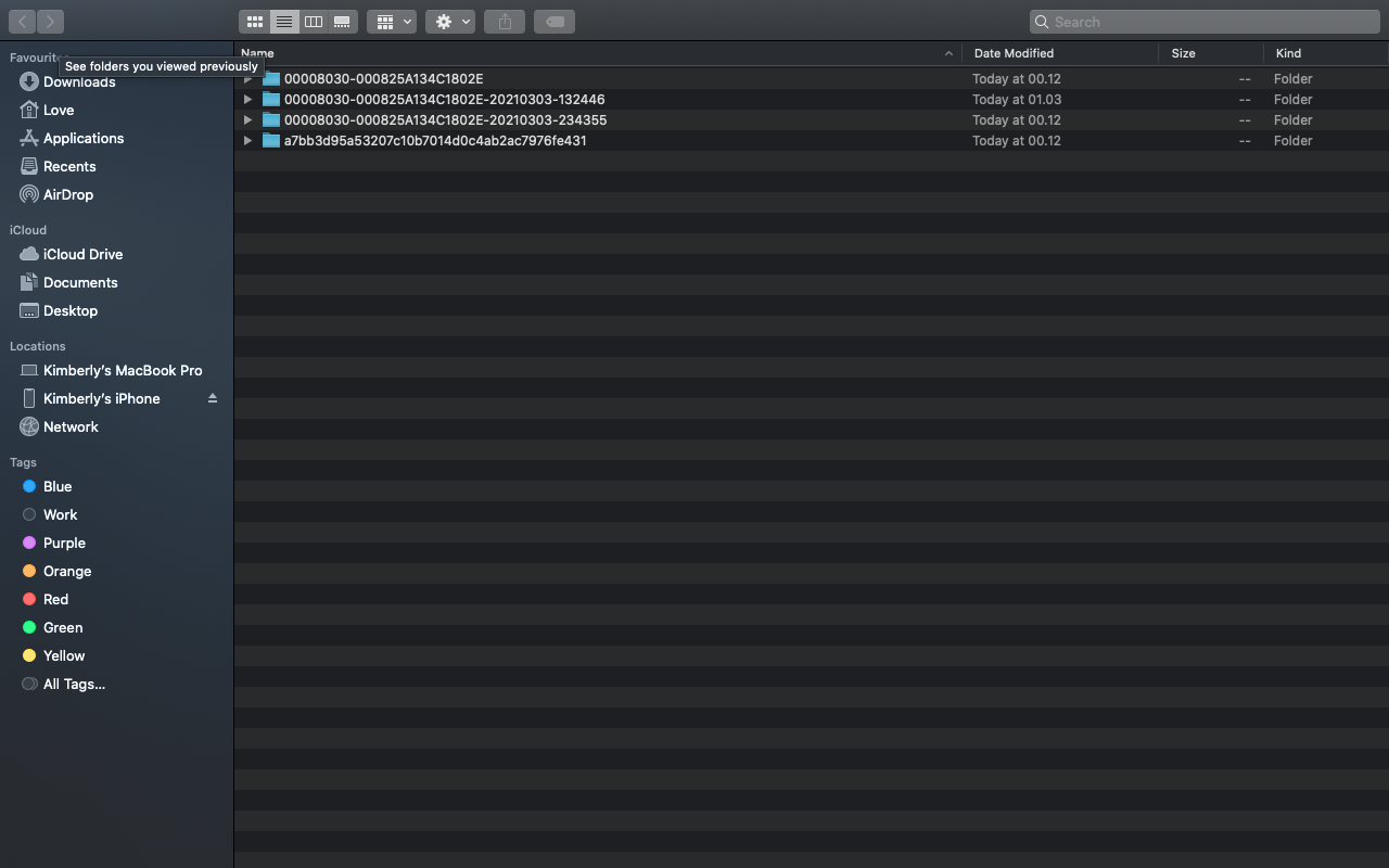

Here is the list screenshot.
I have attached the file that shows the file i created for a few days ago - Its also the file with stuff in it

My theory appears to wrong. I am stumped again. Your recent backup appears to be in the right place but it is not being offered as an available backup to restore, and does not appear in "Manage Backups".
