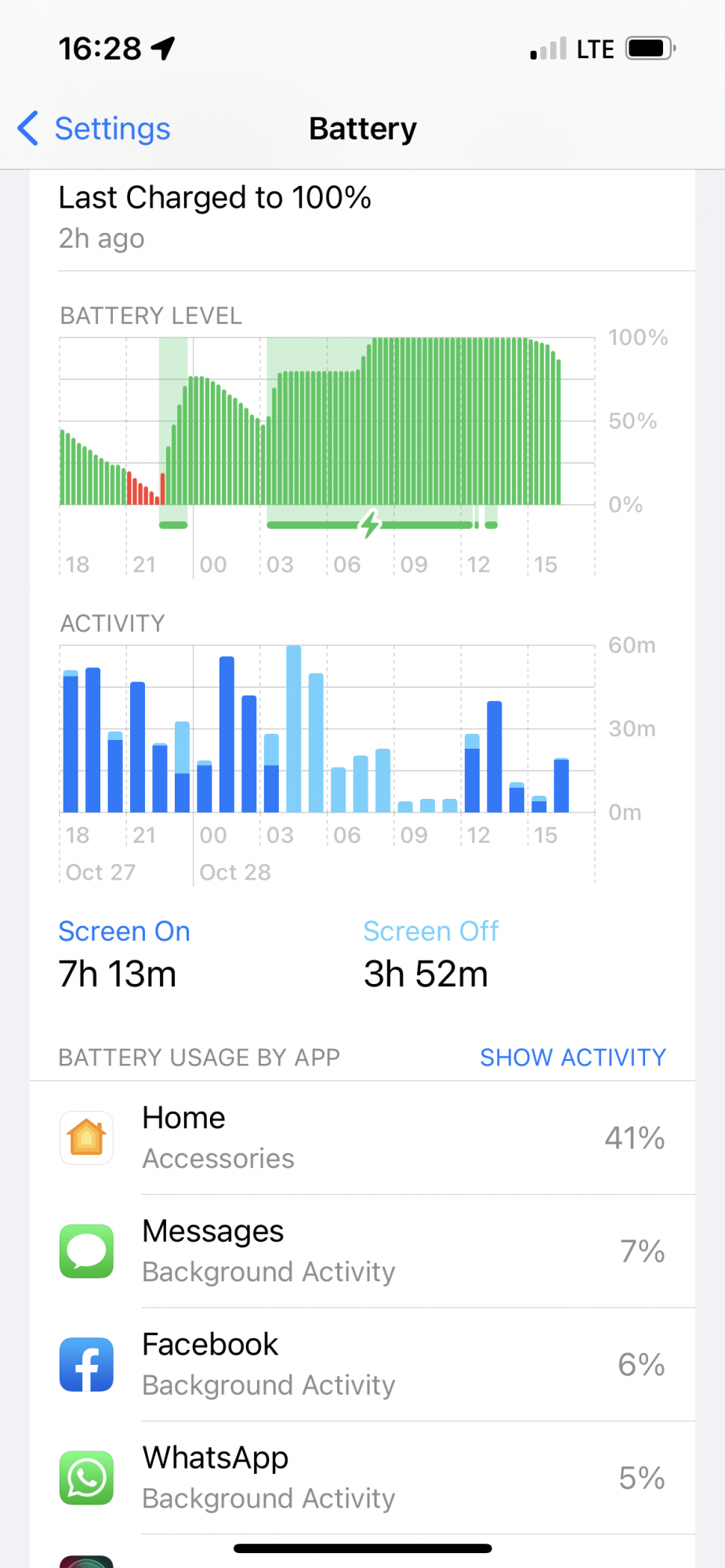

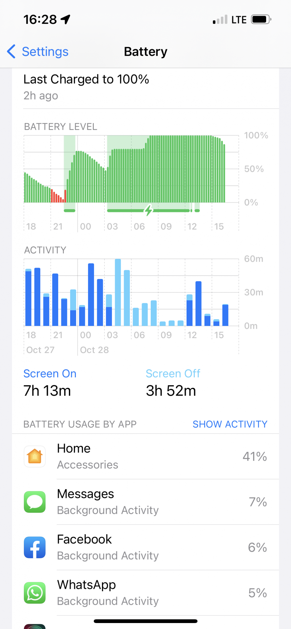

How much background activity are you seeing for Home?
It was anywhere from 14-25%. Since you asked, I decided to check especially since I updated to to 15.1 yesterday. Was hoping for it to be fixed. Well, silly me for thinking that lol…
