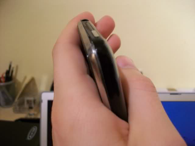

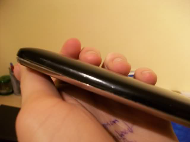

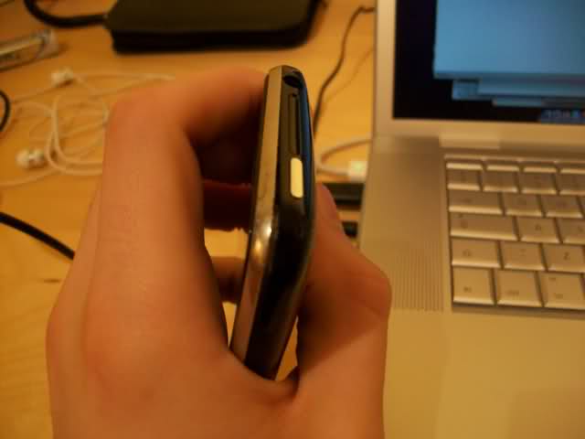

I have yet another problem with my iPhone 3G. The bezel and case are coming apart. 😱
This is only happening in the top right corner, by the lock button. It is about 2mm the gap and means you can have a glimpse of the innards. The gap then closes up slowly running down the same side.
This is also causing the vibrate not to function correctly. When holding the case together it functions normally *touch wood*.
Any ideas on how to keep the case together permanently, or should I take it apart and see if anythings forcing it apart.
I'll try and get a pic up sometime to show how it's parting.

Could somebody just check the pictures and say whether or not they think it would.
