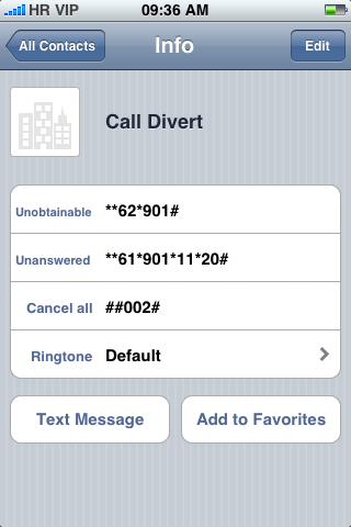

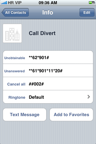

O2 have a range of codes you can use to configure call divert. What I did was to create a new contact called 'Call Divert' and then add each of these codes as a different number with its own label, e.g. Unanswered, Unobtainable, etc. Then it's simply a matter of 'calling' the appropriate divert option. The attached screen shot shows how it looks. I've opted to divert to voicemail, i.e. 901, and in 'Unanswered', the number 20 between the * and the # is the delay in seconds before it goes to voice mail. You can set that to whatever value you wish.
EDIT: This is the link to the full listing of the divert codes on the O2 website http://service.o2.co.uk/IQ/srvs/cgi...ion,question=ref(user):str(Mobile),CASE=13448
