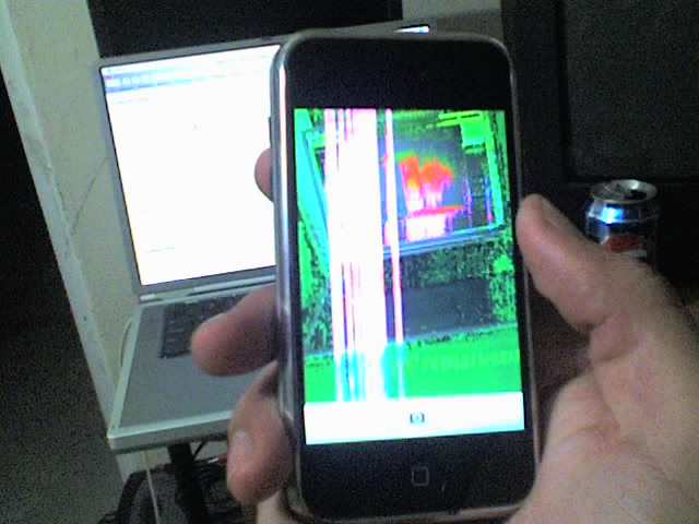

Check out what happened to my iphone camera. It was working just fine, yesterday and when i took it out today it was like that. It changes colors from clear to dark purple and green, and sometimes blue. I didnt drop the phone or anything. Just wondering if anything like this has happened to anybody here? or something similar that can help me out. Is there like a way to reset the camera settings or something like that, that could help me? Thanks.

Wow, that's crazy.
Have you tried resetting the phone by holding the HOME and power buttons until the Apple logo shows up (i.e. don't let go when you see the "Slide to Power Off" option).
I would restart the machine, and if that doesnt work, bring it to apple and they should replace it for yee. thats awesome man, but really not at all and quite unfortunate.
Wow, that's crazy.
thanks for the help but it didnt work, i held the home and shutoff button like u said till the apple logo came on, but its still showing the strange color camera! U really think Apple is gonna replace it free of charge orrr......
I would make an appointment with the Apple Genius Bar and have them exchange it for you if you're near an Apple retail store otherwise i'd call the Apple number and explain your issue.
If you take a picture and transfer it to a computer, do the images show up like that? It would be interesting to see if the problem was in the camera or the iPhone's display of the camera image.

Couple possibilities immediately come to mind:
1. The imaging drivers are corrupted. A full restore might solve this problem, or whatever has to be done in order to remove and replace the imaging drivers associated with the camera. I've seen this happen in scanners also where the driver goes corrupt and you get weird colors like that until you replace the drivers.
2. The camera sensor is damaged. Scanners will sometimes have damage to their scanning element which will result in permanent optical aberration like this. I think it's interesting that the pattern is in lines because that, coupled with the slow exposure timing for the iPhone camera suggests that the CCD captures an image a line at a time (albeit faster than a flatbed scanner). I've heard of such imaging devices and it's entirely possible the imaging device itself is damaged.
The physical damage might arise from putting too much pressure on the image element... like if you sat on it and didn't realize it. If you keep it in your pocket be sure it doesnt slip behind your leg when seated, or keep it in a hard case that prevents direct pressure to the phone.
I'd first try a full reinstall of the system software, etc. on the phone... I can't remember if restore does this or if you have to select the option to not use a saved image and then reactivate the phone and reconfigure all your settings...
Then if that doesn't work, take it in to the Apple Store.
Something simmilar happened to me...my camera suddenly started making everything seem like a cartoon (for lack of a better description). The colors were very saturated and just odd looking...like the posterize filter in Photoshop. Hard resets and a full restore did nothing so Apple replaced it without a fuss. Judging by the tech's reaction it was a very rare issue so I guess we are the luck ones.
Glad to say that I sent my Iphone to APPLE and they sent a new one for free! It had a few scratches and Bumps haa but it didnt matter! Thanks for helping!
Congratulations! Let this be an example to others having camera issues in these threads. I bet it's easier to just issue a new phone rather than tear it apart and diagnose it. Fixing these phones seems pointless due to how labor intesive it would be. If you send in a phone...you get a new one back. I haven't heard of anyone sending a phone in and getting their original back but "fixed".

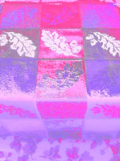

Iphone Camera gone CRAZY!
Mine, too. (Andy Warhol is rolling over in his grave.)
I am viewing this as an excuse to get a new iPhone. I'd really like to keep the "broken" one as a fun-whacky-photos-only camera. I hope that is an option.
I called AT&T, and one of the phone menu options was to be redirected to Apple Support. Apple phone-support fixed the problem. You probably don't need to go to Apple via AT&T like I did. In fact, try this and be done with it:
From the home screen on your iPhone find and click Settings>>General>>Reset (last option at bottom of screen) >>Reset Network Settings (middle of page)>>(pop up🙂 Reset Network Settings (in red) OR cancel.
This restarts your phone, it does not erase your data. After that my photos went from white, pink and purple only to regular colors. Hope it works for you.
