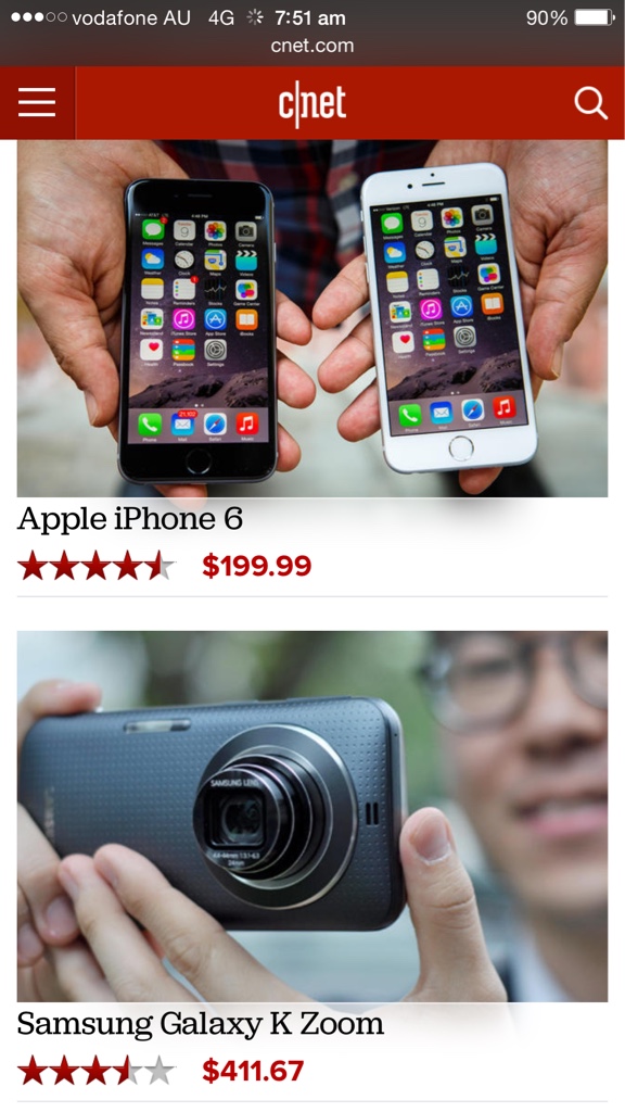

3264x2448 sensor with 1.5µ pixels is 4.9x3.7mm, which should easily fit inside at 90-degree angle. The only reason the electronics is built around the chip (making the assembly much wider) is the thickness constraint. With 90-degree scheme this constraint is gone.

Because there's no reason the electronics are around the chip, right?
