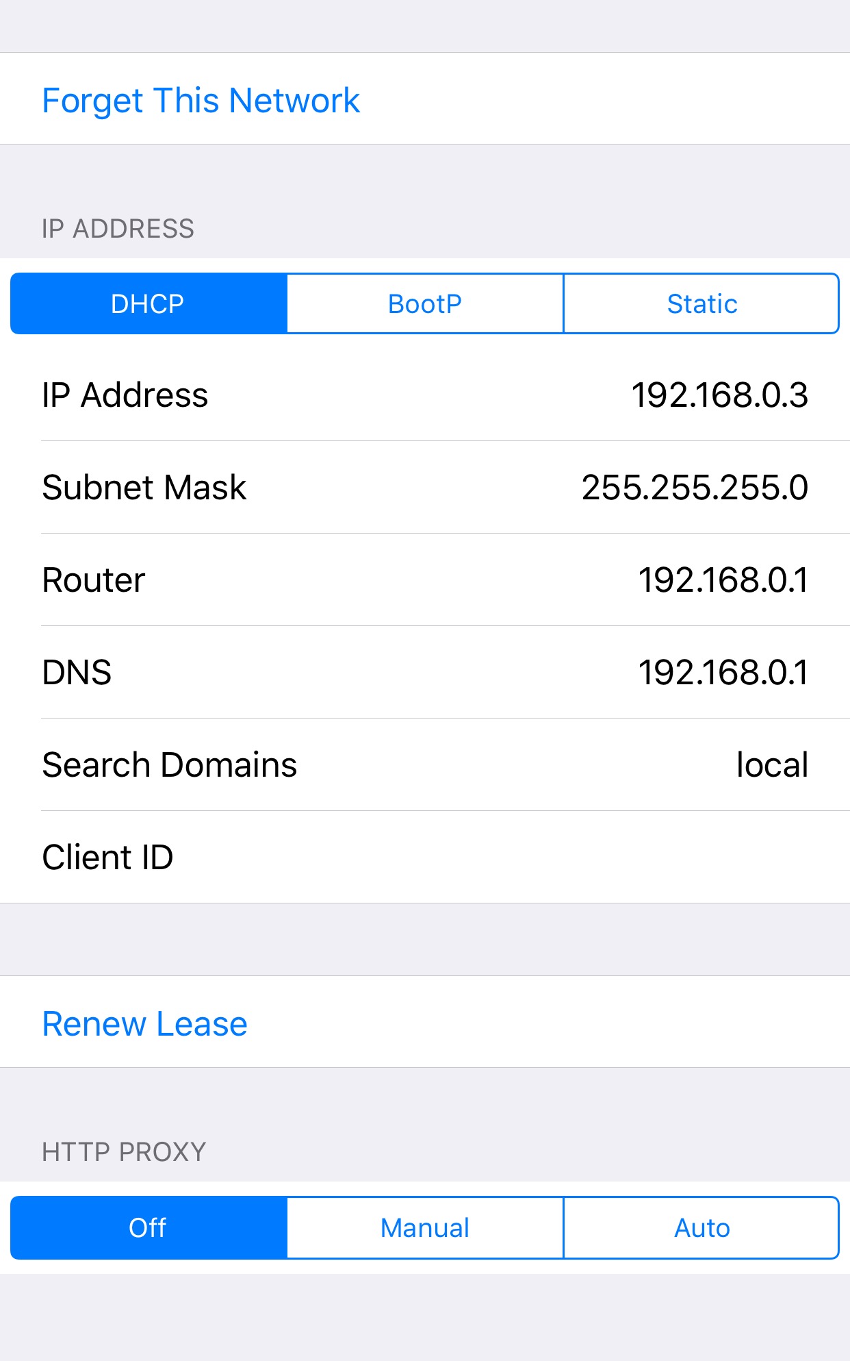

Op can you take a screenshot of your wifi settings page when your connected but not getting Internet. Settings >wifi tap the i next to the connection.

Thank you for the replies. I don't have any MAC address filter, though that was a good suggestion. The router has been completely unplugged (for a long time) multiple times. I took a screenshot of the settings, hopefully that helps.
I don't think changing that is going to help your problem. Believe its more relevant when you are connected to your company intranet.
