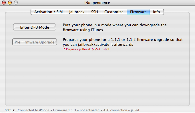

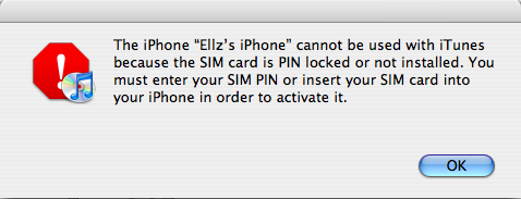

I decided to connect the phone to see if "iNdependence" could do something about it: This is what happened:
iTunes opened up and I got this message
Than I checked iNdependence and noticed this: notice the status at the bottom.
all of this and my iphone still won't turn on/work.

!@#$%^& I just realized that I installed the ipod firmware 1.1.4 onto my iphone. Gosh. How could I be so... O.k. So now the question is, how to I uninstall this ipod firmware and get the iphone firmware back on it.
Idiot! :(
Problem fixed.
From spinstorm:
I PWNED MY IPHONE/IPOD WITH THE WRONG FIRMWARE! ITUNES SAYS MY IPHONE IS AN IPOD (or vice versa) WHAT CAN I DO?
MY PHONE WON'T TURN ON! ITS REBOOTING CONSTANTLY! I HAVE CONSTANTLY SCROLLING TEXT! and ANY OTHER ISSUE WHERE PHONE IS NON RESPONSIVE
You can fix this!
Put your phone into DFU mode. You can do this by pressing and holding the sleep and home button for 10 seconds WHILST THE USB CABLE IS CONNECTED AND ITUNES RUNNING from when the Apple logo appears until it dissapears and then KEEP holding the home button but let go of the sleep button - the screen will stay off but iTunes will recognise the phone.
If you have trouble getting DFU mode use Independence/ iLiberty+ to put your phone into DFU mode!
If your phone is not recognised by Independence/ iLiberty+ you will have to manually put it in DFU - this CAN be tricky to time right but eventually you WILL get it!
Restore to apple original firmware and you can start over again!
