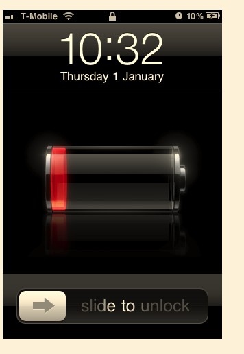

I gave my wife my iphone to look after then Somehow she managed to drop my iphone down the toilet (fortunately it was flushed) I dismantled and dryed with isopropyl and silica gel . Left for a few days , then today I plugged into puter , nothing happened , then after about 10 minutes it connected to itunes and came up with correct info - but lcd display is light up but white with marble effect !. I did a sync/diagnostic test which came back good . Then rang the phone , it rang ok - I guessed where the answer slide was and answered it and it worked fine , then texted phone - that arrived ok , but could not see it . I did a shot of the screen and retrieved it ok ( time and date are wrong ) Has this happened to any one else and will the display be back ok with a new Lcd ?

sorry for misunderstanding - The actual screen itself - just shows bright white blobby effect only - the shot was just to show the phone internals where working - am I correct in thinking that the shot I have attached is what the screen would be displaying if it was working ok ? hence new screen is the way to go ?
