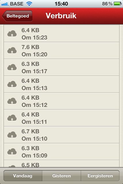

Now, approximately a month later, all of a sudden, the problem is back again! Started from the moment I synced my iPhone through Wifi with my iMac (used the 'Synchronize'-button in iTunes). Searching for the cause, I noticed (thanks to a data-monitoring app from my carrier) my iPhone continuously connects to their cellular networks. Every 1 to 5 minutes it connects and consumes +/- 7 KBs of data (can be 25KB tops when the last connection was a little longer ago). Ok so I found out why the battery was being drained, now I just need to solve this problem.
Then I found something about the Wifi Sync which could drain data for searching the computer again. I thought: "That's it!" since it started from the moment I synced again by Wifi. BUT... turning Wifi sync off didn't solved it! What's even more bizarre: My iPhone is connected to a Wifi-network, but drains data using the cellular network! Why does it uses Edge when it can use the Wifi-network? And more importantly: WHAT is it doing anyway??
