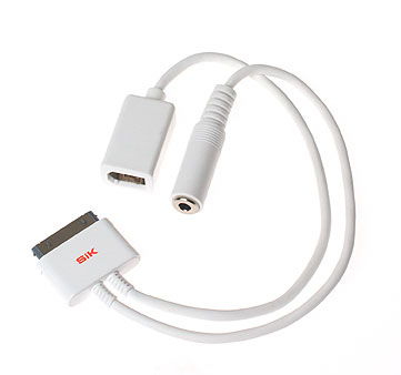

and what about something like this?
but instead of firewire have something else for charging purposes, and use that female jack for audio in....?
Yes, but, as you said, it needs to charge on the USB pins of the Dock connector. And they make them with a cigarette lighter plug already on them. Again, though, you have to know it will work with the 3G.
(The signal goes OUT from the phone, then IN to the amp.)

here i go
This is what i need. Id chop off the lighter plug and wire it directly to a 12v source.
run line out (males) to a male mic connector (which will connect to the SIK cable female mic port)
done?? what you guys think?
done?? what you guys think?]
It will not work if the cable has a FireWire connector on it.
FireWire not only charges at a different voltage (12v), it uses different pins on the Dock connector than the USB connection does.
:apple::apple:
:apple::apple:
it says its for every ipod/iphone (including 3g) so i dono what u mean by it uses different pins
**sigh**
There are 30 pins on the dock connector at the bottom of your iPod or iPhone. Wikipedia has an entry for it: Dock Connector. The FireWire connection - which is what the device you show in the photo has - uses pins 19 & 20 for the +12volts, and 29 & 30 for the ground side. Plus others for the actual signal.
The USB connection uses pin 23 for the 5 volt power, and pin 16 for the power ground.
If you are connecting to the FireWire pins, they are not the same pins on the dock connector as the USB connection uses.
The iPhone will only charge if power is applied to pins 23 & 16 at 5 volts, which is done when it is docked using USB.

Found the company's website:
SiK
All of their products claim FireWire charging, which is NOT compatible with the iPhone.
Hopefully they'll update/upgrade, as this seems to be a good product.
MacSales doesn't even show that device on the iPhone page (unless you get a different iPhone page than I do...).
