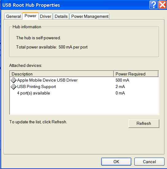

You can get some idea of the power outputs of your PCs USB ports are by going into device manager and right clicking on "USB root hub" and then selecting "power". Mine says that it should provide 500ma per port and that the iphone draws 500ma. Sharing the iphone on a hub with another device is probably best avoided.
Yup, HP is evil. Problem resolved (fingers crossed).

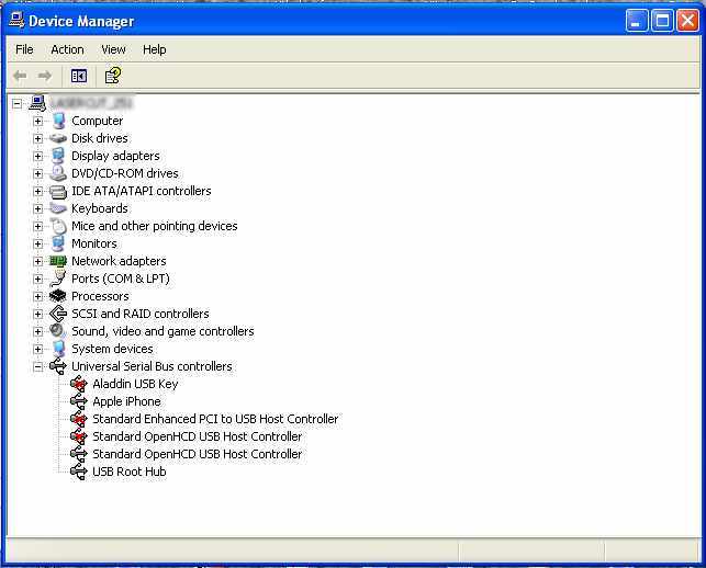

hi guys,
me2 had the same problem, after doing countless hrs of research i cameup with this solution(Pc users only)
Disable all the USB devices except Apple device
Try this
good Luck:)
-biju
