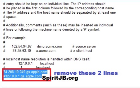

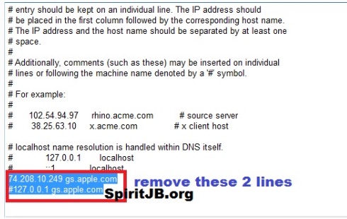

What happens when you type gs.apple.com in your browser? Do you go to apple's site or cydia?
Edit: I'm almost positive it'll take you to the cydia page. In checking that box didn't work because in your earlier post you said you got an error when using TU; that the hosts file was not writeable.
Anyways, you may or may not be able to manually edit the hosts file depending on what version of windowsill are using and how you are logging in to it. This is why AppleJuiced suggested using a different computer to restore.
If your browser takes you to cydia, then your hosts file needs to be fixed. Here's a screenshot of what it may look like.
It takes me to a page called "GCS Default server" it has three boxes with options of Apple, Apache web server and Tech Probs. My hosts does not have those two lines, im reinstalling itunes right now.
i still get error 21 after reinstall of itunes. I would like to note i have two files named hosts in the etc folder. One is hosts.bak and the other is hosts.umbrella. i have kept tinyumbrella because that is the only way i can get out of recovery mode after i get error 21.
Remove the tiny umbrella host file and rename Host.bak to Host.
Then try to restore.
If that doesn't work you can delete the host file, then connect to a network and a new host file will populate.
