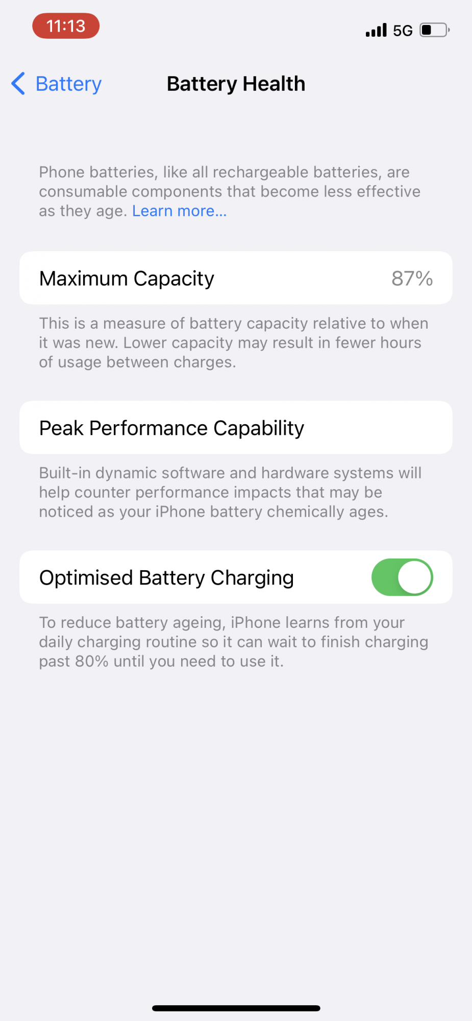

This is my battery health so far and my iPhone 12 Pro is about 14 months old.
