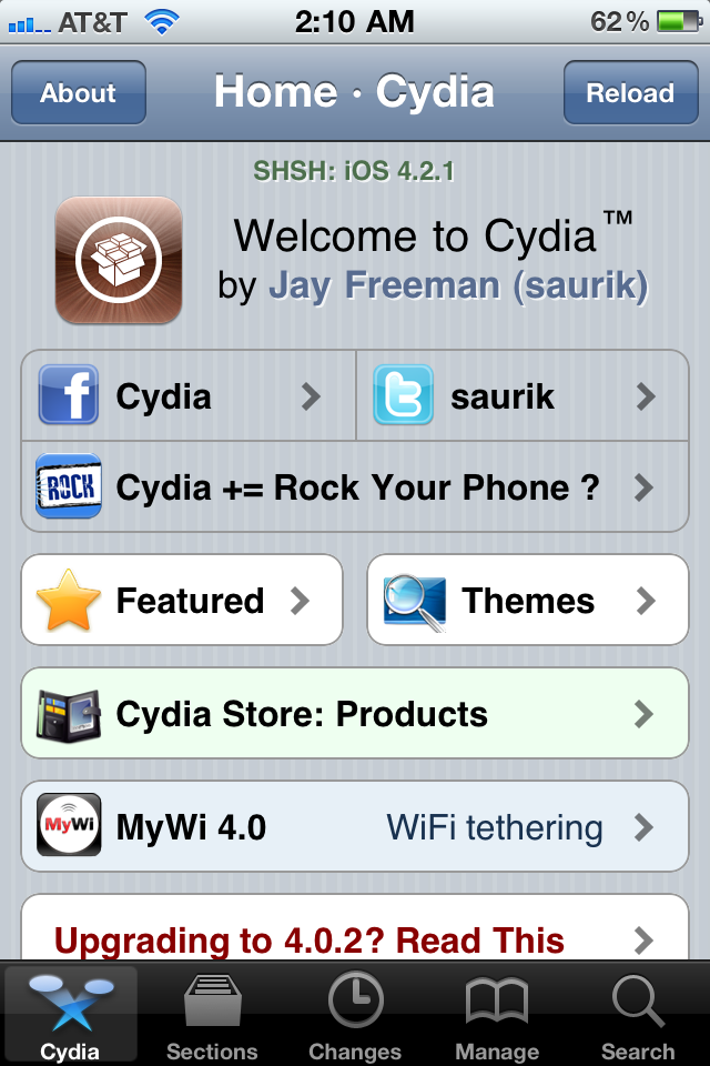

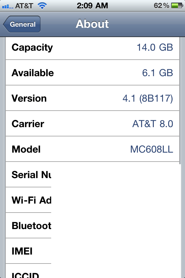

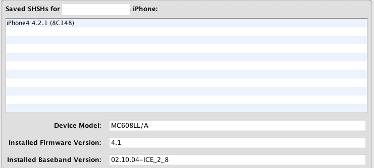

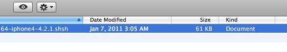

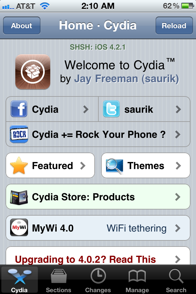

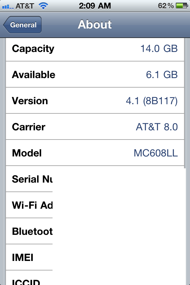

Hello, first time poster, first time jailbreaker on my iPhone4. I used LimeRa1n, all seems to work properly. I used Tiny Umbrella to back up the blobs. Here's what I don't understand. I'm on firmware 4.1, but Tiny saved blobs with the name 4.2. Screenshots from the Finder, Cydia, and my Setting panel on the iPhone, as well as a screenshot from Tiny.

That's because you can no longer save blobs from 4.1, only 4.2.1. Tiny says you've saved 4.2 because the only one available to save right now.
^ Yup. As I found out recently, doesn't matter what firmware your currently on. The only SHSH's you can save are the ones that are currently available to you at the time.
Has nothing to do with your current software version. You can no longer get an SHSH for 4.1 because Apple is no longer signing for that version.

You will be saving the Blobs that Apple is currently saving no matter what firmware your phone is running, you cannot longer save the SHSH for 4.1 (even when you are running it on your phone) since Apple is no longer signing those, All Apple is signing right now is 4.2.1 (and that's what you got)

It actually doesn't matter what firmware your device is running, Tiny can only save firmware Apple is currently signing.

The blobs are retrieved from Apple's servers and it has nothing to do with what firmware your device is currently running.

the blobs that get saved are not based on the fw running on the iPhone, but the fw that apple is currently running on their servers when you start saving them, in your case the only one that was running was 4.2, so you can't go down to 4.1 anymore.
