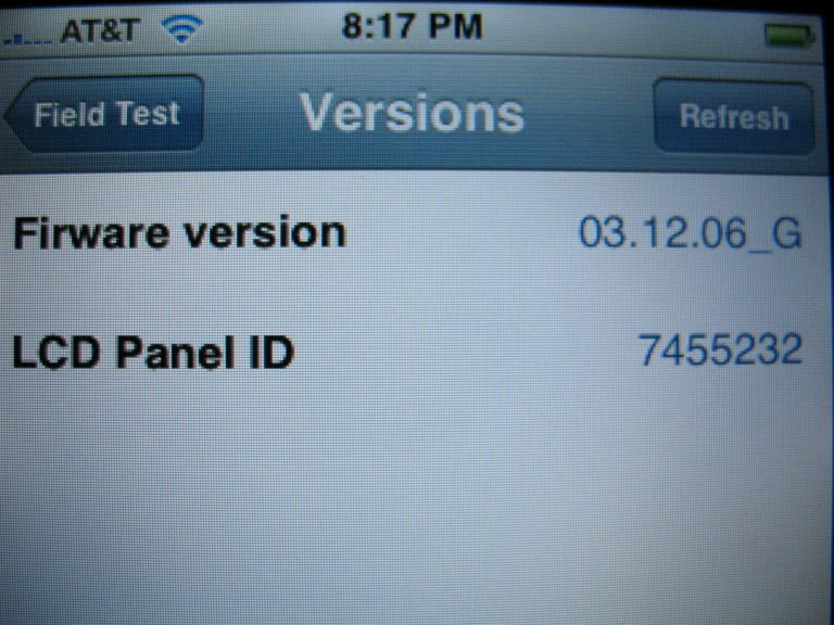

@The General:
Did you reference the LCD serial number and/or was your AppleCare representative aware of the white dot / brightness problem already?

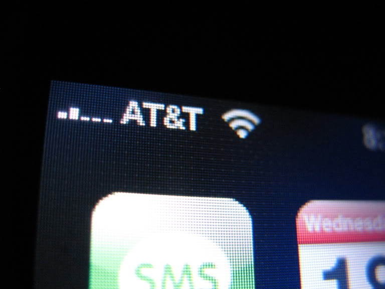

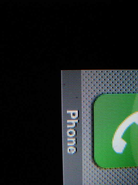

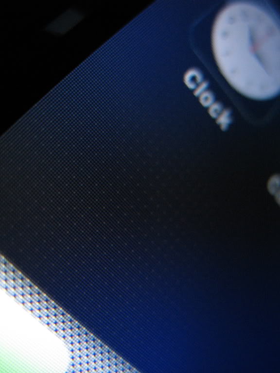

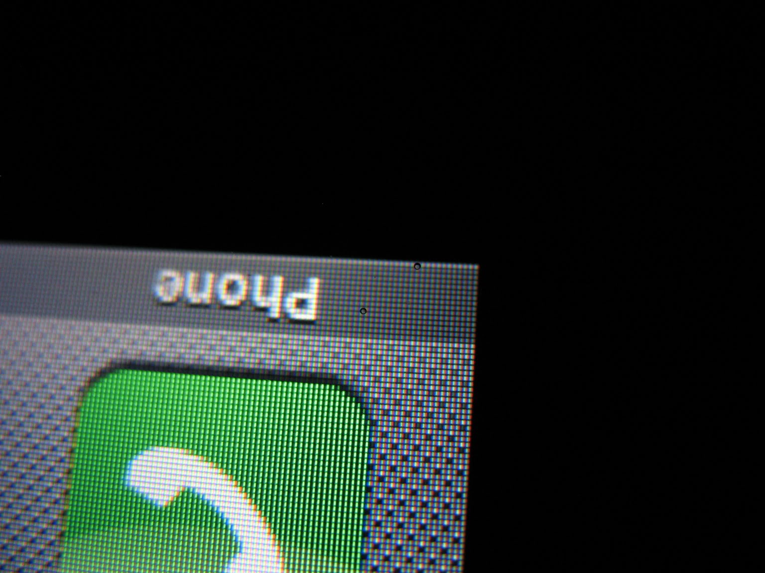

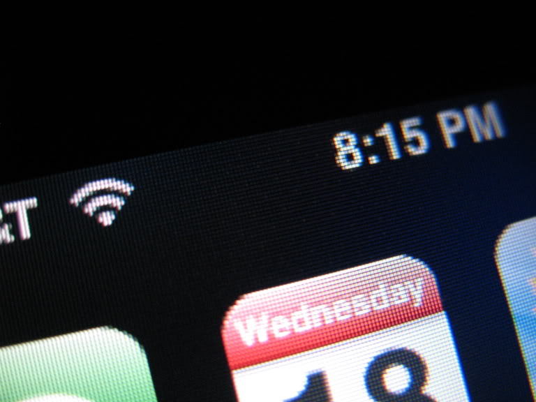

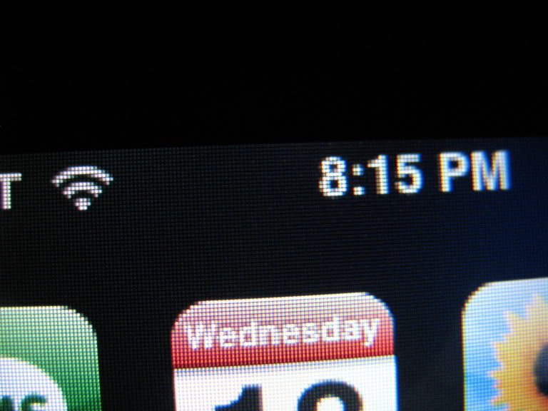

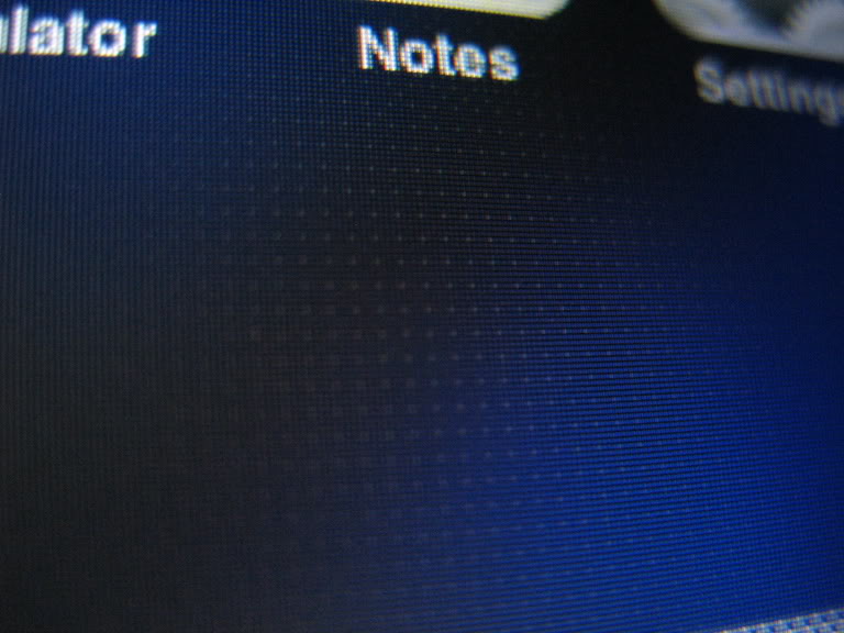

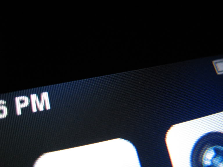

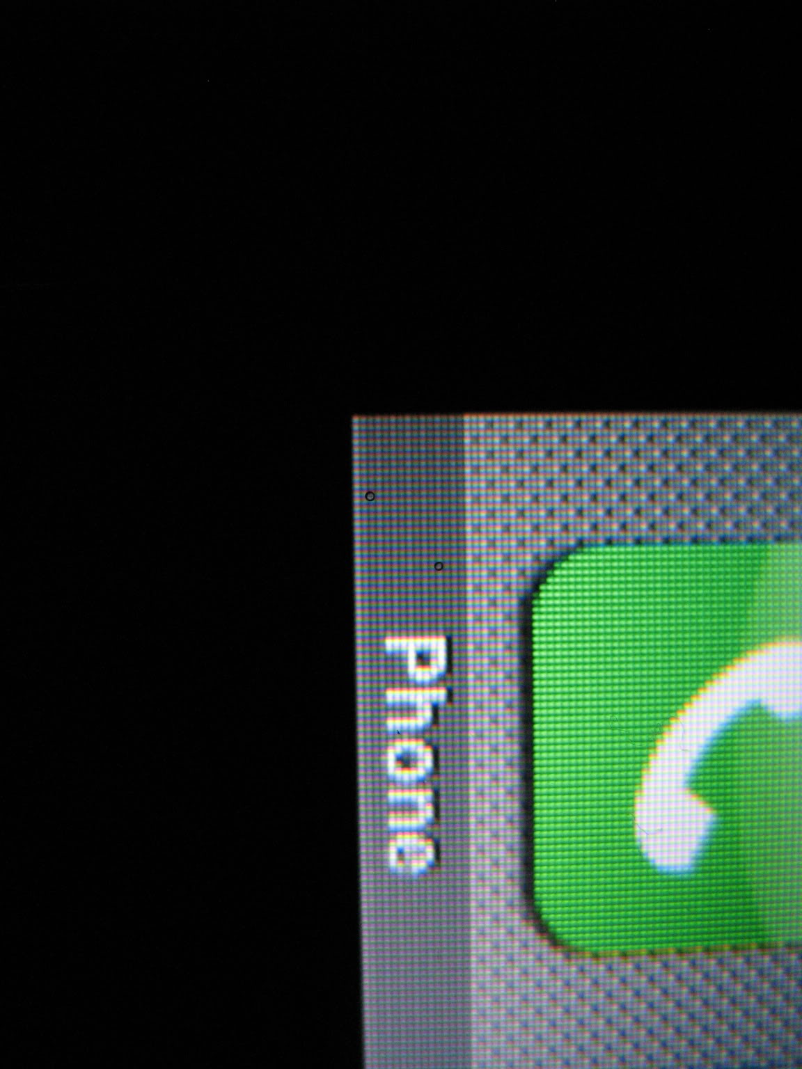

Okay so I figured that before I ship my iPhone off to get repaired/replaced, I should take full photographic evidence of everything. The first thing I noticed was that when I dial *3001#12345#* to get the Field Test, there's a typo ... 🙂 It says Firware, shouldn't it say Firmware? 😛
I took a video of the dots and how they show up half way through boot.
http://www.youtube.com/watch?v=M_4m04WE7n8
If you want the full quality video, download it here:
http://www.mydatabus.com/public/wolfet/MVI_0001.mp4
Here are the bubbles in the glass, and the dots. Click for bigger photos:

The following is my final opinion on the topic of dots on the iPhone LCD. I've come to this conclusion through careful side be side inspection of both versions of iPhone LCD.
What are the dots? Is it the touch screen?
I strongly believe them to be pixels, slightly lighter then the other pixels displaying black. They are in the same position as pixels, that is, they don't fall between pixels, but instead take the place of the pixel being covered.
The dots also react to the pixels on the screen.
When the screen is displaying black you see this pattern in fig. a:
The dots become more filled in when there is a graphic on the screen. Everything down and at a 45deg angle to the right of any displayed pixel on the screen. so if there is a active pixel (that is a pixel that is not black) in the middle (fig, b) the pattern below, and to it's lower right become more dense. If a active pixel is at the top right... the hole screen is filled with the tighter pattern of dots (fig. c). This is why the pattern changes at the top of the home screen (fig. d).
Lastly the dots are not only invisible, but simply not there when the pixel is displaying anything other then black.
It is for those reason i believe them to be pixels, and not a layer of the touch screen.

This was the part i couldn't figure. Till i saw other phones that supposedly do not have the dots. Prevues discovery by other members of this forum and some poll like research. We seem to have found that there are two versions of LCD. A 5755136 and a 7455232. The 5755136 was found generally not to have dots, wile the 7455232 generally does. I say generally because some people have reported not to have, or to have dots on the opposite screens. This i can't really explain explain to say that there seems to be some confession as to what the dots look like. Some people mey be seeing the crossing lines of the touch layer and thinking they are what we describe as dots. All i can say is that all 7455232 that i have looked at had them clearly visible, and all 5755136 i have looked at did not.
So if there pixels why are they not on all screens? Well, they are. There just really hard to see. In-fact i really couldn't see them on the 5755136 LCD's. What i did see was the change in texture when moving graphics around. As described earlier, the pattern changes.
So, why can you see them on 7455232's? well, if you look at them side by side the 7455232 had higher contrast and blacker black. As a result the pixels stand out more. The 5755136 has less contrast and so you don't see them, they blend in more. I Don't know for sure if this means the 7455232 is a superior LCD, but blacker black is usually a good thing. (see fig. e)
