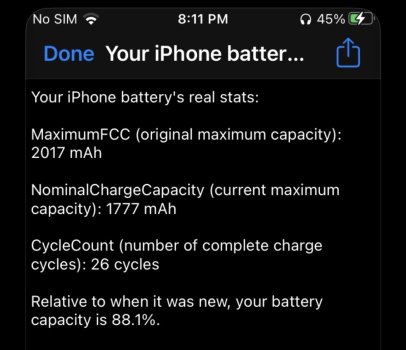

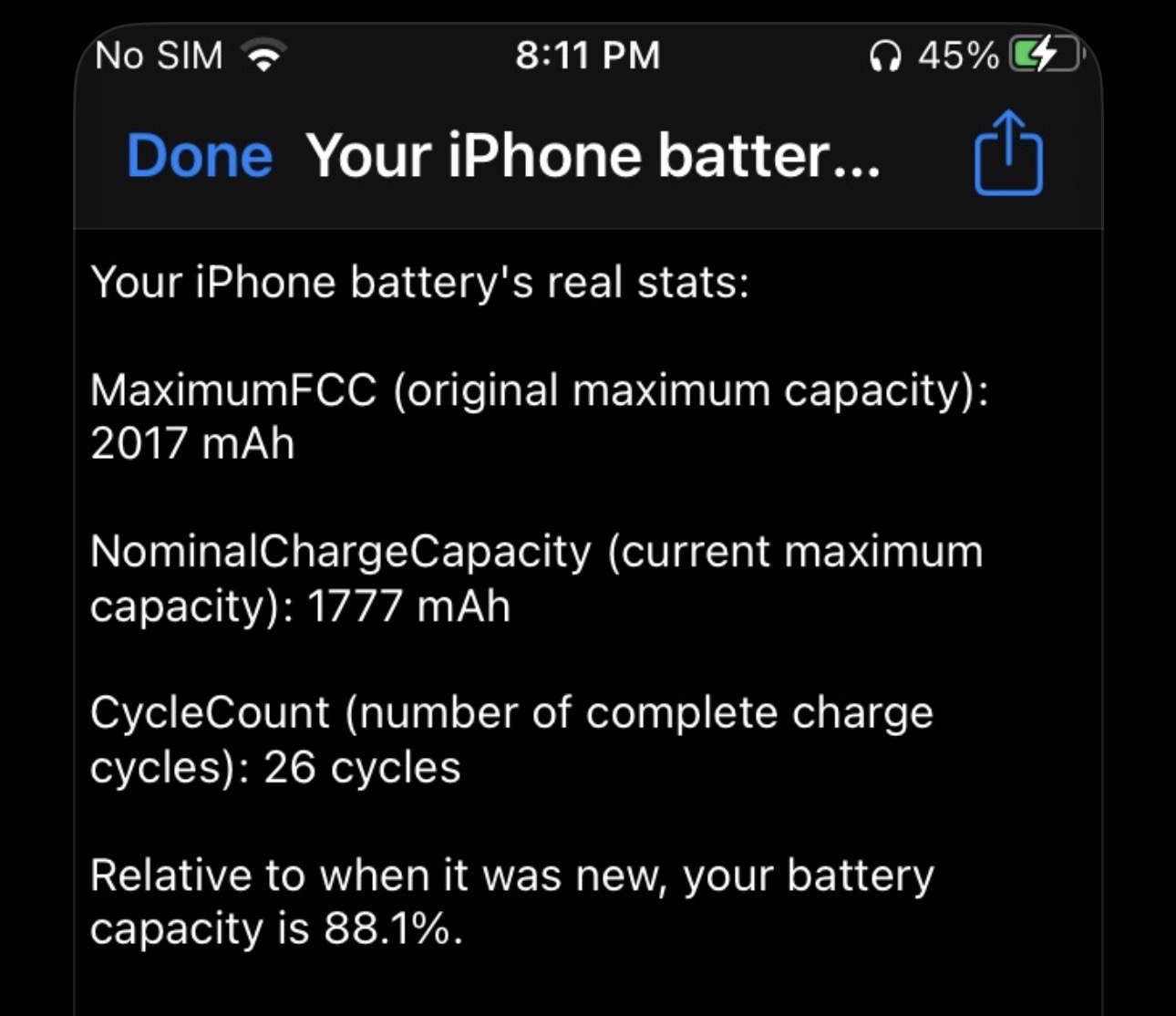

Did a battery replacement from ifixit and it same came with all of the tools. Fairly straightforward replacement as there is no water resistance so you don’t have to worry about warming up the phone to loosen a sticky bond around the frame.
Battery is a larger capacity than a standard se battery. 4-6 hours of sot, doesn’t surprise drain, and runs better than in I don’t know how long.
It sits at a much higher capacity than the standard 1624 mAh battery as measured by apple’s own diagnostics.
