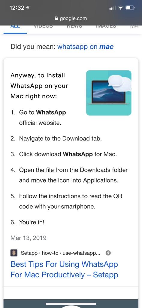

I’m new to iOS myself , last iPhone I had was back when iPhone 4s came out.
Have a look at the attached hopefully it might help you.
