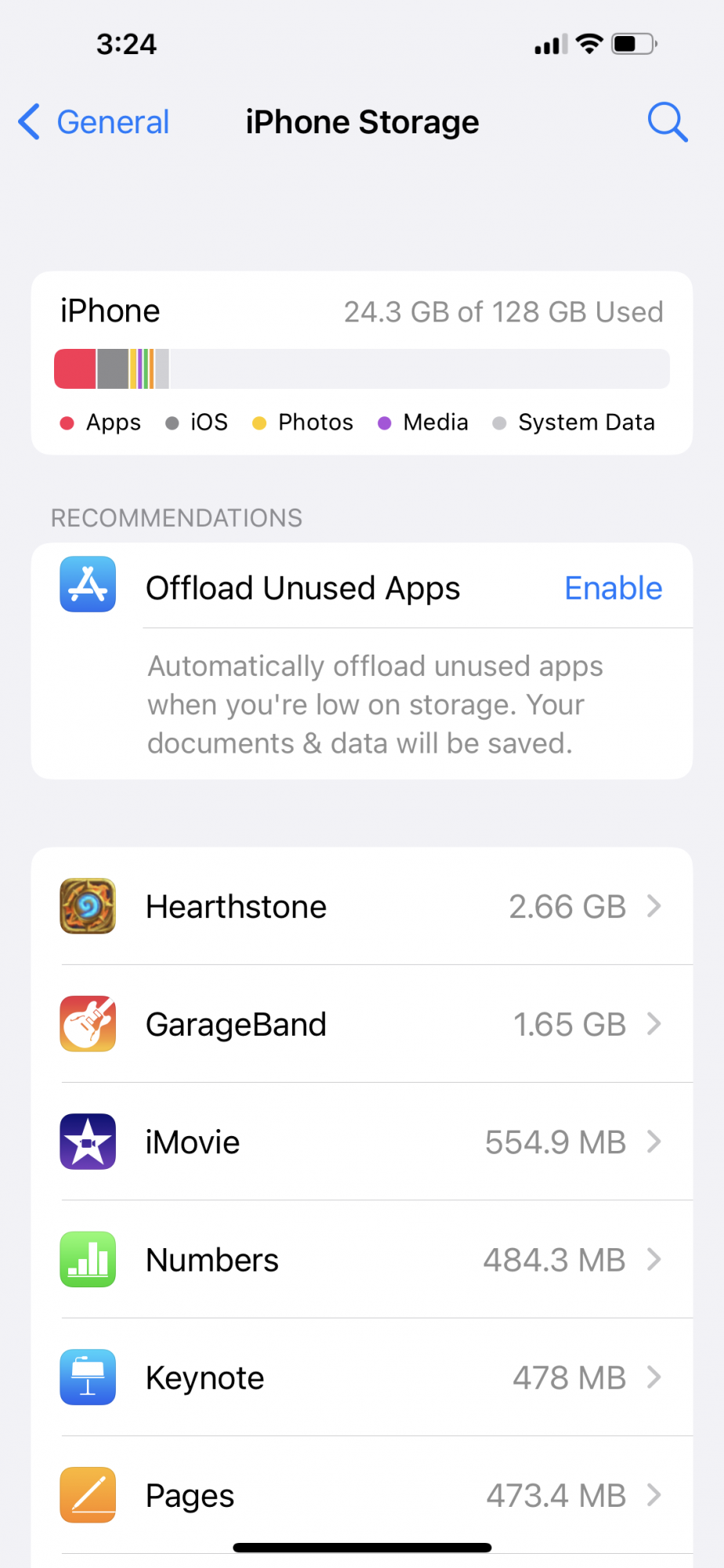

Jesus Christ what do you people do with your phones? I recently upgraded to 13 pro max and this is what my storage looks like - granted I offloaded about 5gbs of photos on to my desktop
Look at my images in the first post. Right now I'm at 252.8 of 256GB used, and 92.05GB of that is "System Data." I need to offload a bunch of pics and videos, but thanks to Apple, almost half of my iPhone's storage is something they can't figure out.
