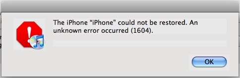

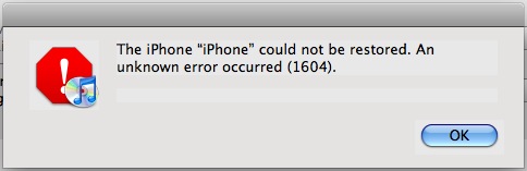

Hey guys, I'm new to the forums, and hate a first post like this but I'm in between a rock and a hard place.
I downloaded the 2.0 firmware this morning before work, started installing, it locked up and I had to force quit, it did not finish and apparently locked my phone into recovery mode.
So now when I try to goto iTunes to restore it to factory settings it gives me the message of "The iphone "iphone" could not be restored. An unknown error occured 1604". I called apple support and they were like you having problems? then its probably because of the server overload. I don't think it has anything to do with the server overload, I'm not trying to install or download 2.0. I just want factory settings, when I click restore it attempts to install 1.1.6 firmware and ends unsuccessfully with the error message of (1604).
I'm at a loss here, I don't know what else to do. I downloaded the iPhone1,1_2.0_5A347_Restore.ipsw 2.0 firmware and option clicked restore in itunes. Again same error message.
I just want this iBrick back to factory settings, its been stuck at the connect to itunes icon on my screen all day. Is there any third party software to get this bad boy running again?
