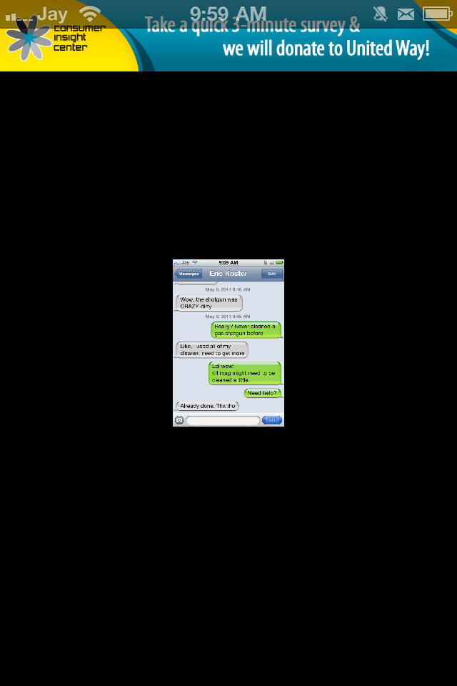

So I just noticed something odd on my iPhone 4. My iphone 4 is jailbroken (as can be seen by the screen shot). Occasionally, when I close an app, open an app, or unlock my phone I will see an ad, and I caught one with a screen cap. The screen crap is from unlocking the phone (which I had locked on the messaging ap). You can clearly see an ad at the top of the screen as the messaging app (the stock messaging app) is coming up.
Has anyone got this? I'm a little worried I might have some sort of spyware on my phone or something. I'm thinking about resetting the phone and putting it on stock firmware.
Suggestions? Anyone else had this issue?

That looks wierd
I've seen something similar caused by a jailbroken app...the app that allows you to set a scrolling wallpaper so each homescreen has a different one...it causes apps to run at 1/4 the size and in the top right corner.
perhaps you have something similar installed?
Not sure if this will help... But do you have backgrounder installed? When I have Words With Friends opened (and backgrounded) it displays an iAd on my homescreen. It's probably an issue with iAds and backgrounder (at least for me.)
No I don't have backgrounder installed..but I do have lockinfo, notified pro and notification grip. It does look like an iAd...definitely very odd.
I have bought some jailbroken apps but I've been thinking about going back to stock...but I just dunno. lol
It's the JB. Mine did the same thing when I applied greenpois0n. Removing the JB fixed the issue.
FYI - I experienced the issue with only the base JB installed. No other apps were installed from Cydia or the App Store. You could try JB's from other groups to see if the issue persists.

If you want to continue to use the phone JB I recomend you first restore it to factory state, JB again, and then install your JB apps one by one untill you find which one is causing the problem.
