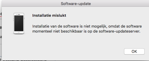

My iPhone 6s + is suddenly no longer recognized by iTunes.
I think the problem came after an update from the iOS to 12.1
I work with an older iMac with OSX 10.11.6 and iTunes version 12.8.0.150
I have never had problems with the recognition of the phone by iTunes until now.
Sometimes I get the message that I have to do a software update but it does not work.
I get the message that the software is not available on the server.
Now I get the following message:
"iTunes can not read the content of the iPhone" iPhone from Kristof. "Go to the" Overview "tab in the iPhone preferences and click on" Restore "to restore the factory settings of the iPhone."
This does not work because after closing the message, the button of the iPhone next to the button "music" disappears.
I have also reinstalled iTunes but this does not help.
What else can I try?

I can only respond to my case scenario which was on 10.13.6 (not sure the version your using is new enough to work with iOS12). iTunes needs a supplemental download to work with iOS12 unless your on Mojave. A popup came up when I first plugged in my iPhone to iTunes after updating to iOS12 that installed the necessary software, then everything worked correctly.. You can check the Apple support page for the required download or you can search on this site as I know there are several threads on the issue your describing..
Like i mentioned :
