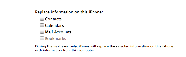

    My sync just took 9 minutes with no music or data exchange. While it is shorter than your syncs, it is far longer than usual.
    Then I tried replacing the data on my phone with a fresh copy from the computer (see pic):
    That has solved problems for me in the past. No luck here; its still taking forever!! Did I screw my phone up somehow? I can't wait this long for every sync!
