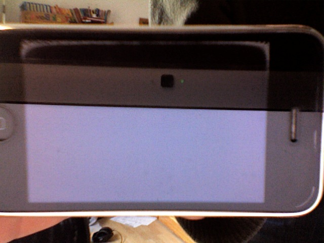

    Thank you everyone for your advice - very very helpful, and I am reassured by the stories of success! I will not bother washing it through, but do the rice/proper dessicant method instead.
    This is the only visible problem at the moment - you see the white marks in the corners of the screen? I presume that's water or condensation or something? Hopefully this method will help remove that.

    Just done exactly this. Interestingly, taking it out of the airing cupboard, the water marks I showed a picture of above have all but gone in the last few hours.
    If I can find a suitable dessicate I will replace the rice tomorrow, and I'll try and leave it for 3 days - that should give it every chance to dry out. Then to test, I guess just plug it into the Mac and cross my fingers!
