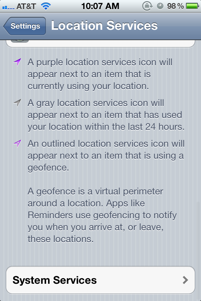

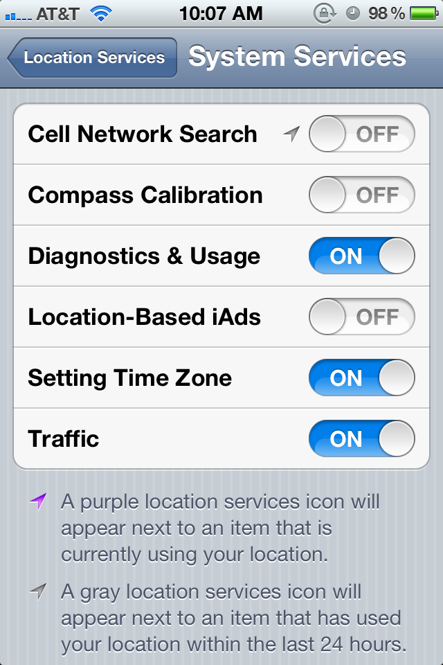

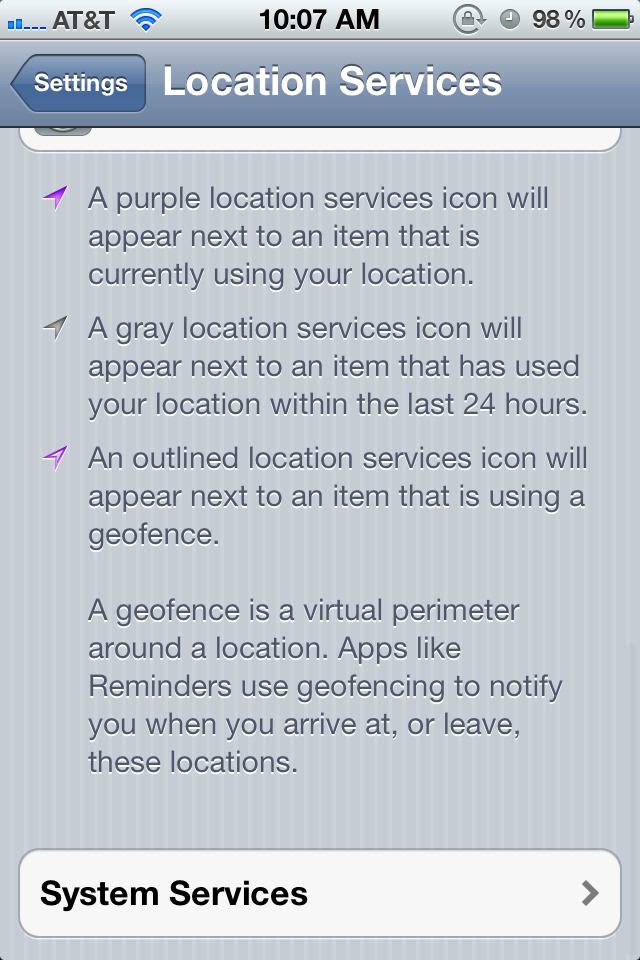

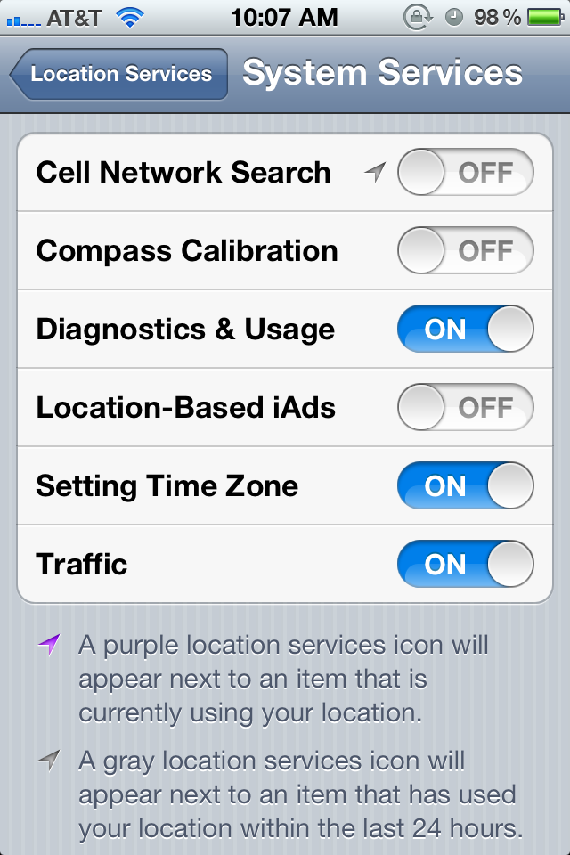

Here is a suggestion. Turn off cell network search and see what you get. It is in location services. See pictures below.
Not claiming remedy as my iphone 4s is not jailbroken, but this little test made my iphone network experience go from junk to working like the first day I got it.
