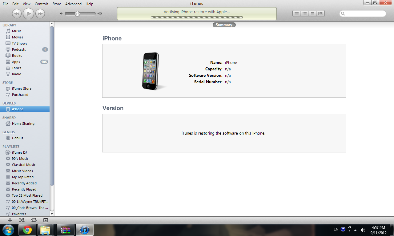

24 hours ago I noticed my semi-tethered 5.0.1 jailbroken iPhone had no cellphone coverage, so i rebooted it, but it never turned on, like the system gave up or something,when I try turning it on I get the apple logo and then the "plug into iTunes" page, hence it immediately jumps to recovery mode! and to top that off when i remove the cable from the iPhone it just dies, so I thought it was battery issues so i changed it for a whopping 50$ but still it doesn't turn on without the cable and immediately jumps to recovery mode so i tried restoring by doing the following:
-I press power and hold button for 10 seconds then remove the power button and get into DFU mode(to avoid error 21), after that i click restore on my iTunes and the process starts, weirdly it "verifies with apple" twice and upon the second verification my iPhone somehow reboots or something and looses its DFU mode and BAM back to square one "plug into itunes" and error 21

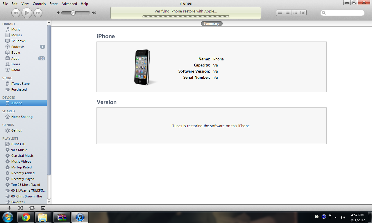

-I just tried shift+restore and chose the ipsw located in the C:\Users\abdulz\AppData\Roaming\Apple Computer\iTunes\iPhone Software Updates and now im stuck on "verifying with apple" for 10 mins ... voila Error 1602
-I just download this file http://www.4shared.com/file/CEz96j-s/hosts.html which is supposed to renew my host file but still stuck at error 1602
-I just downloaded Tiny Umbrella and removed the request SHSH from cydia and and still at error 1602

At the time, the farthest I can get in the restore process is this before getting error 1602
