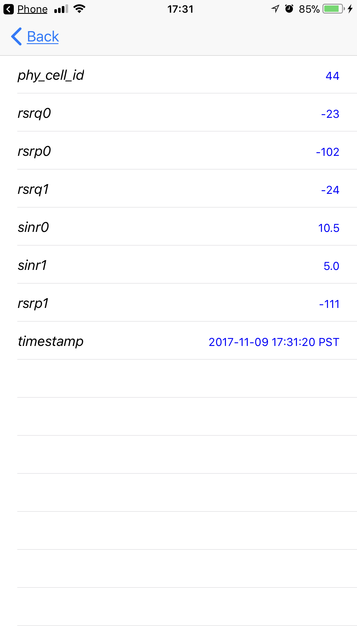

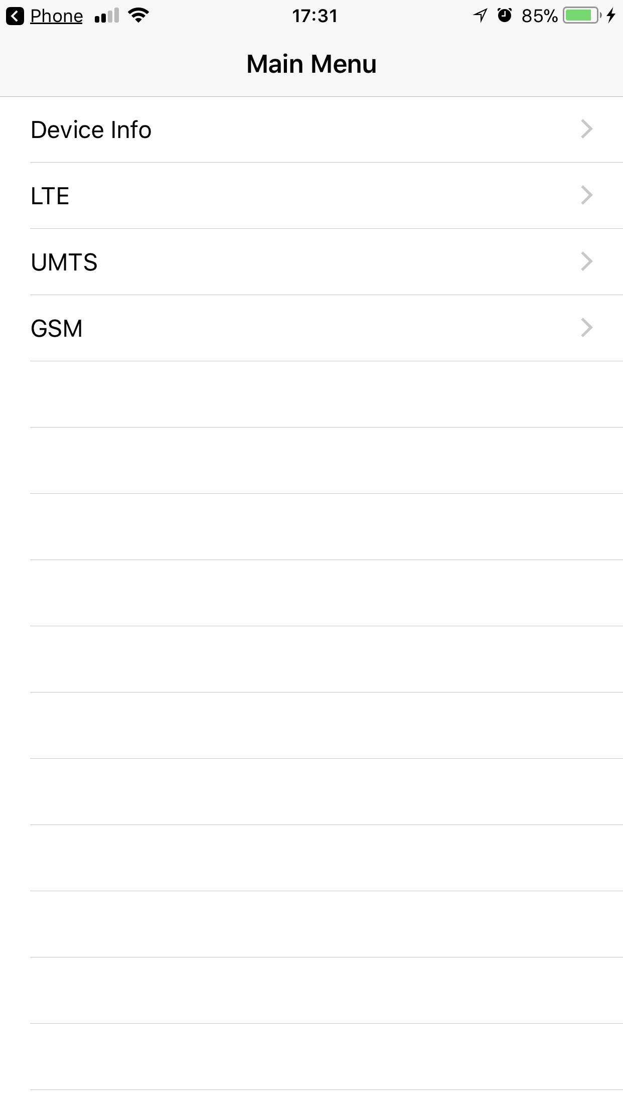

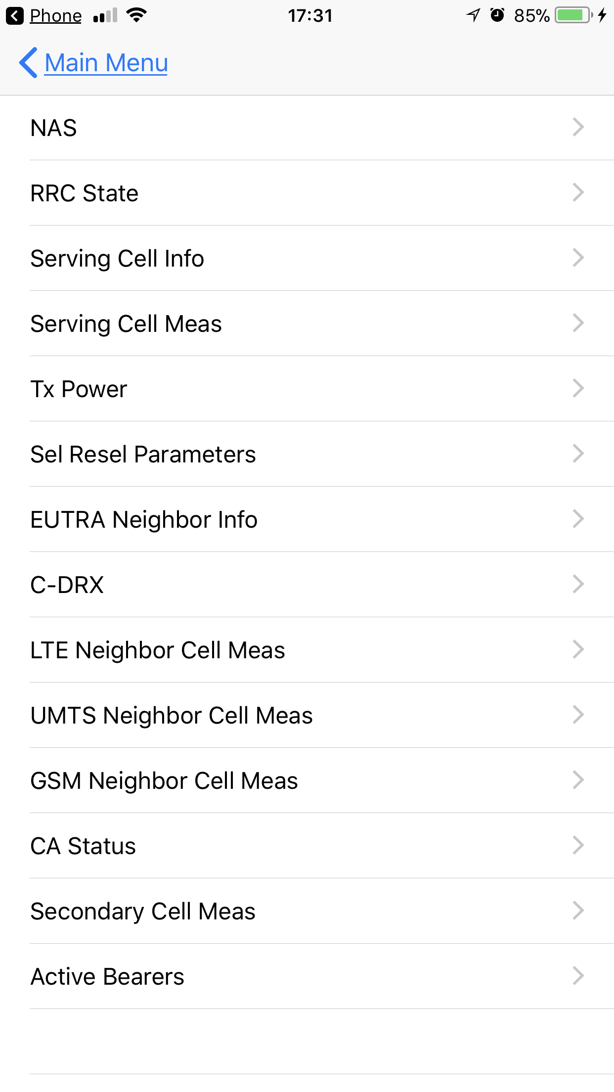

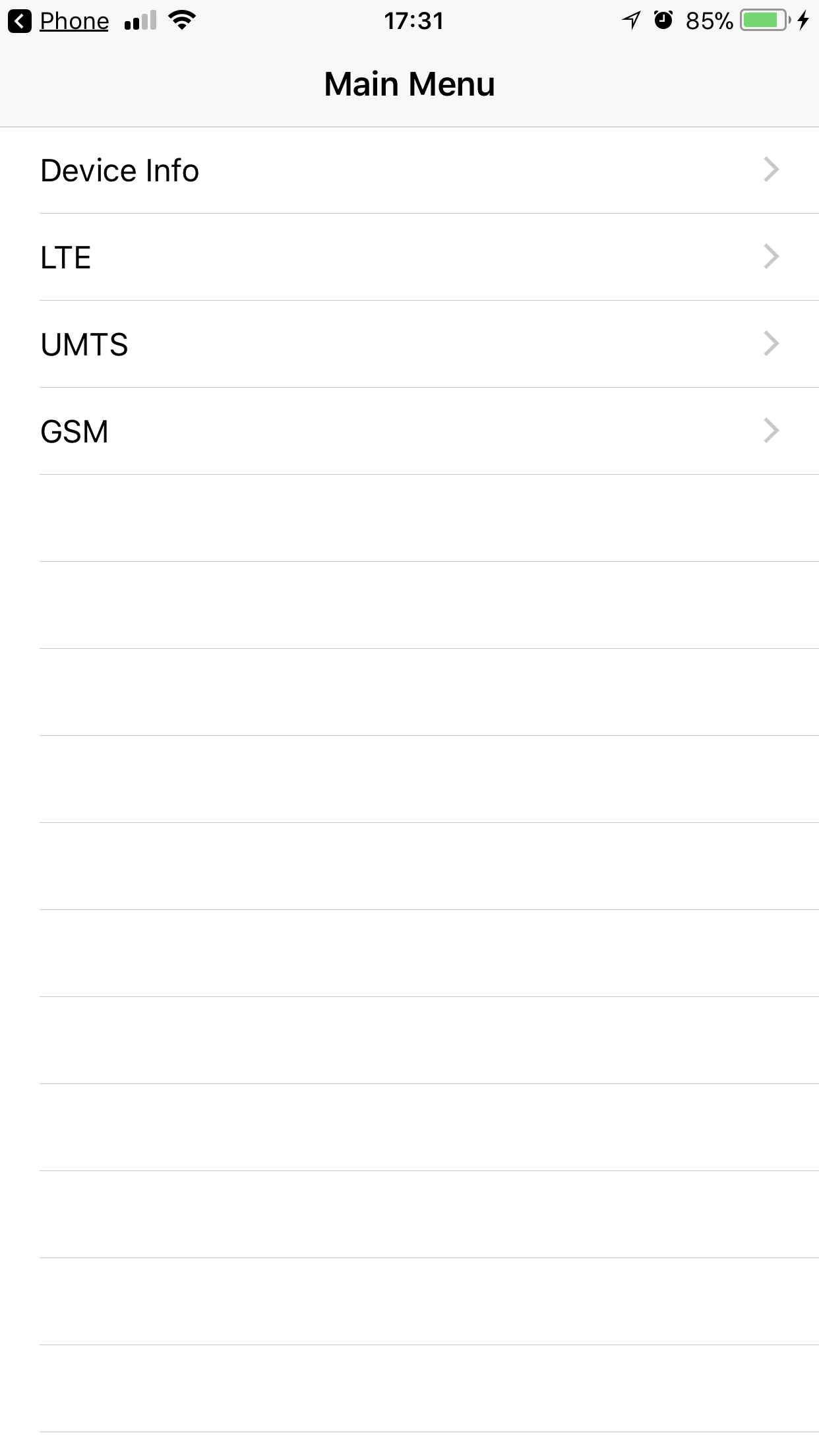

Those bars are useless. Field Test mode is your friend.
Dial: *3001#12345#*
IMG_1185 is the first thing you see. press the LTE area

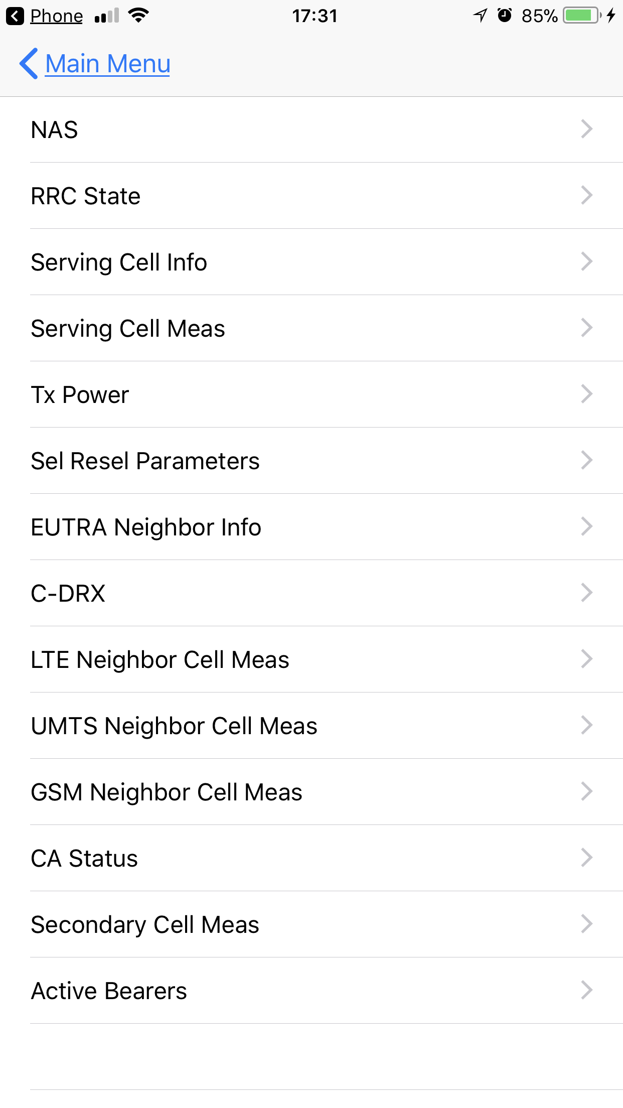

IMG_1186-go to "serving cell meas

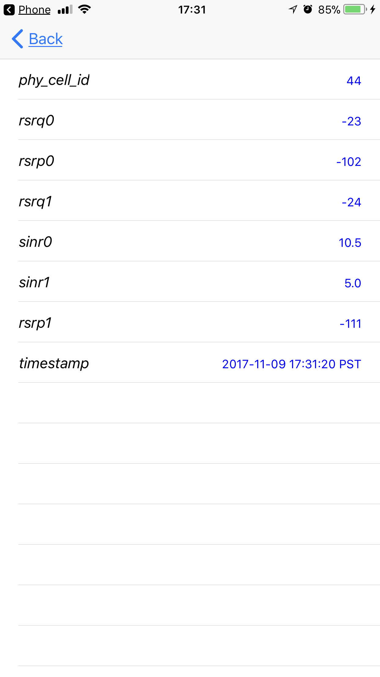

IMG_1187-rsrpo is your signal to noise ratio, in my case it's -102 dB(note the 3 "bars"

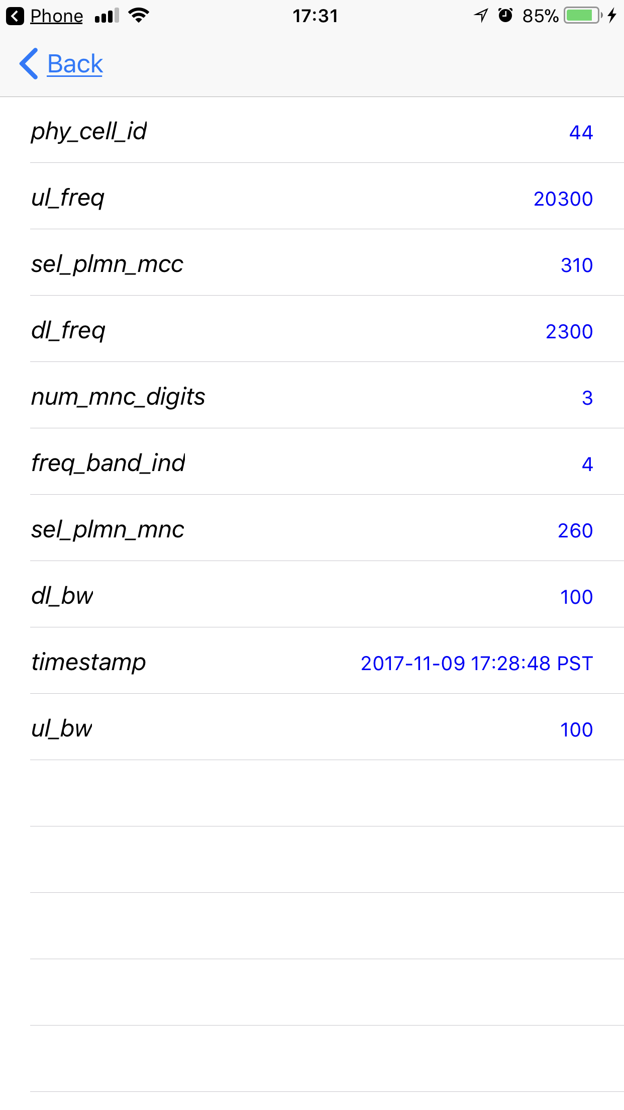

IMG_1188-give your serving cell info(go to IMG_1186 and look for serving cell info.
Dial: *3001#12345#*
IMG_1188-give your serving cell info(go to IMG_1186 and look for serving cell info.View attachment 734165 View attachment 734166 View attachment 734167 View attachment 734168

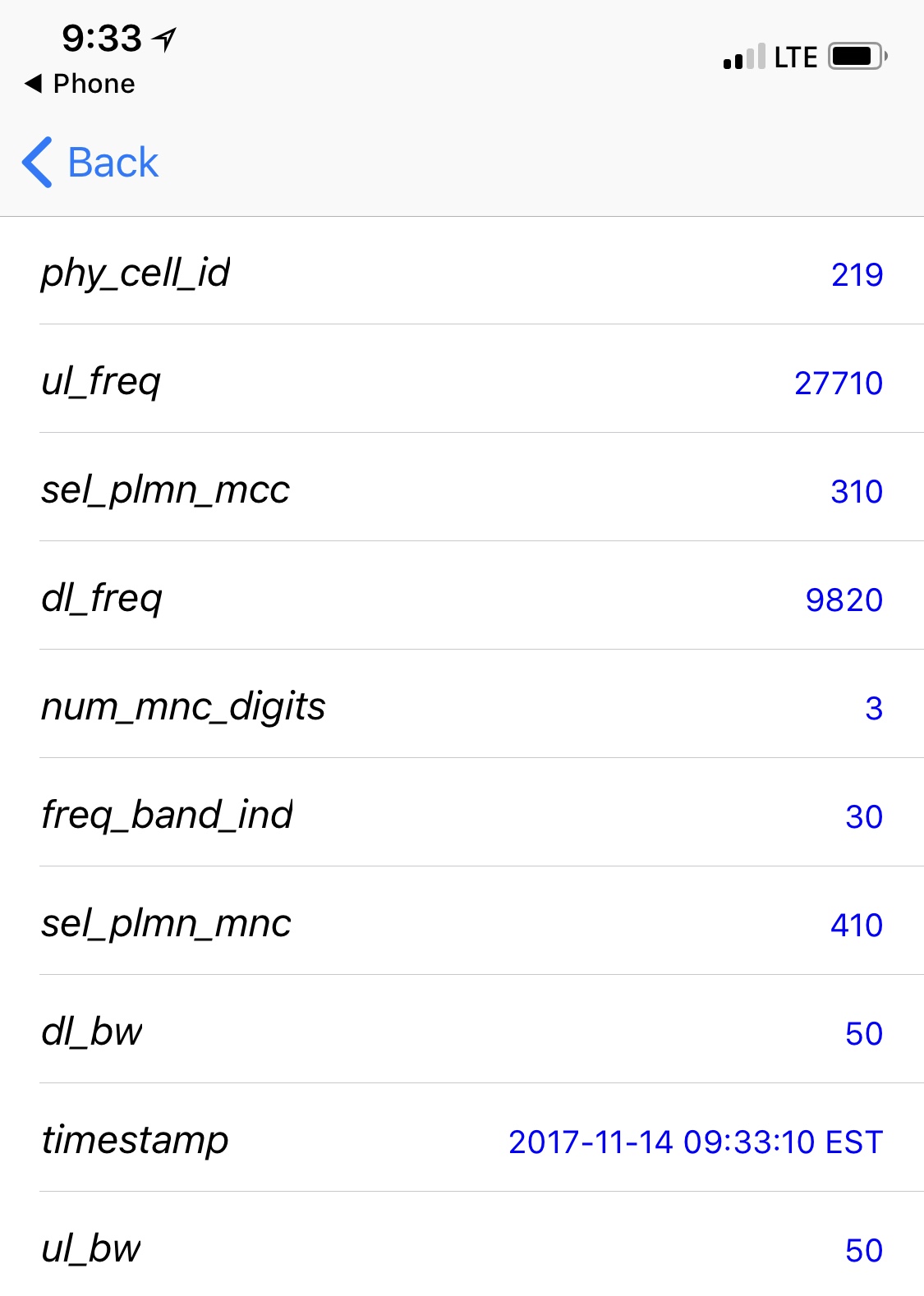

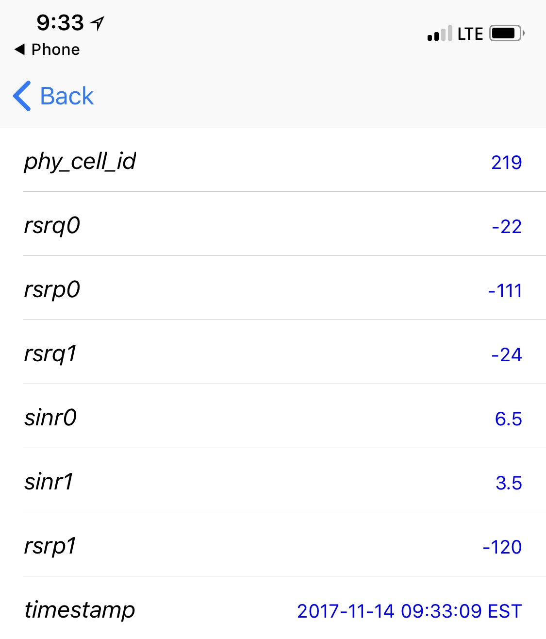

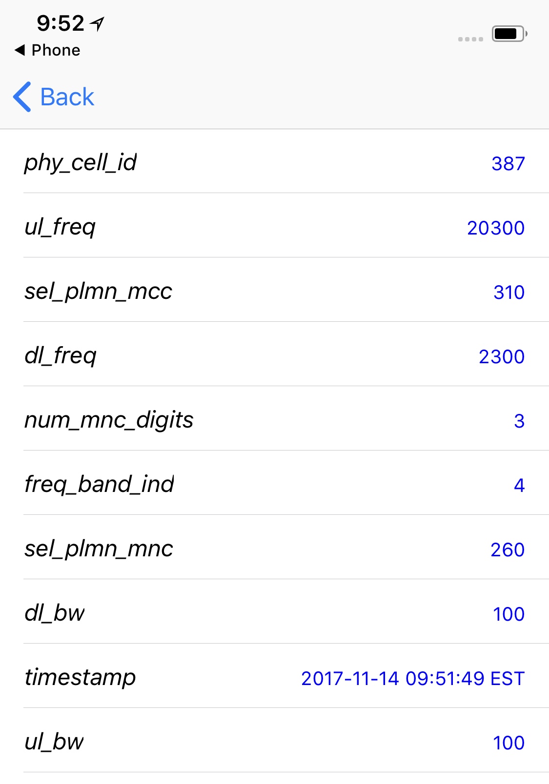

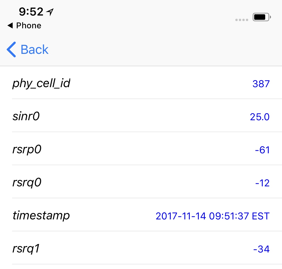

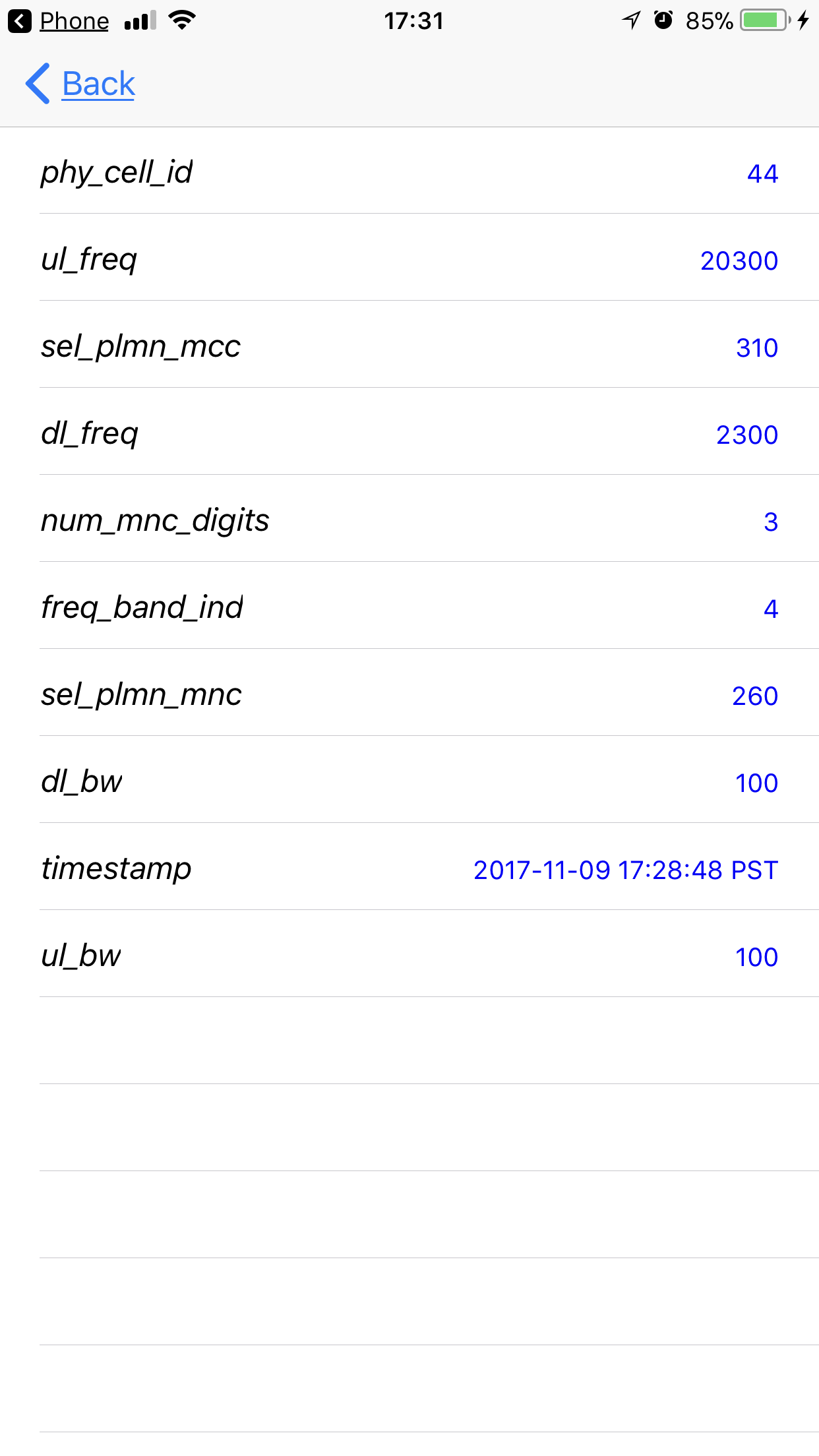

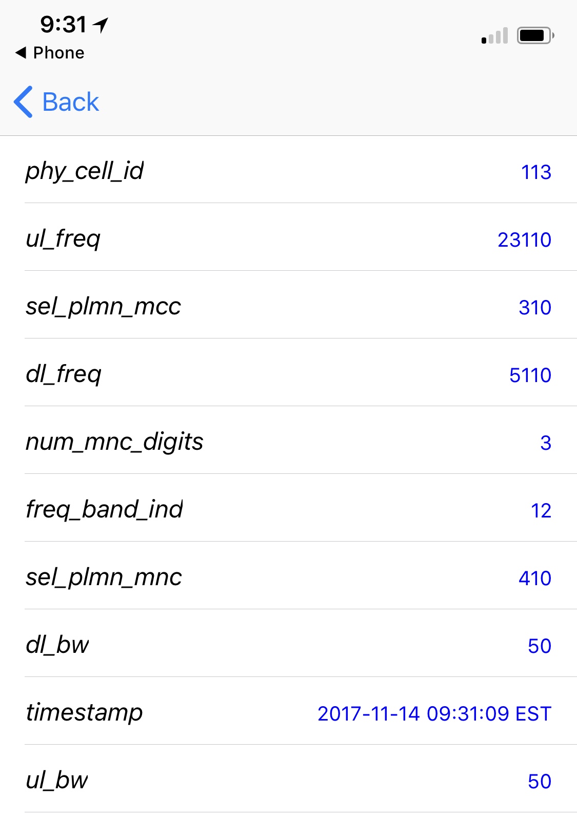

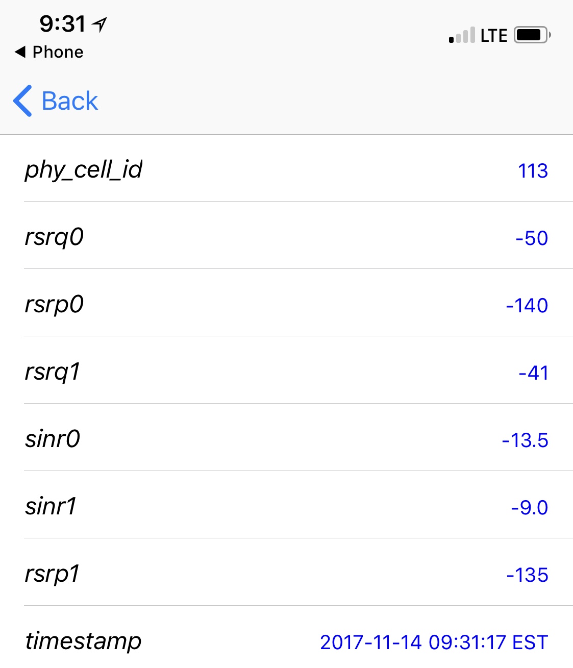

Same situation as OP. It also seems like it takes several seconds (maybe 15-30) longer to reaquire a signal when I exit a tunnel on the train than it did for my iPhone 7. I went into Field Test mode as you suggested (actually did it twice a few minutes apart while on train to work and then again when I reached my office where I had 5 bars with my iPhone 7 and have none with my iPhone X). I have no idea how to interpret the results. Can you help? I would be very grateful!
