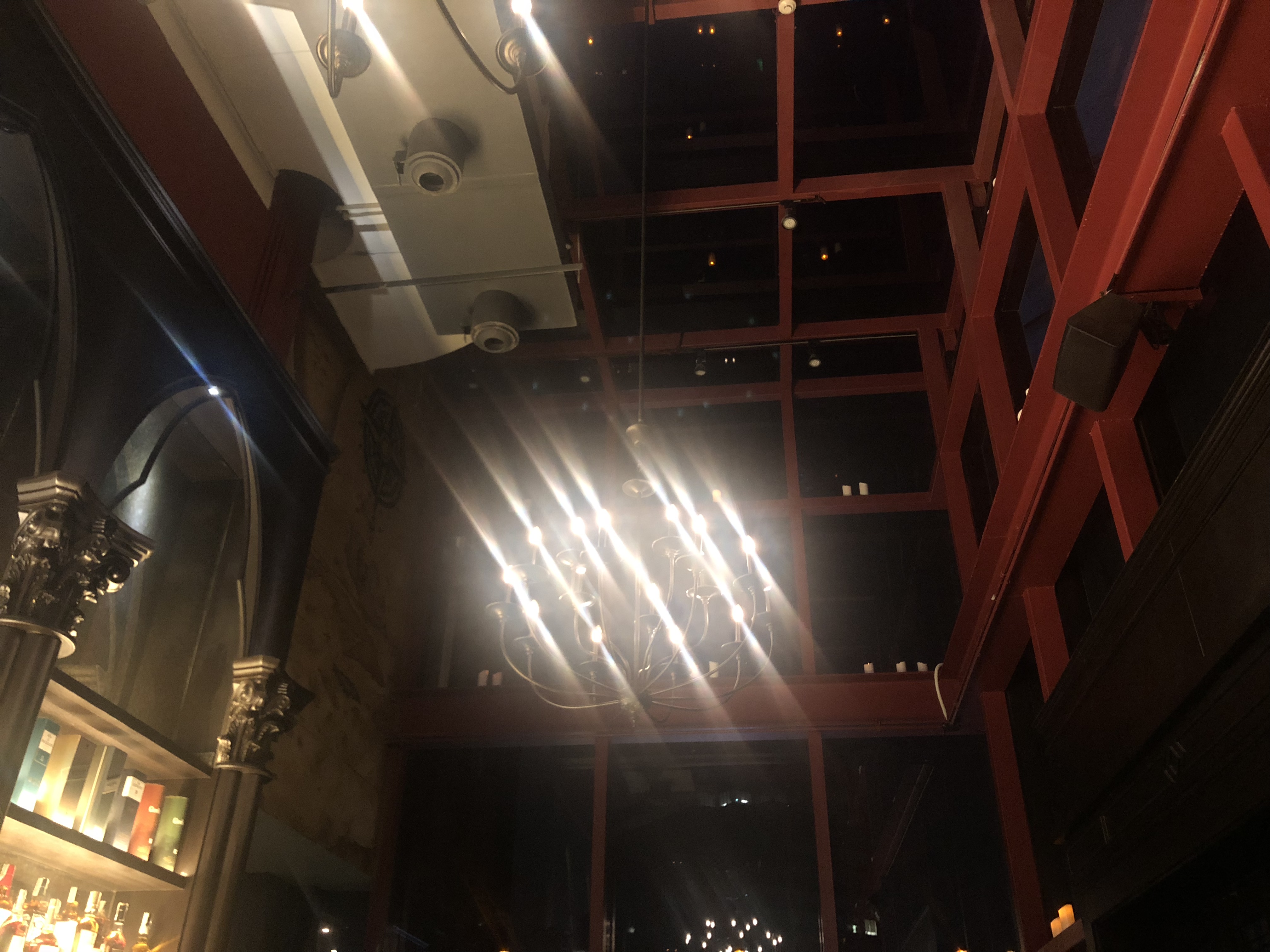

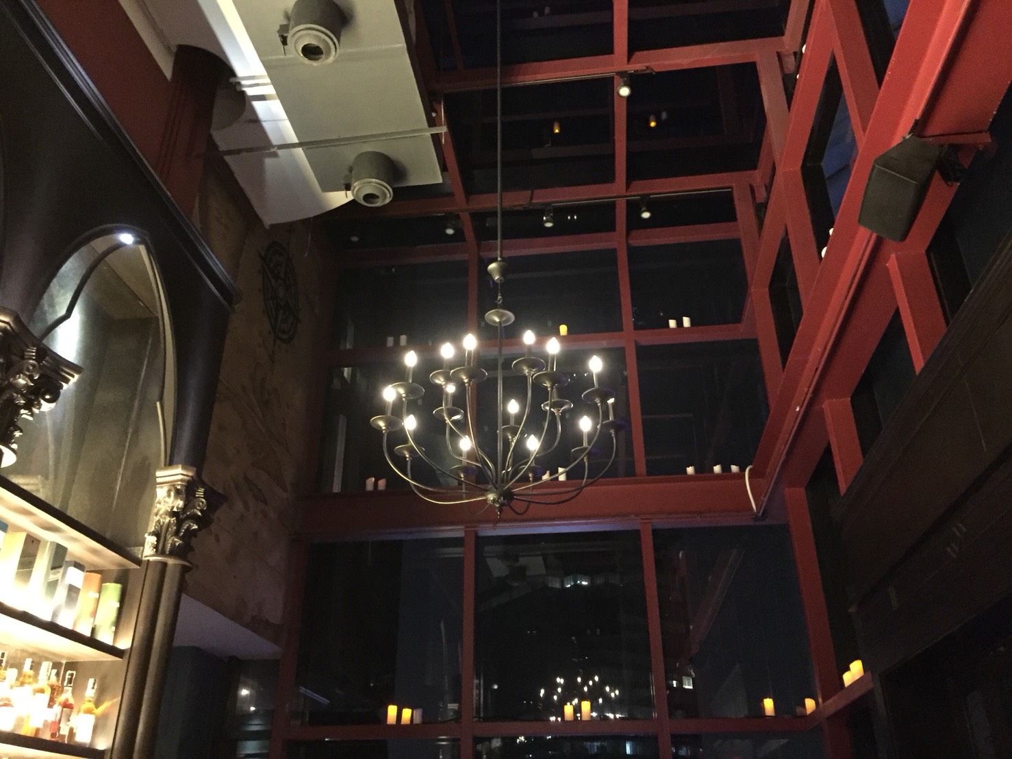

Can any other iPhone X owners tell me if they have this issue? The lights seen were not terribly over powering, just small stall lights, but in photos they aren’t close to a true representation of reality. I’m not sure if I’ve a faulty iPhone, or this is now it just is.
The camera is increasing the exposure in an attempt to get more of the screen in basically “correct” exposure and thus is overexposing those lights (blowing them out).
Adjust the exposure down some as you’re taking the shots. Tab and hold to set focus and exposure then slide your finger up and down and you’ll see you can change the exposure before you make the pic.
If I reduce the exposure the glare will maybe reduce on the lowest setting, then my photo is too dark, and requires flash when flash should not be necessary. This seems intermittent and does drive me crazy. This picture taken in the restaurant was terrible, then fixed itself a little after a reset. This is my 7th iphone and the only one with this issue. It’s now on iOS 12 and still the same. In daylight shots are fine but only get an issue with any artifical lights. Surely i’m not the only one with this issue.

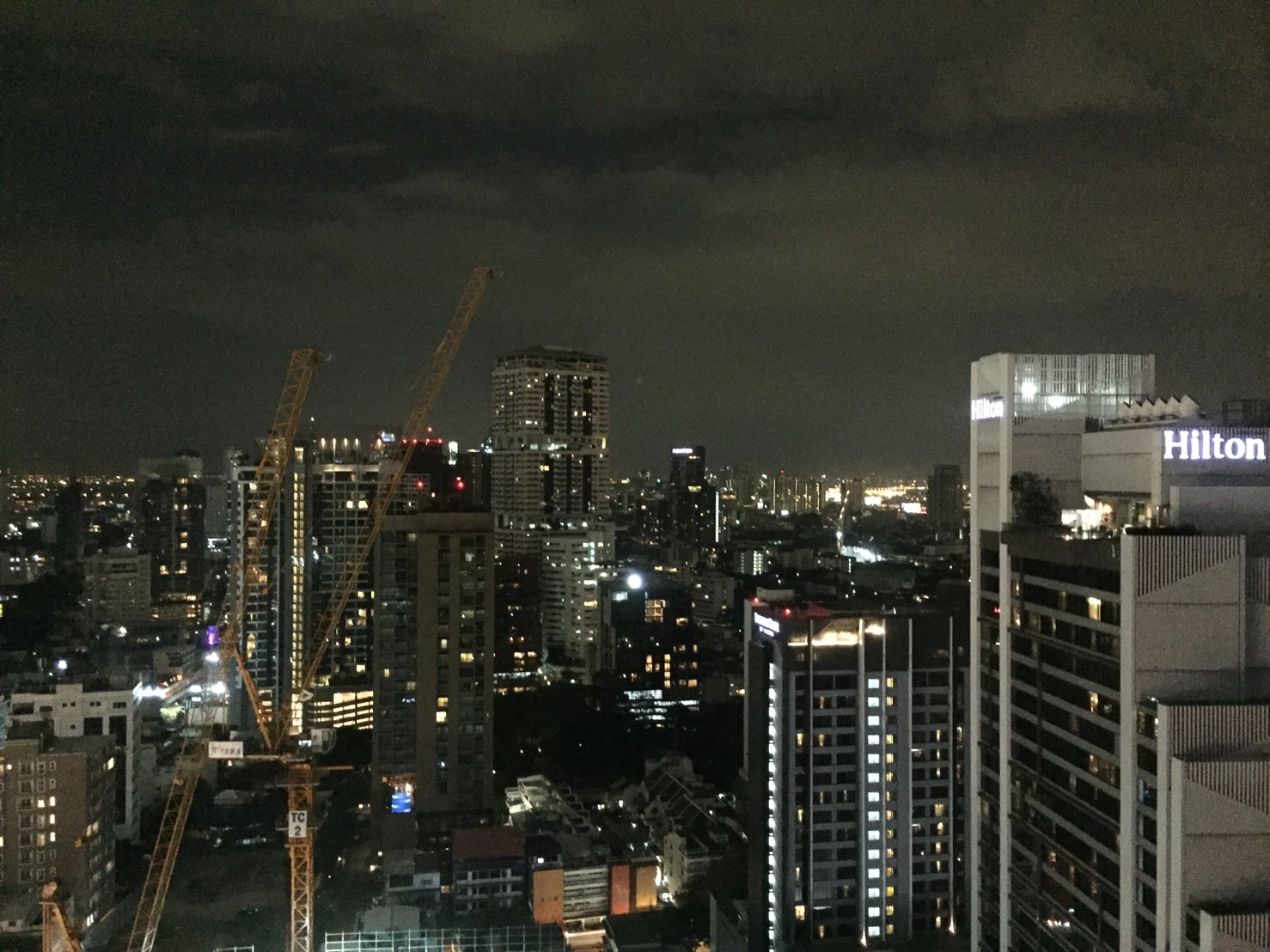

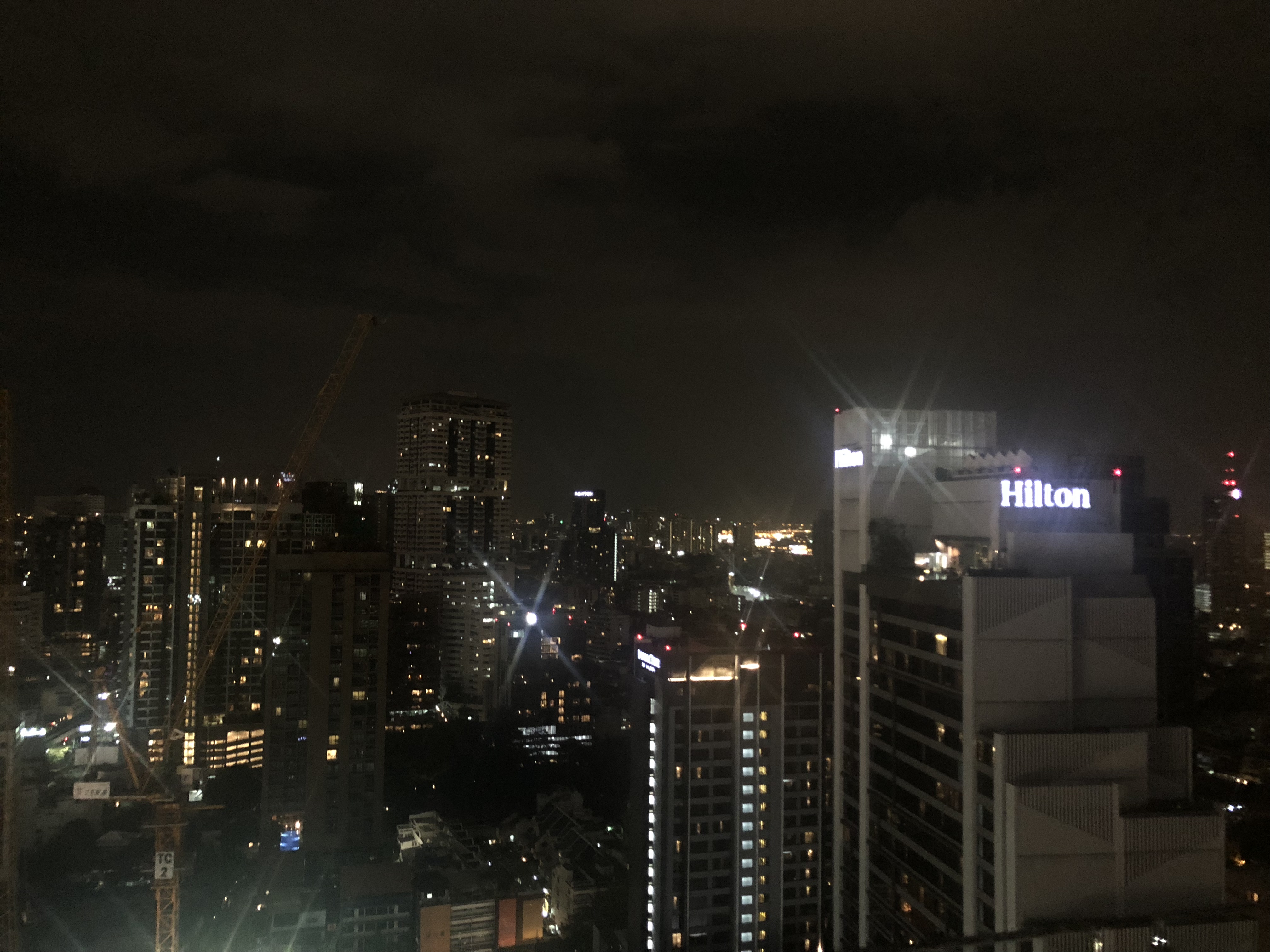

Two photos taken, one with an iphone 6, one an iphone x. No adjustments made to exposure, app opened and snapped. Which one is the £1149 phone?
It seems that the first one is from 6, it shows a lot more noise, the second one, from X I guess, is cleaner but it has too much lens flare?
The streaks look like something on the lens to me also, maybe a little grease or something cosmetic?
Try cleaning it even if it looks clean to the eye. Good luck!
Reactions: Cjallen
Correct, the sky also looks far better in the iphone 6 picture too. I just think it sends the X haywire when any sort of bright light is in the shot.

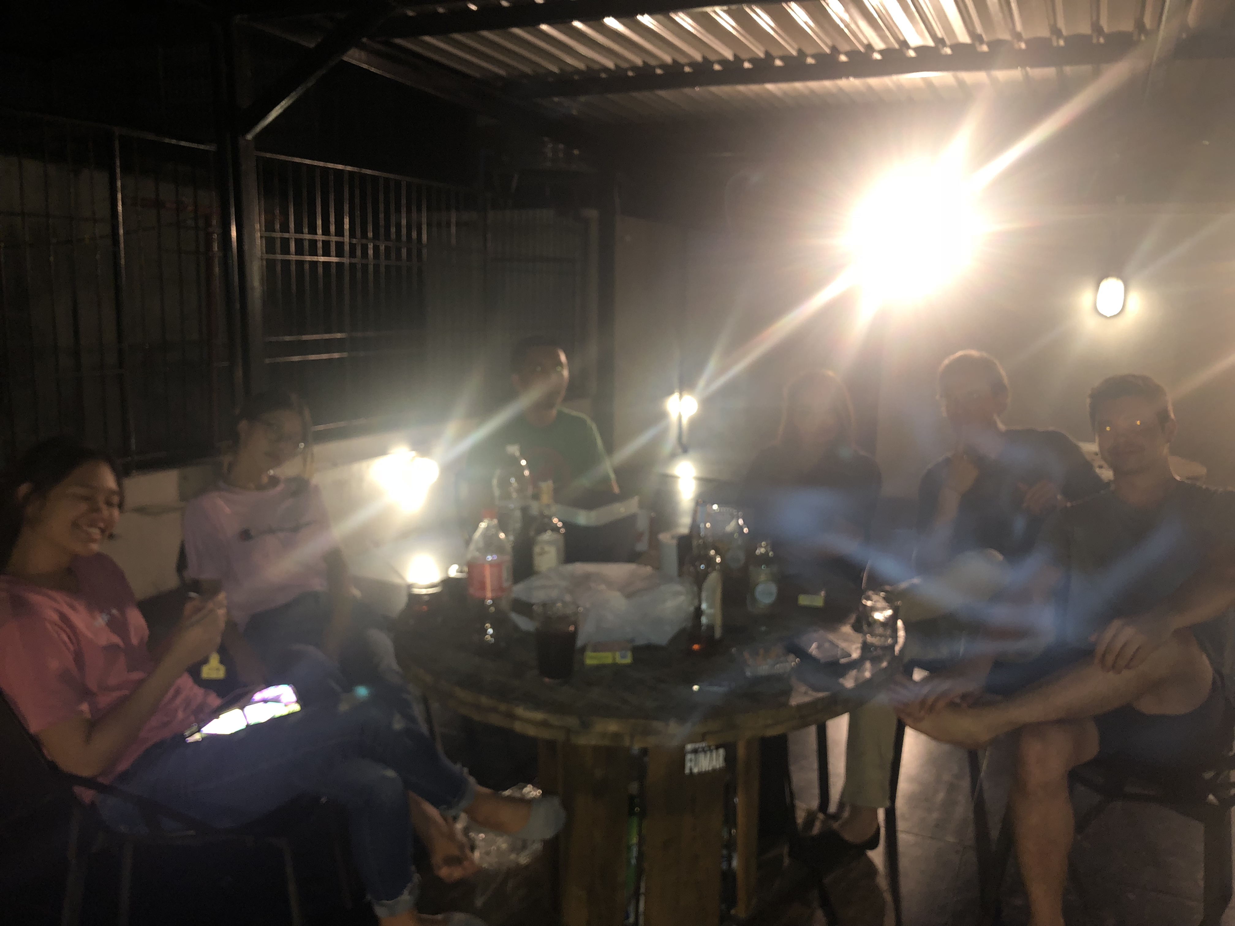

Two shots again, both with the camera app killed, then opened and an instant shot taken with no adjustments to settings.
Something weird is happening. I generally don’t see issues like this shooting similar shots with my X. This article has lots of night photography shots from the X that look better. https://9to5mac.com/2017/11/20/iphone-x-diary-camera-review/
I would try cleaning the lens again, and try different camera apps to compare... including one that lets you shoot raw and control ISO equivalency and shutter speed. If you really want good nighttime and dark interior shots, a dedicated camera and lens system with a tripod will seriously up your game, but your iPhone X should be producing better results than what you are posting. I would contact Apple about a repair or replacement if nothing else works.

I got in touch with Apple on a livechat, shared the same photo’s, and they agree something is’nt right. I currently live in Bangkok and there is no Apple store at the moment, although one is being built and due to open before the end of the year. They do have some authorised repair centre’s and hopefully they can offer the same level of service. I’ve tested it Lightroom pro mode, exposure at -3.0 and still you can see the issue from just a ceiling light.
