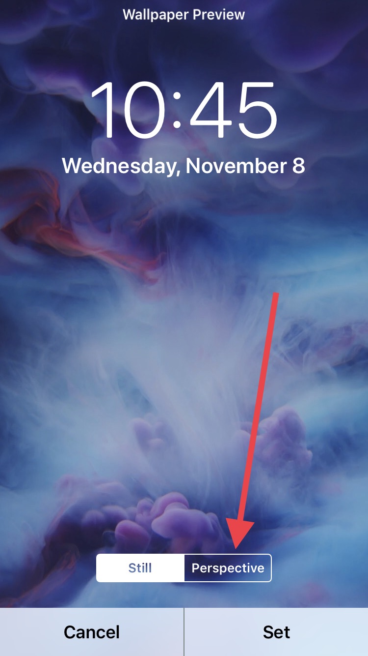

Ah I see. Bummer. And by perspective zoom, I mean this wallpaper setting.
thanks didn't notice that before. Tried it but doesn't change the flickering in certain apps so not sure if it fixed the flickering icons but i still get random lines and flickering when using apps like imessage and others.
