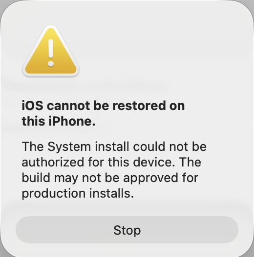

OK - tried with little success... At least I got another error message (translated, so may differ from what you'd get in English): "The iPhone “iPhone” could not be updated. An unknown error occurred (4013)."

One thought... When I just let the Mac try to update (or restore), it suggests 18.7.2 (not 18.7.3)... Maybe I should try to get the ipsw for that instead..? @okkibs - Do you have a link for that version as well (I haven't been able to find it myself...)?
Thanks - hadn't thought of that, but didn't work unfortunately...

You get that message when using the 18.7.3_22H217_Restore.ipsw or with the version downloaded by Apple Configurator?
You can download the 18.7.2 ipsw , but according to https://ipsw.dev/product/version/iPhone11,2
and https://appledb.dev/device/iPhone-XS.html it’s no longer signed by Apple.

That is what I see too, only the 18.7.3 ipsw that I have linked above is signed by Apple. Any authorization error messages are caused by using the wrong ipsw file. The one I linked is correct for that iPhone model and if it does not install then we have to look at that error. That would be error 4013. I think the Apple restore process where it downloads a file in the background isn’t up to date and is downloading 18.7.2 which cannot be used anymore.
