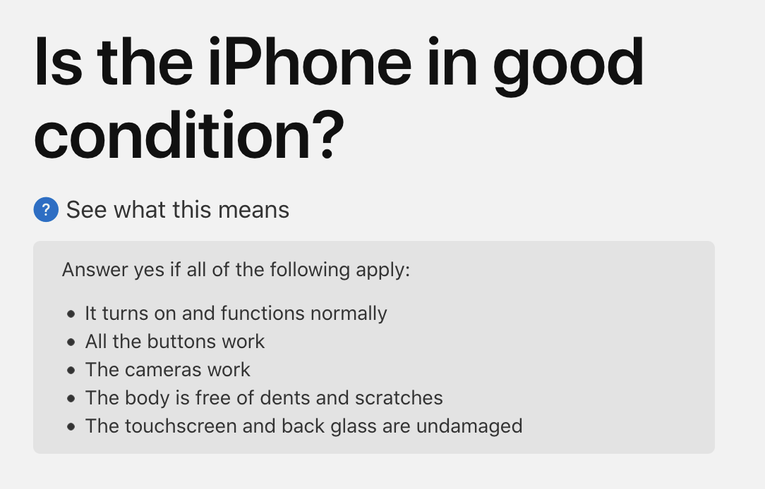

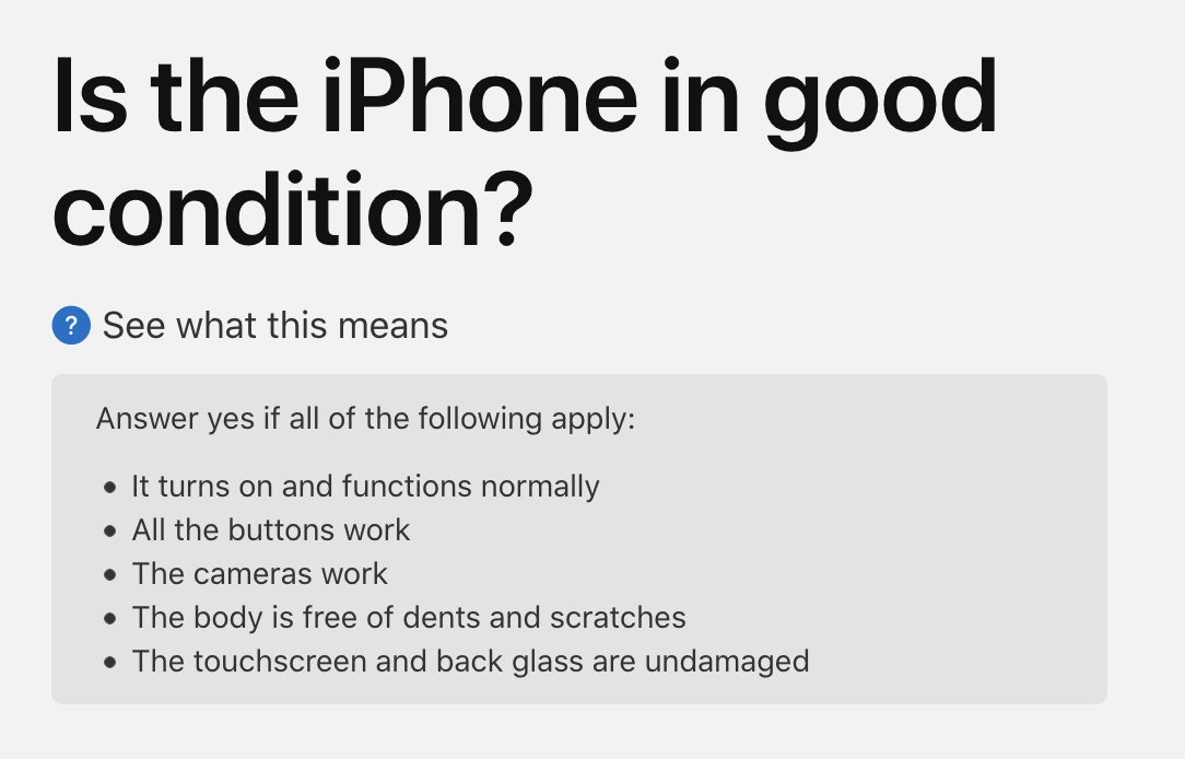

The trade-in idea is not bad. Technically, the criteria for "good condition" from Apple does not include the lightning port's situation:
We'll definitely have use for an Apple gift card, so we may give that a shot.
