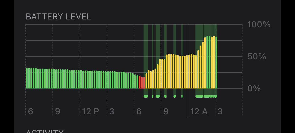

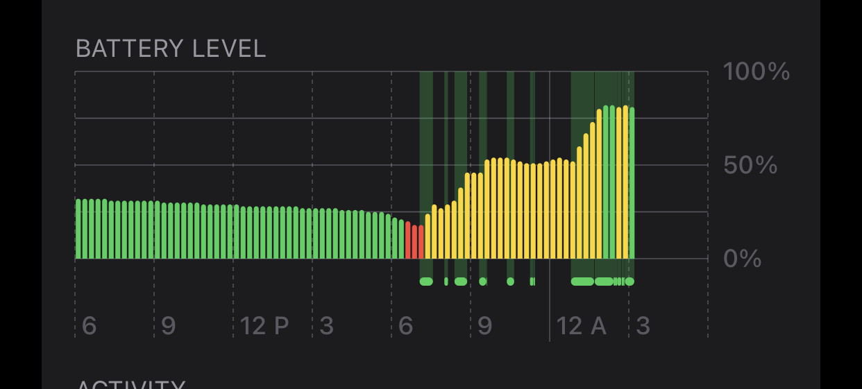

Hello, I tried charging this iPhone XS Max but it gets stuck at 82% with optimized battery charge turned off.
I tried changing the cable, didn’t work
I tried charging it wirelessly, at 82% after 3 minutes the wireless charge or qi starts flashing meaning the phone doesn’t accept any electricity.
I took it to change the charging flex but they say the flex is good.
Is the problem the battery itself?
Battery life is at 84% and from charging data, it shows that it loses electricity.
2 minutes charge 2 minutes cut and so on.
I hope it’s not the motherboard.

1 percent charge in 2 minutes
Doesn’t charge continuously like the picture shows.

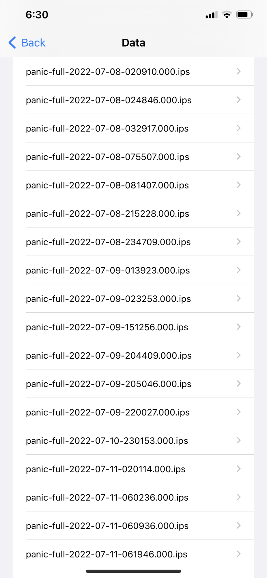

Look how many panic logs I got.
AOP k2-bosch and
PRS0
