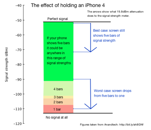

To answer the OPs original question, depending on the signal strength of the area you are in, you may still see 5 bars when you hold the phone in a manner that bridges the antennas, see the diagram below:
Probably because you were in a strong signal area. Wait until you are in a place where you only have 3-4 bars to start with. Then try it.
I can certainly find places where the signal doesn't move at all if it is really strong to start with.
I can be at 5 bars, 2 bars, 1 bar and this never happens. It's not as cut and dry as you think either.
in most locations i can I hold my iPhone 4 covering the bottom left corner and still get 5 bars, or if the signal isn't 5 bars to begin with, the signal won't change.
However, certain areas(even where the signal isn't weak), I can hold my phone and it will lose bars. Even the speed test will dramatically slow down.
Still, yet in another case, there has been one instance where the signal was at about 3 bars, and holding the phone covering the bottom left corner caused the phone to lose signal so much that it started searching for service.

I'm really starting to think these are all caused by different frequencies or something. It really is location specific.
Depends on where I am...which shows that Apple's answer makes sense!
I can get 5 bars of 3G at home but the signal will drop.
I can get 5 bars of 3G in other locations and not have the signal drop.
This tells me that the iPhone is misrepresenting the bars and it will stop once they push the update.
