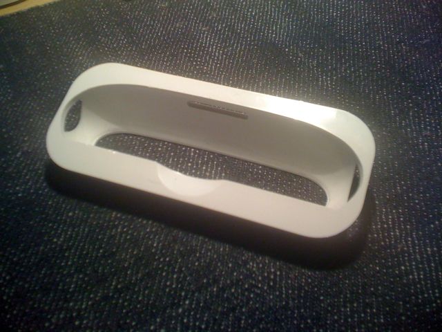

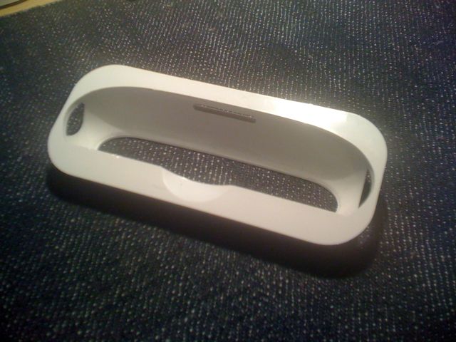

I'm know questioning if the dock adapter with the whole bottom missing is an Apple product. Sounds silly but i can't find any reference to these earlier versions.
Funny thing is it fits perfectly, but it hasn't got the adapter number like the 9-17 you get now.

Well it turns out that this adapter i have is an iclarifi adapter, trouble is i really don't remember purchasing one!!
I did buy a 3rd party iPhone 3G dock from eBay ages ago, maybe it came with that!!
See attached pic - if you can get that one, you do not need to modify anything, plus it fits the universal dock as well.

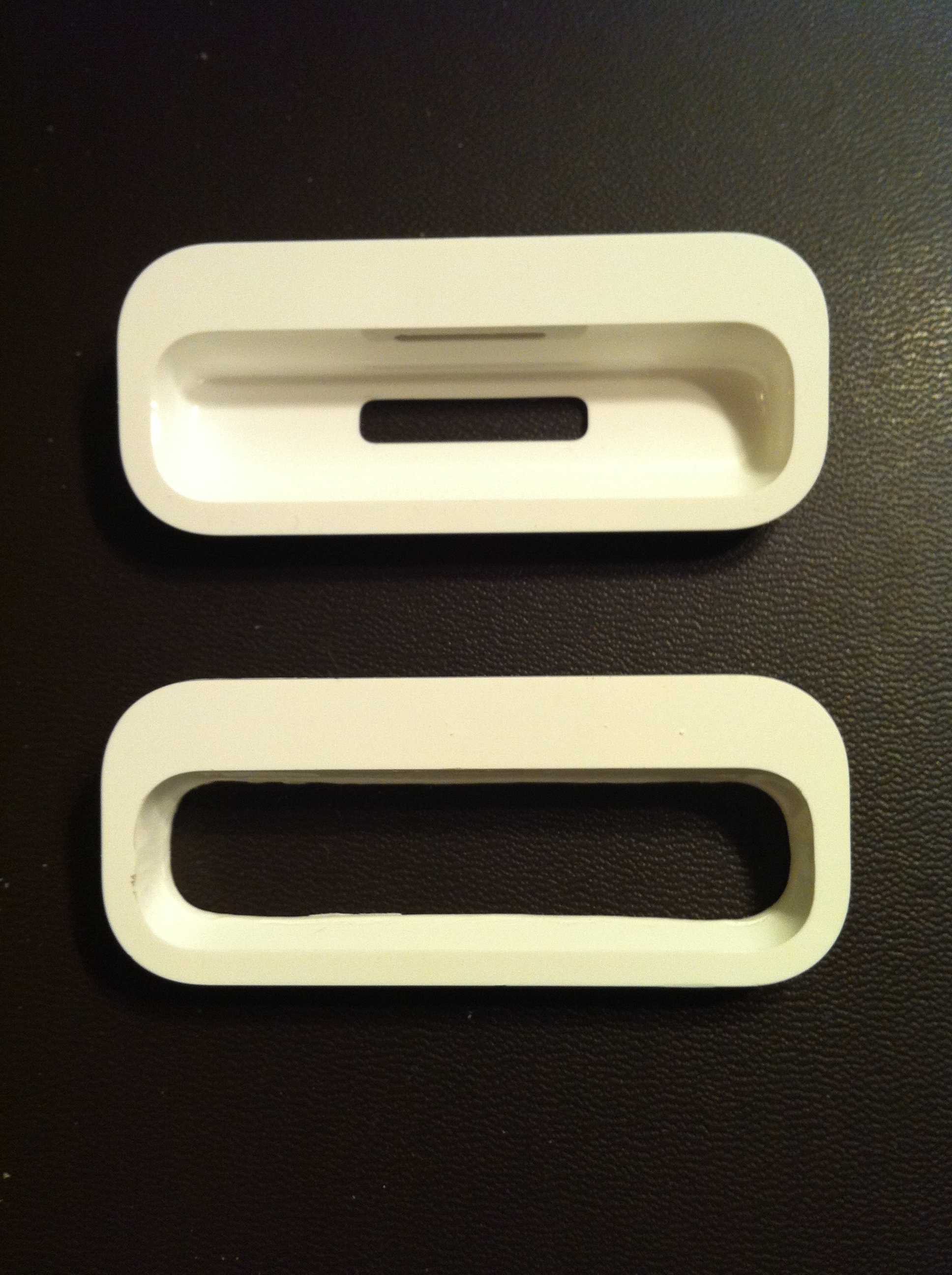

I'm currently using a dremel (there are other types of handheld sanding/cutting/filing machines available!!) to enlarge the original hole on adapter 9.
I used a pen to draw around the inside of the adapter, then slowly and carefully used a tapered filing tool to cut/melt away the bottom part (depends on how fast the dremel goes!).
Dead easy to do, pics to follow.

Well here we go.....
Enlarged the hole big enough so iPhone 4 + Bumper fits snugly, but more importantly, syncs and charges 🙂
See attached pic, top is original number 9 adapter, bottom is modified version - still got to tidy up the edges but you get the idea.
