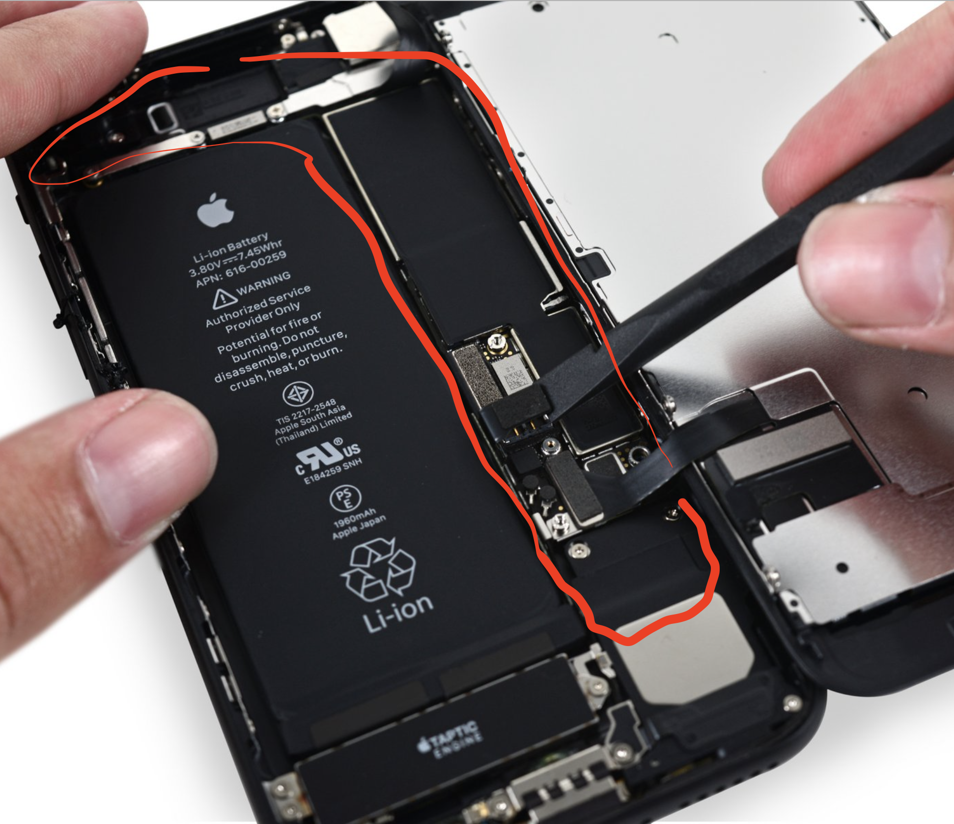

Is there anything more to this story? What does the audio do now that makes it "borked"? Was this an APPLE STORE or authorized repair place?
The reason I ask is because repairability is a moot point, the screen needs to be removed regardless. Even if the logic board was totally modular the screen still needs to be removed. Its not modular however the logic board is not easy to damage when only going screen (even battery) deep. It is covered with an RF shield with a protective non conductive layer on top of that.
On top of that the "audio circuitry" (audio processor and AMP) are on the opposite side of the logic board facing the rear of the phone.
To "bork" the audio system during a screen replacement would be quite the feat and at the very least is pure neglect on the technician.
