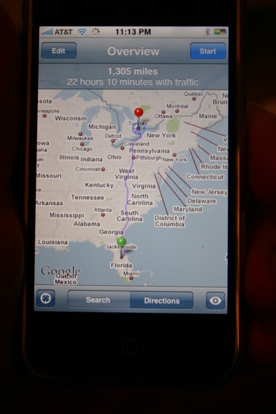

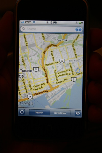

It has been doing it consistently since before the 1.1.4 update and still does it with the update. Its always the exact same location it shows me near a cemetery in Toronto. I routed the direction from my home address to my current location, it gave me a distance of 1305 miles. To be fair it only seems to do this when I am at home and on my home WiFi network. Other than at home (where I don't need to know where I am) it works just fine.
Well, that's a clue. Did you buy your WiFI router used? Perhaps from Canada?
(Assuming you're using your own network and not a neighbor's! )
In either case, if Skyhook mapped the router's MAC address in Toronto, that's where their database has it. Until you write them and change it, that is.
The router was installed by my ISP and it came new in original packaging. I haven't attempted to solve the problem nor do I have any intention to since I don't need to determine my location at home. I thought it was interesting that it was so far off though.
