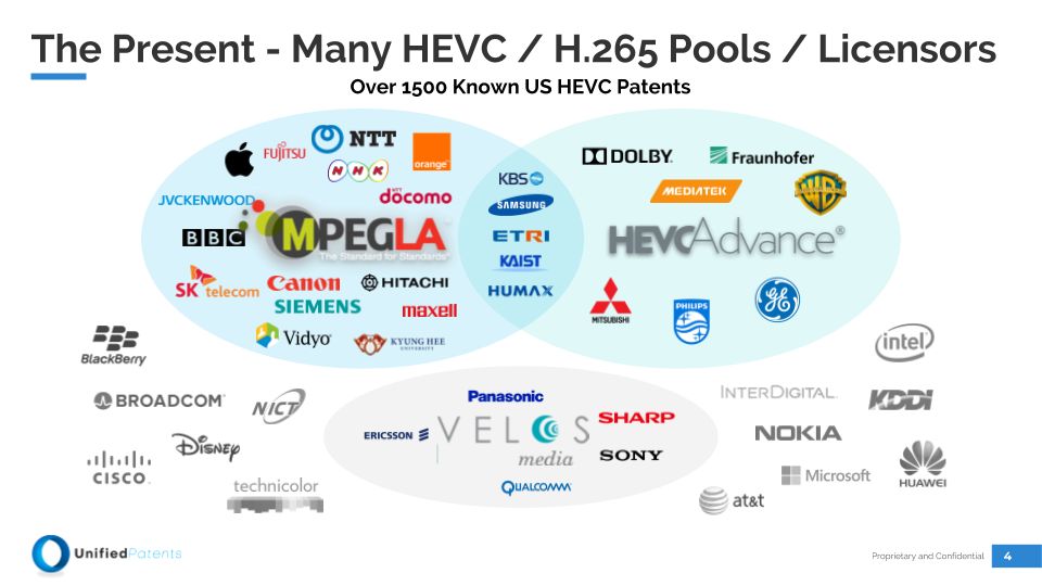

Your press release is by HEVC Advance. HEVC Advance is one of three major patent pools, along with unaffiliated patent holders. HEVC Advance holds a relatively small number of companies. Importantly MPEG LA does charge for software implementation, so it still isn't free.
The big unknown is Velos Media who does not publicly disclose their policy and is rumored to charge content fees. Notably Velos Media has hardware companies but doesn't have any content providers, so you can see their incentive to charge for content, not per unit.
Wrong.
College Board isn't implementing an HEVC codec and the students are the ones distributing HEVC content (which Apple is the responsible party for any HEVC distribution legal issues). College Board isn't encoding and distributing any HEVC content so any "content fees" you're suggesting from Velos Media won't apply.
It doesn't make sense to charge a "viewer" (the end user which would be College Board in this case) of HEVC content since that would be literally hindering the adoption of this standard. In the past, MPEG-LA never charged any consumer of H264 content. They've only gone after distributors of internet video like Youtube (which they made free later).
Please do some more research. You really don't have any idea on what you're talking about here.
