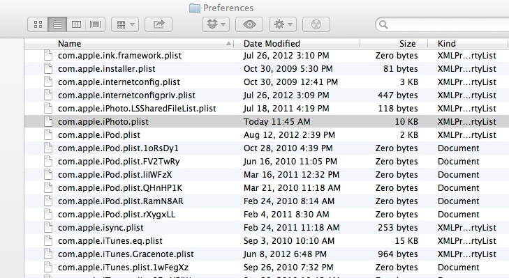

Same problem here, but I was able to fix it by deleting com.apple.iPhoto.plist in library/preferences, then restarting iPhoto

With Finder showing in the menu bar, click "Go" while holding down the "Option" key. Continue to hold the option key and select "Library", then scroll down and select "Preferences", find "com.apple.iPhoto.plist" and delete it. Restart iPhoto. That should do it

🙁 the file com.apple.iphoto.plist is not existing in the Preferences !!!!!!!

that's odd.. Check mine out

none of the iPhoto files shown in your post are showing in my preferences !!
This is weird !!!
Did you follow my directions exactly? Did you go through finder from the menu bar at the top of the screen??
NO I WAS BEING A DORK.... I DIDN'T FOLLOW YOUR INSTRUCTIONS AS YOU SAID....
I DID NOW, AND IT WORKED !!!
CHEERS MATE... YOU HAVE MADE MY DAY...
Thanks..
