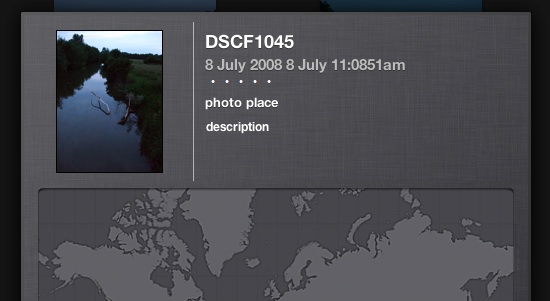

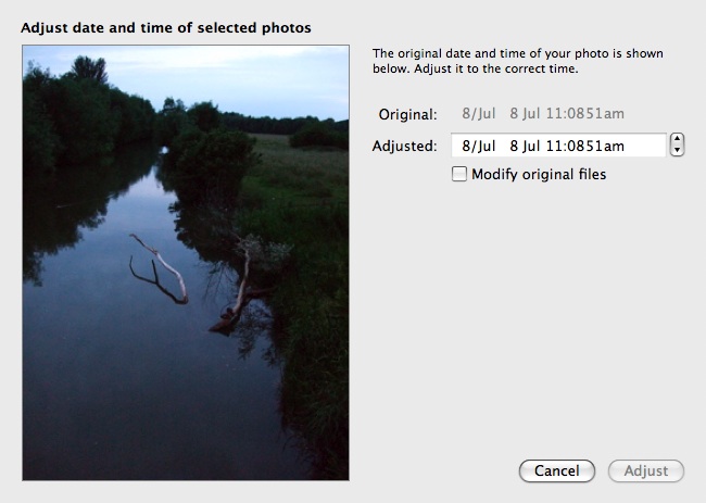

Hi,
I think something is wrong with how the date/time/year has been uploaded or displayed in my iphoto. All the great replies from you guys suggest it should be simple but I just can't get the option to change the year. See screen pics below. I can change date and time but not the year. Where is the year option?
Thanks

Wow, there is definitely something bizarre about your settings. Again, I'm at work right now and can't check my own settings to see what might be different, but I imagine that maybe there's something about how the date is displayed. You may want to look through iPhoto's preferences for anything to do with the date display format.
FIXED!
I went into mac OSX system prefs/date and time. I realised that when I changed the format of date and time so it gave me the date in the menu bar (in leopard) I accidently left out the year from the short date format. I added the year back in and hey presto, the year appeared in my iphoto photos and I just used the adjust date/time option to correct the year.
