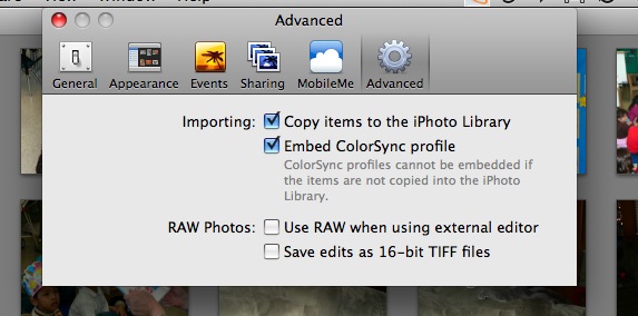

I just thought I'd follow up with the solution in case anyone else does a search for this problem.
Somehow in the advance preferences, I unchecked the option of copying photos to the iPhoto library. Everytime I "restored" my photos, be it from Time Machine or my SD card, they would work... as long as my SD card was in the reader or TM didn't do a new back-up.
I searched the Apple Help boards and figured out my problem. I rechecked the box, deleted the "bad" photos and then re-imported them. Viola. Problem solved. The photos are back in my library perfectly.
Here's a picture of the box you need to check, just for reference.

Isn't the issue here that the photos aren't in iPhoto, just the thumbnails? Do you have that same option for copying unchecked? Did you have a lot of photos on an external drive which is no more? Or maybe just rearranged a folder or folders where they were?
Had the same problem when I made a CD of a photo album to transfer to another computer.
I'm sorry but it sure as heck seems like the default "Copy items to iPhoto library" should be YES?!
In the iPhoto Library, there are aliases for all of the photos stored elsewhere. You can replace the aliases with the actual photos and they will commence working fine in iPhoto. You will have to move each folder's contents individually though, which can be a pain for a lot of folders.

I don't think that's even an "improper" solution, seems to me all you are doing is copying the thumbnail out and then importing the thumbnail, not the actual photo which is gone. So you just have a teeny image left, not the original.
Maybe there is a bug which accidentally unsets the 'copy to iphoto' flag at random, or maybe people have clumsy fingers?
In either case, they rarely seem to have backups :-(
