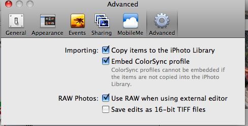

There is an option in iPhoto's preferences to prevent iPhoto from copying your photos into it's library (see attachment). All that is created is a small thumbnail file. I would delete your iPhoto library and stat over, otherwise you run the risk of corruption if you try to manually delete the copies.
