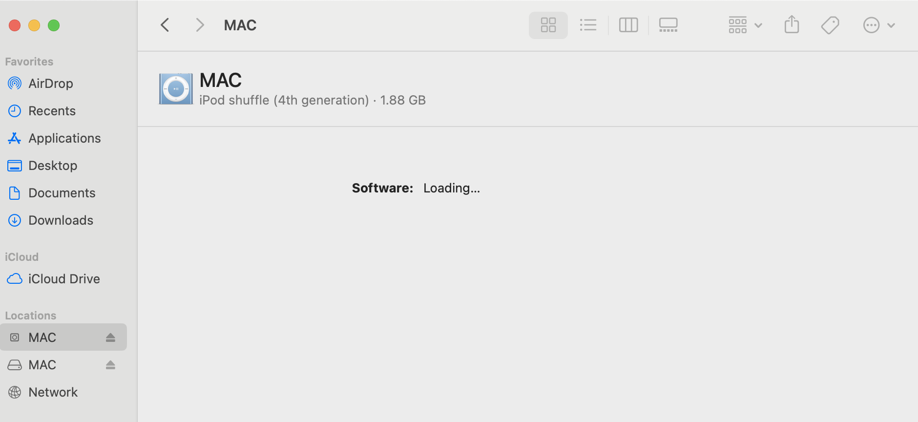

Hello,
I was given an iPod Shuffle 4th gen (1.0.3) in original packaging. When trying to restore on my Air M1 (Sonoma 14.6.1), the error message is 'software not available for this iPod.' When trying to restore on a Lenovo (Windows 10 - iTunes 12.13.4.4), error message is 'iPod could not be restored. Unknown error occurred (1439).' Another time it was error (1430). Been down several rabbit holes for a while without progress.
I know shuffles are obsolete, and there could be any number of issues with the battery, etc., but I've been listening to podcasts for years on my current 4th gen shuffle and hoped this 'new' one would be a great backup.
I had an issue a few months ago migrating my shuffle from OS X to Windows and was given a perfect solution (thanks Grumpus!!). I'm hoping for a bit more luck again with this iPod 🙏. Any help is most appreciated!
Thanks!

Hi again Grumpus!
The Air recognizes the iPod, but will not get past 'Software: Loading...' I get errors when trying to Restore through Disk Utility.
The 'new' iPod came with a USB A to 3.5mm jack so I've tried that one as well as the one I've been using to charge my current iPod. It was connected to either the Air or Lenovo for a several hours over a few days as I tried to sort this out. Still flashing orange at this point. Will plug it in again.
One post said to try connecting directly to the Air. I currently connect through an Anker hub, but might buy a USB A to USB C adapter to see if that would help.
I took a quick look at the @bogdanw post. Will have to dig a bit deeper (I am not the most technically-savvy person) and give that a try.
