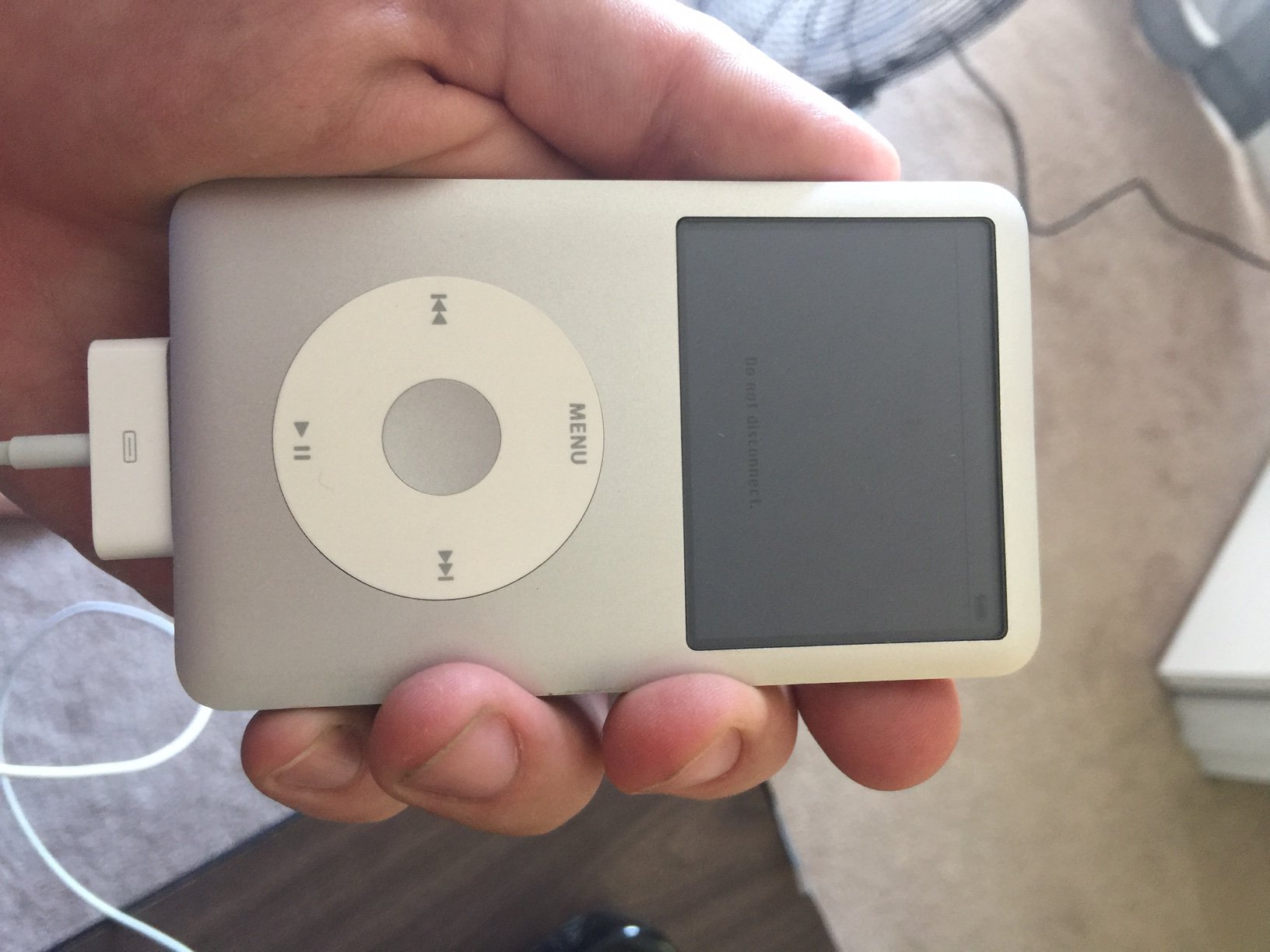

Just installed and put back together but everytime I connect it, it tells me to restore and gives me the restore error 1429. Also when I try to go to disc utility I see the "apple Media Device" pop up but can't format it to neither Mac OSX Journaled or Exfat. Just says it's failed, any suggestions?

It's an msata, it was originally formatted as fat 32 but when I connected it, it read okay until I had to sync then iTunes said my ipod needed to be restored. (I'm on a mac) Went through that process and it says can't be restored error 1434. And when I try to wipe the drive in Disc Utility it tells me it can't write to the last block of the drive. It only shows "Apple Media Device" no parititon or anything. Really weird, I've restarted my computer changed cords and ports and tried a different mac OS X machine. The only thing I can think to do now is to find a windows computer try to format to fat 32 then if it recognizes it in the mac immediately format to mac OS X extended. Any suggestions?

Tried the same process in iTunes and right clicking and formatting on a windows machine to no luck. Just tried what you said to do in terminal and it says "error 69760 unable to write to last block of device." Hopefully I can find one of those cables and try it out. The ipod keeps going in and out of disk mode. When I plug it in the computer it goes automatically into disk mode but when I unplug it. It starts up with the apple logo nice and bright then says use iTunes to restore.

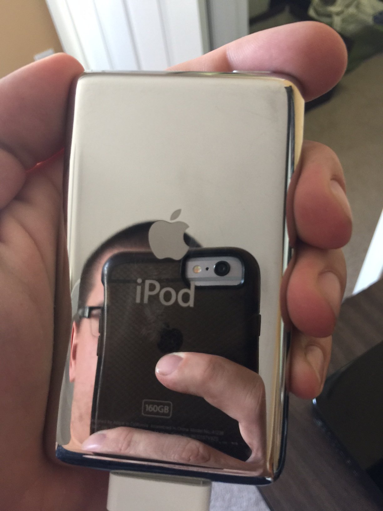

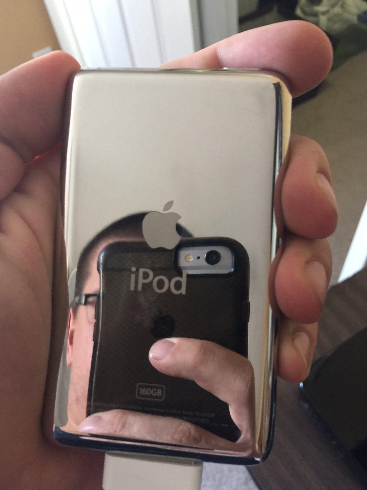

Yeah that's what i'm considering doing, only problem is i paid a well-reviewed Ebayer to do it and i haven't heard a response from him in over 2 weeks so idk if he's just said screw it or has something going on lol. Just sucks, i can't get it to format at all and am not sure how he fixed it last time so i'm just kind of MIA at the moment. Not sure if i need to buy and enclosure and open it myself and put the SSD in there. Even though he mentioned he did that because he thought the drive was fried. but said "after several tries i got it to format to OSX" but that was the end of the explanation. I'm very temped to sell this as is, if you or know anybody interested. it's in a 7th Gen 160 GB iPod in very good condition. The back isn't bad at all either, considering it's age. Maybe one or two scratches here and there but nothing like most iPods.
