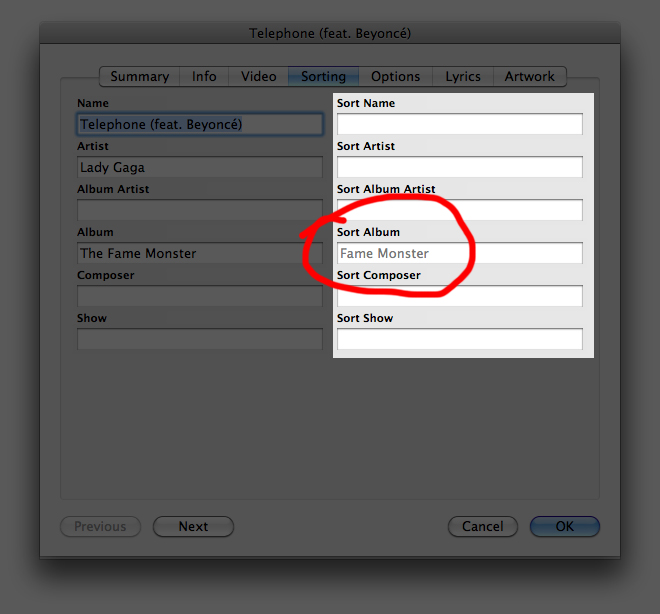

Right click on the song in iTunes > Get Info
Go to the sorting tab and see what's up there.
In the column on the right, it will show the way it sorts the song.
Check out my attachment.

Actually I was mistaken. It effects my Compilations list. My Album list is fine.
I checked the sorting and it looks how it should ie. Fame, Fame Monster.

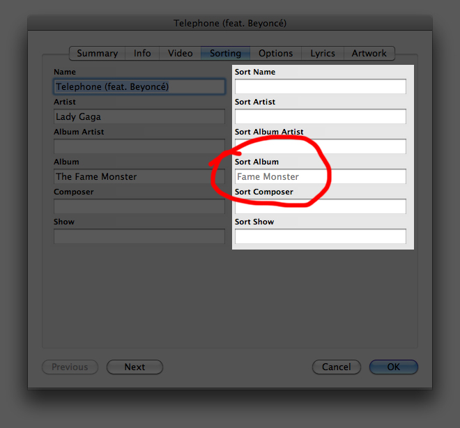

What's the column on the left for? When I looked at some songs, I didn't have anything in the right column.
The column on the left is the name of the song, the column on the right is how you want it to be sorted.
This is for songs that start with THE or A, etc..
So as the OP said, The Fame Monster, it sorts it under F instead of T because of the sorting category in iTunes (iTunes does this by default).
You can go in and manually change it so it sorts it under T.
