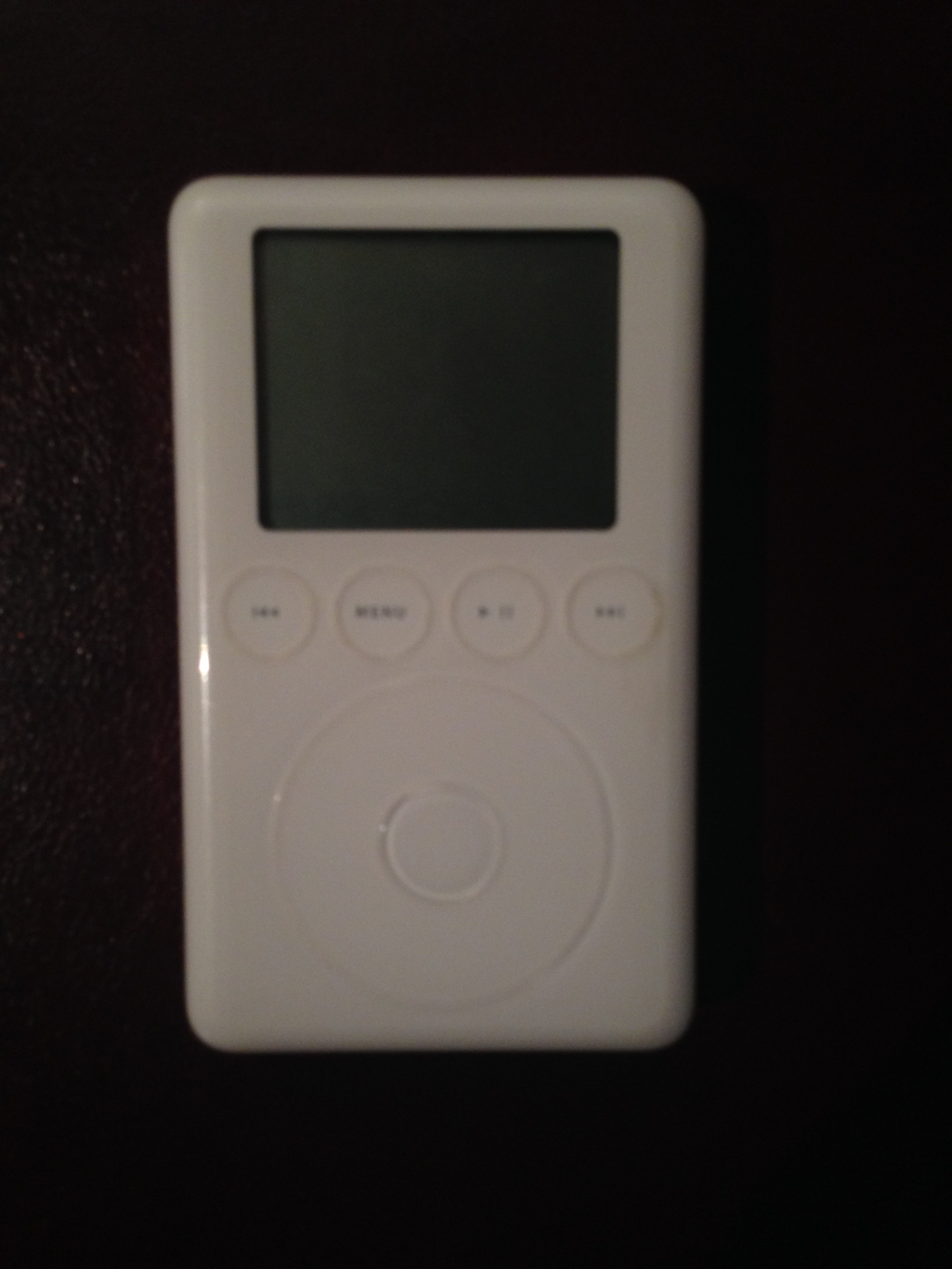

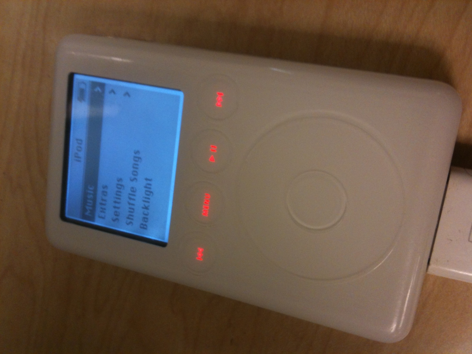

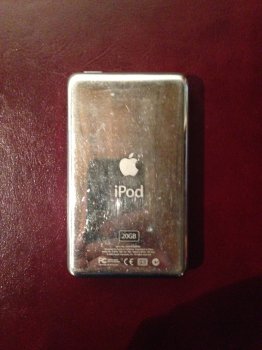

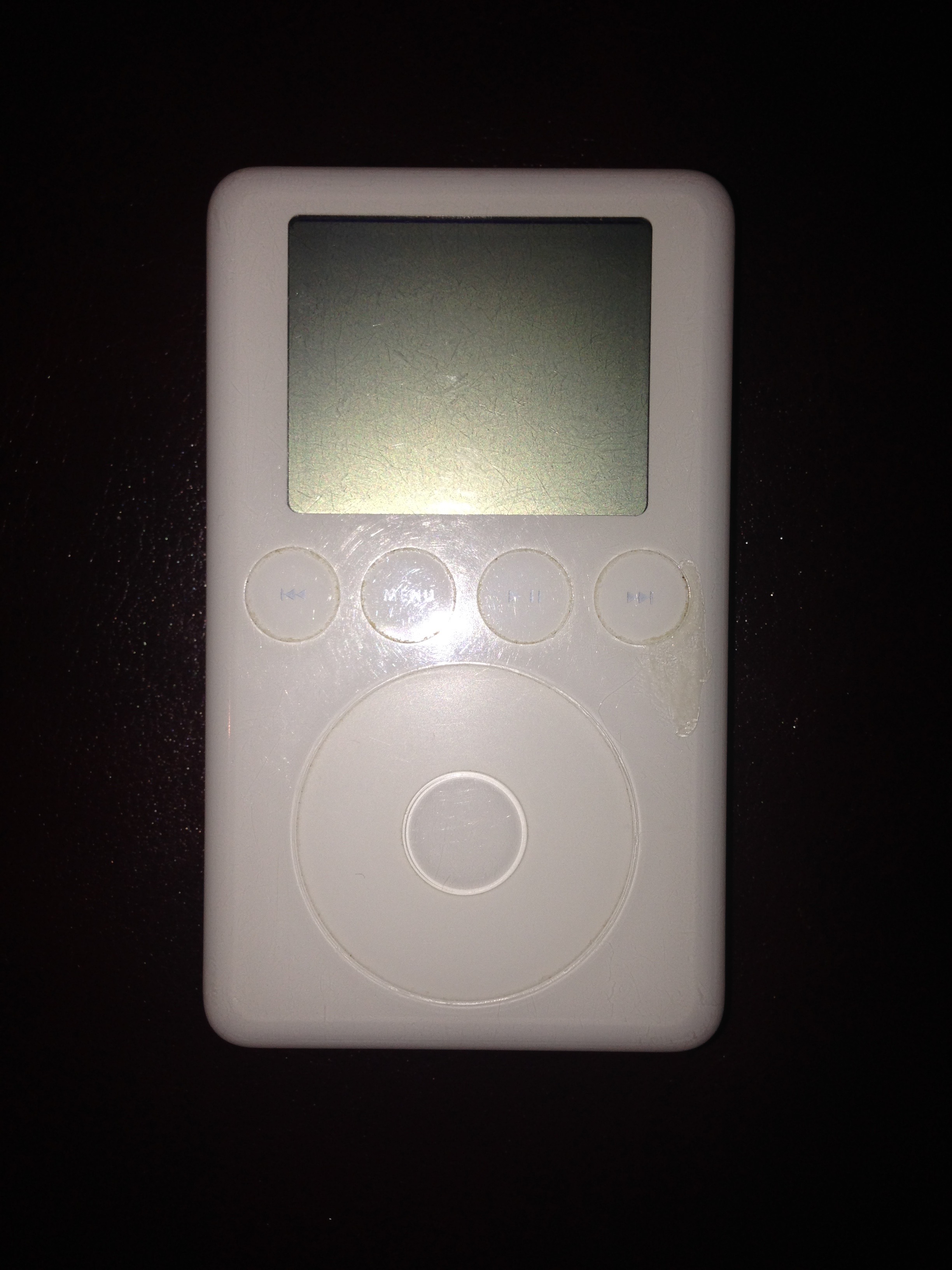

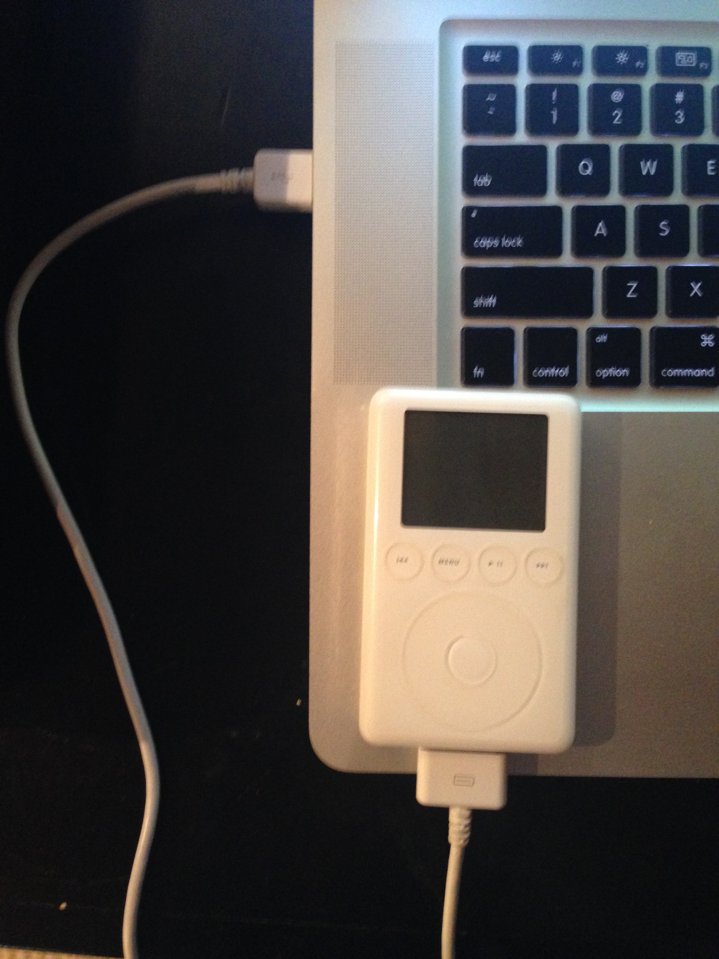

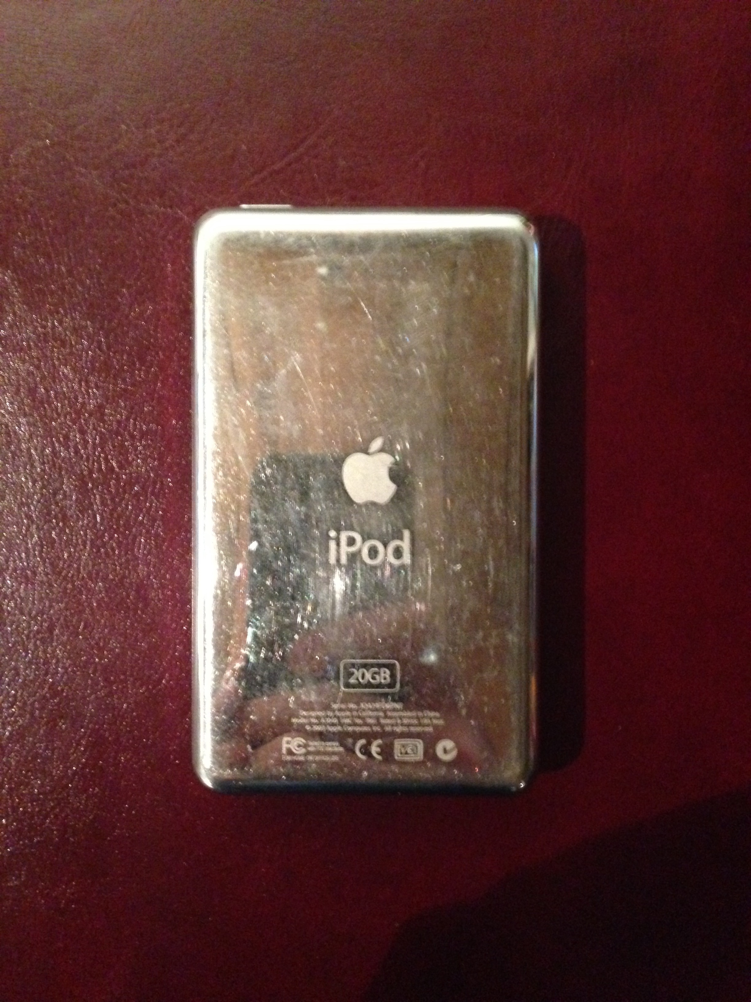

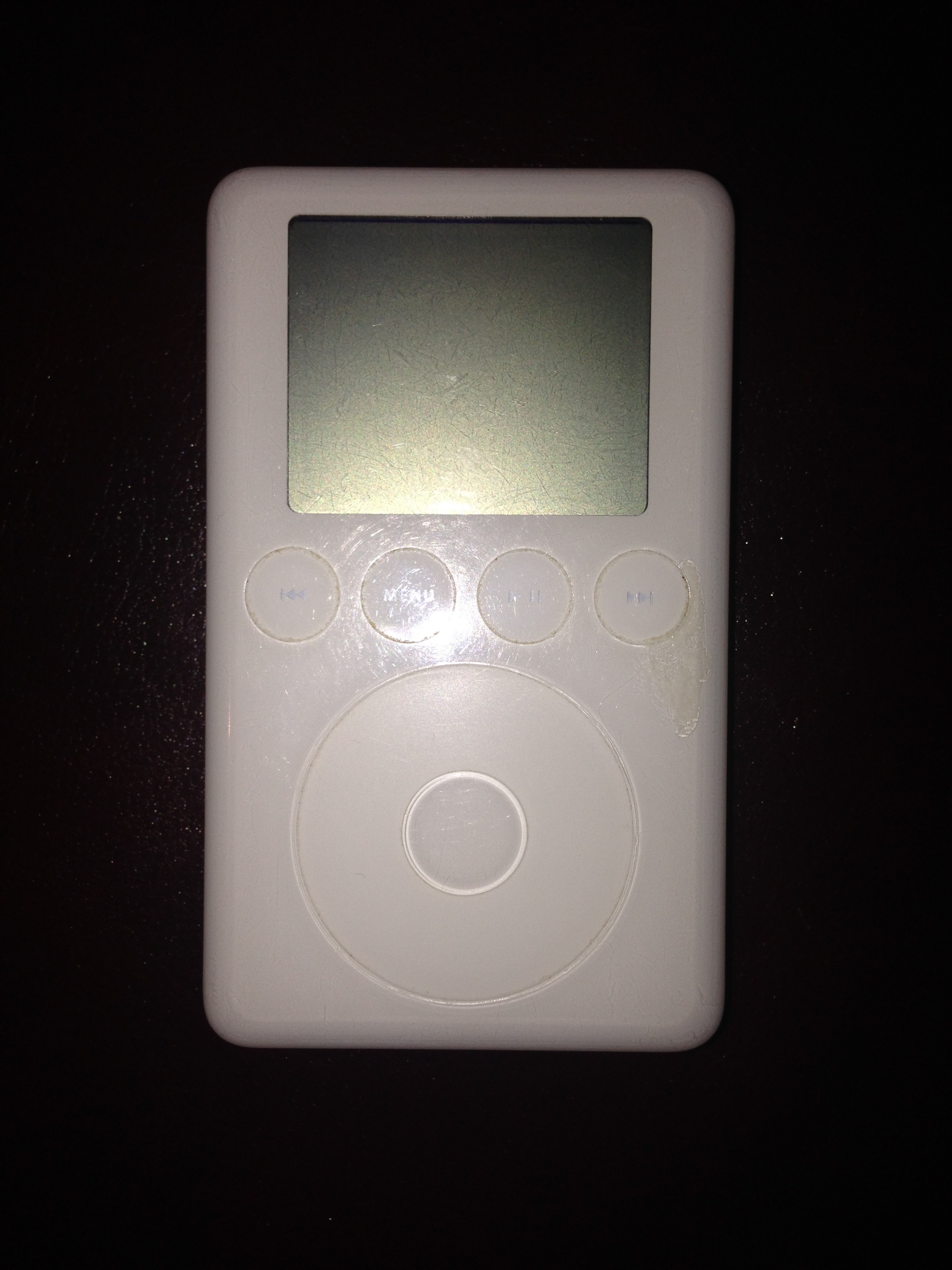

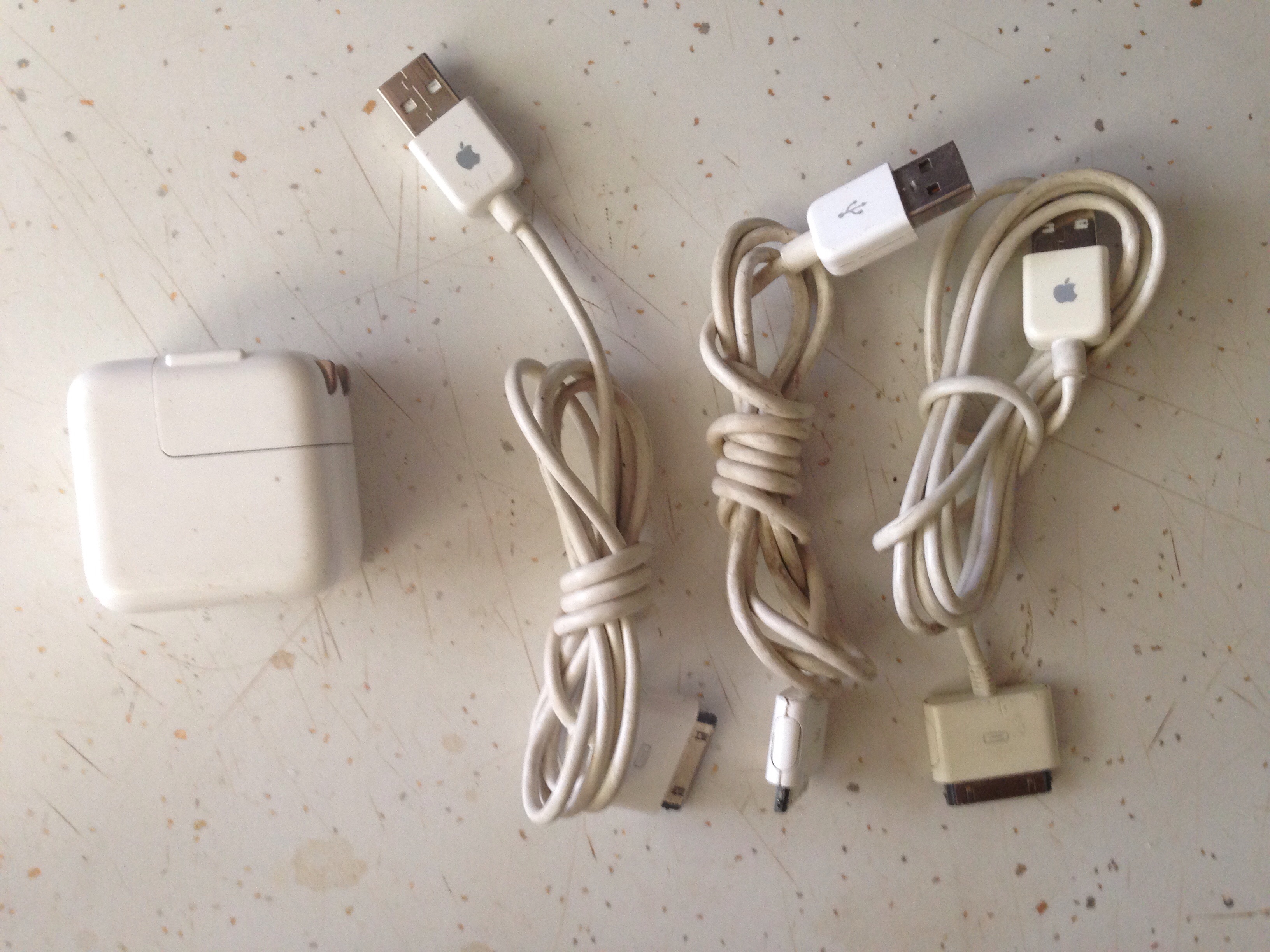

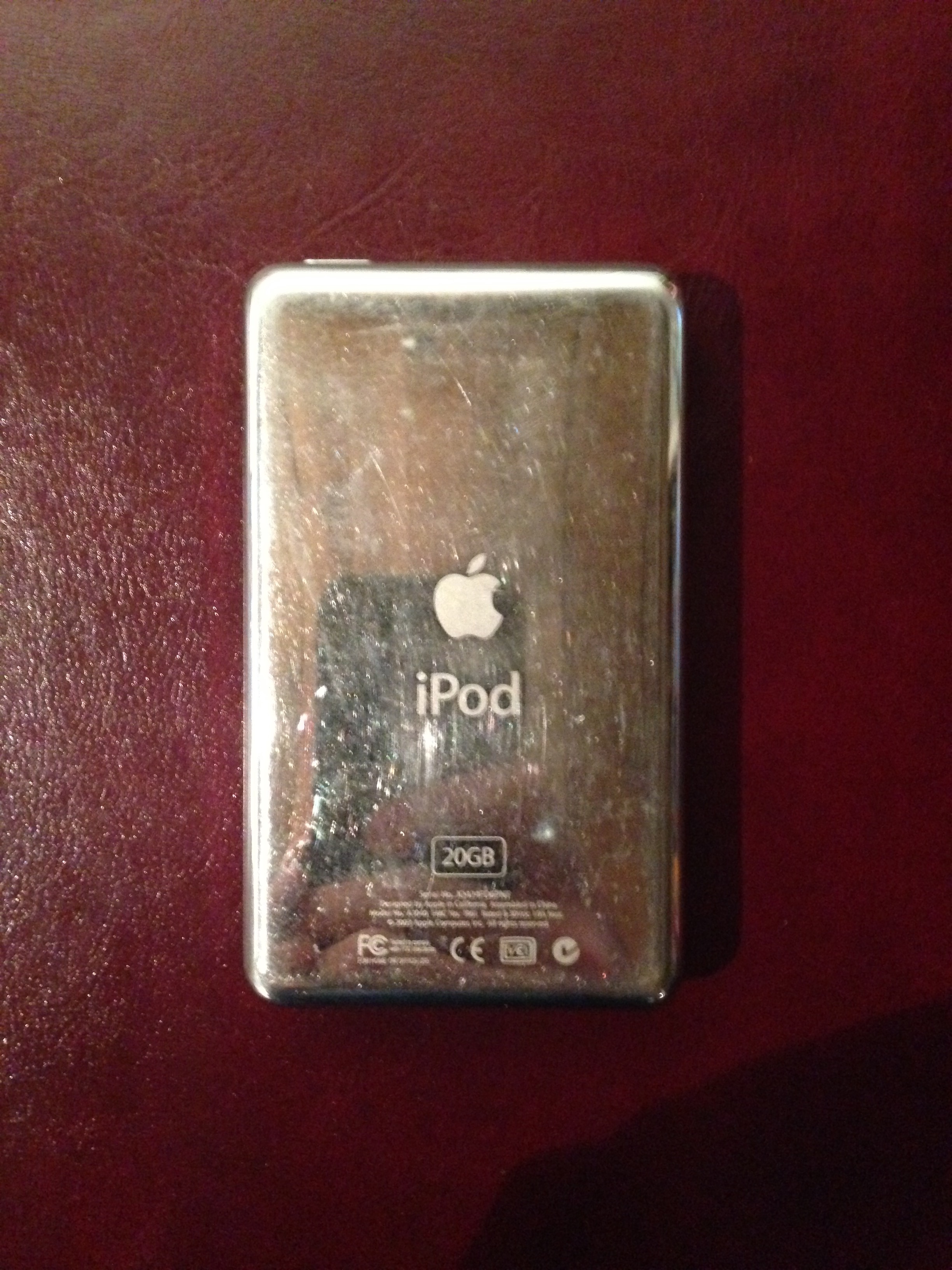

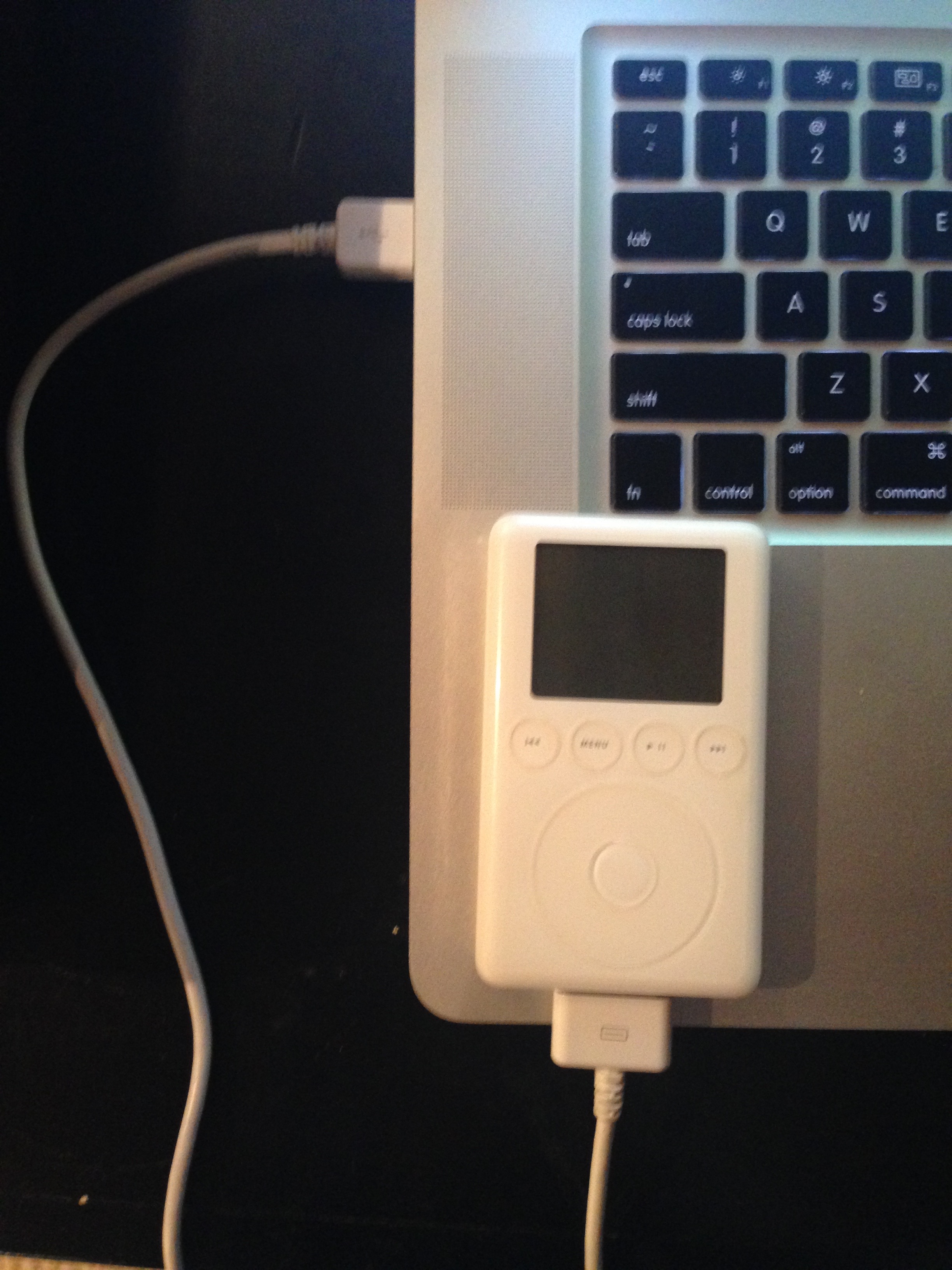

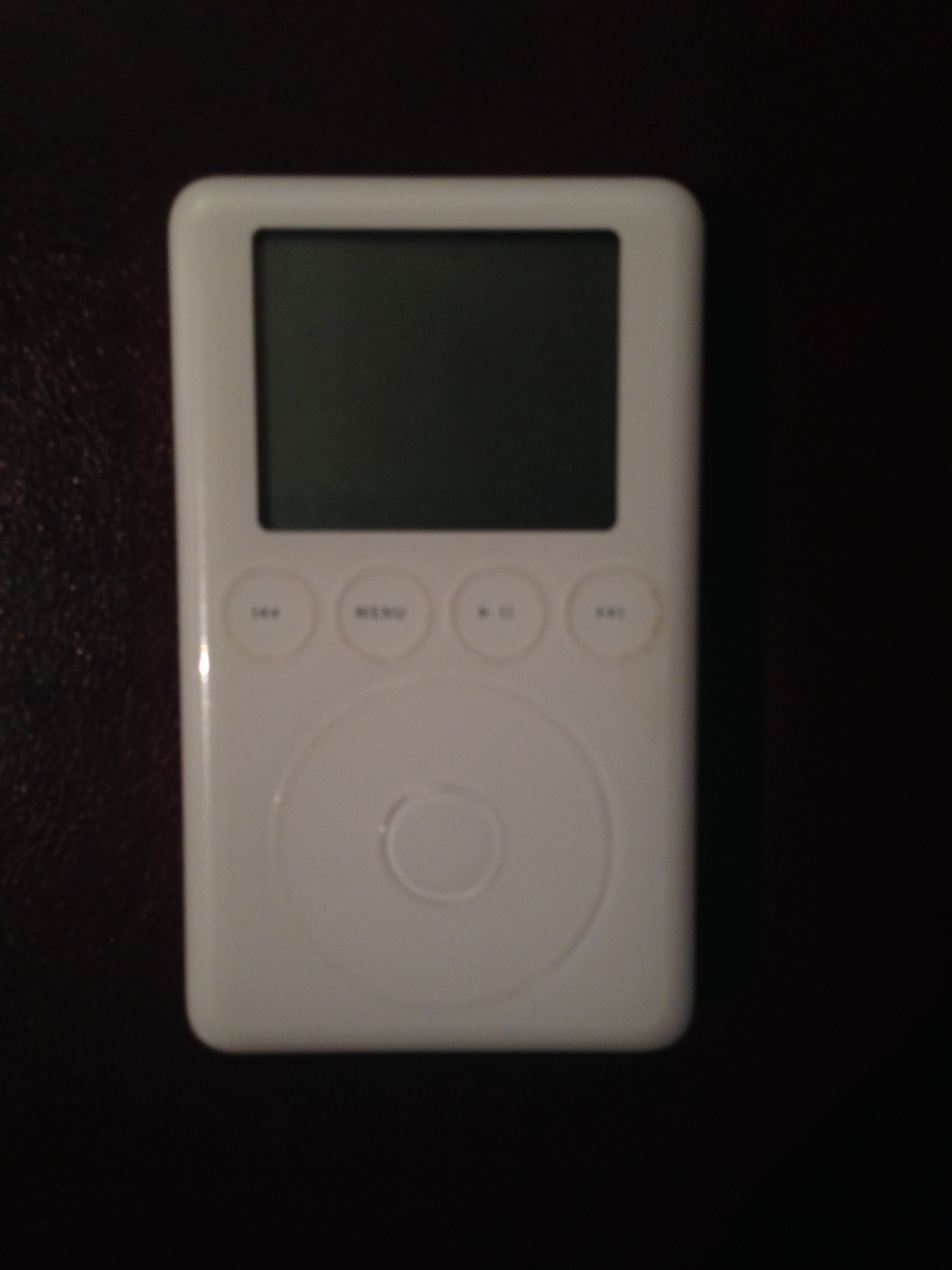

Hello, all!
I found an iPod Classic 3rd Generation at a garage sale the other day.
It doesn't seem to turn on or recognize that it is receiving power.
I'd like to get this working, if there is a simple fix.
Thanks,
-Hunter

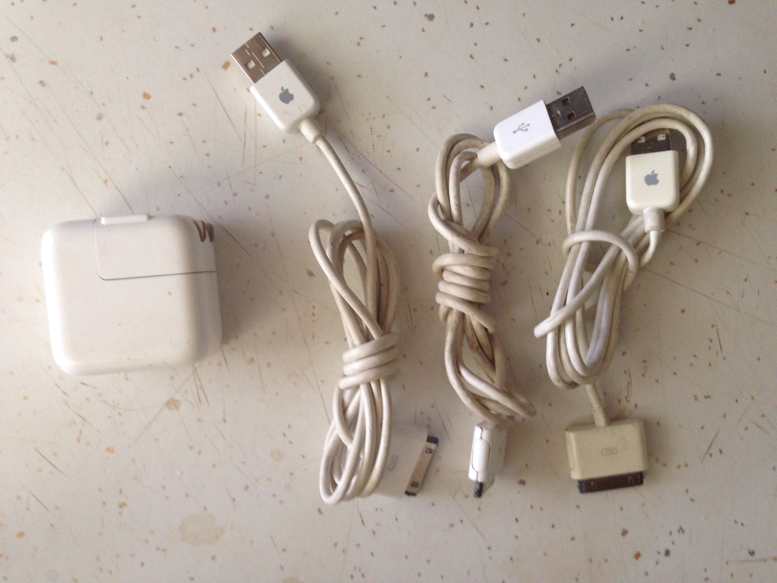

Also, what I've noticed with older iPods that don't have the best charges because of being so old is that the first time you charge it when it's completely dead it's best to charge it with a wall charger until it has enough power to reliably stay connected to the computer.
Hope you get it working!
Yeah, just went through this. You need a 30 pin to firewire and a firewire plug to charge it, and then a 30 pin to USB to transfer music to the iPod. It will not charge off USB, but otherwise it will work fine.

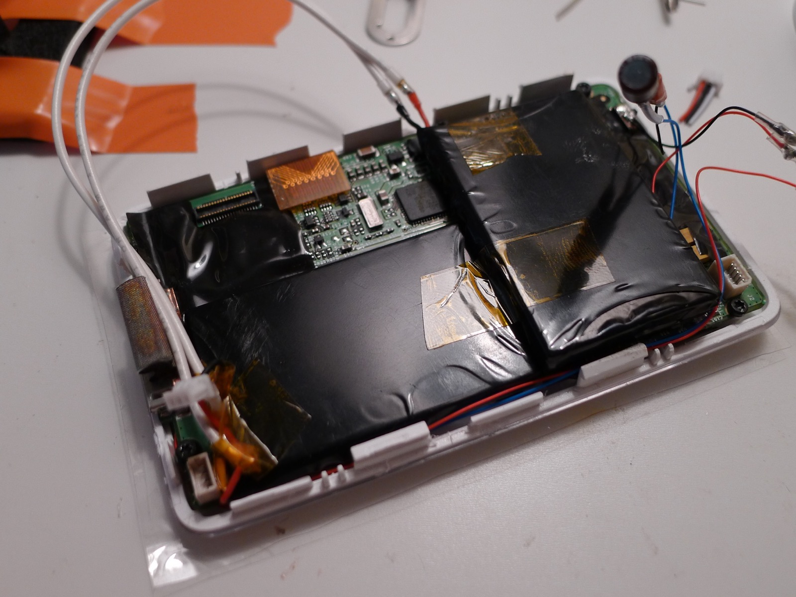

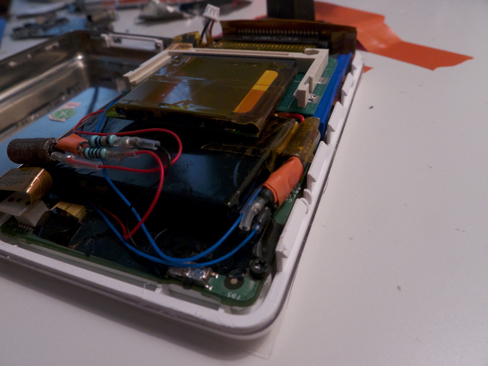

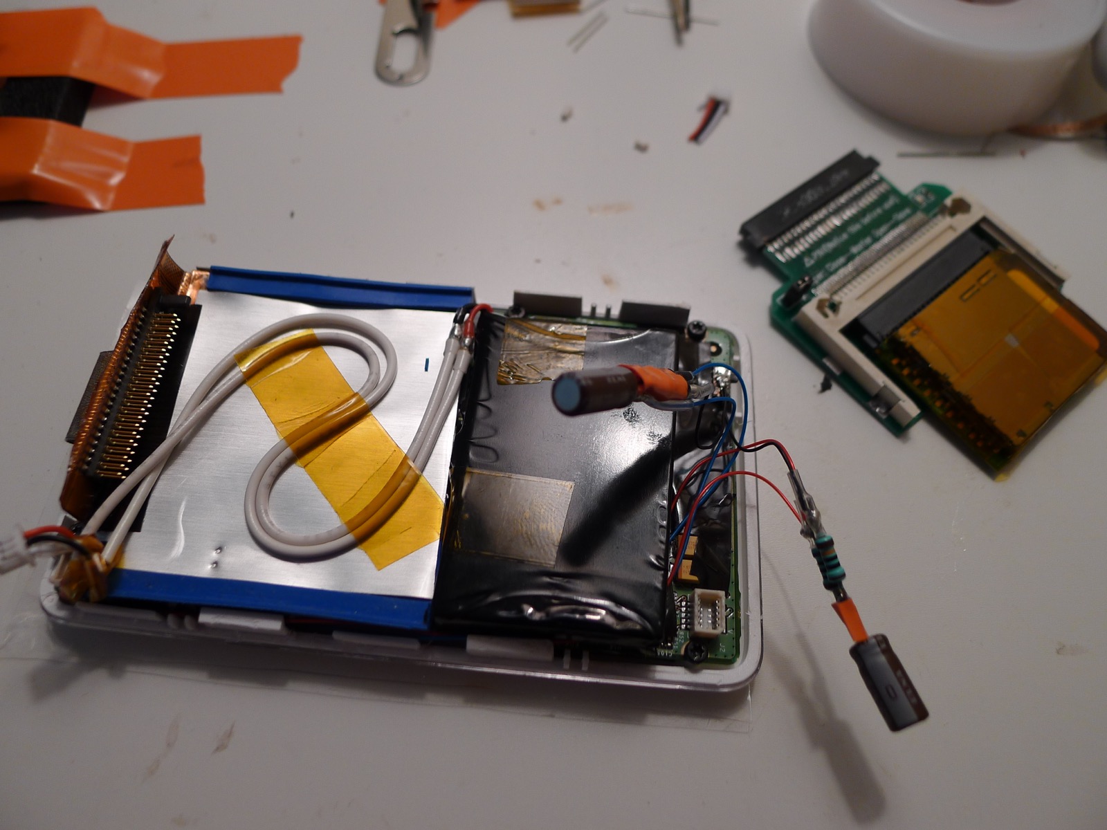

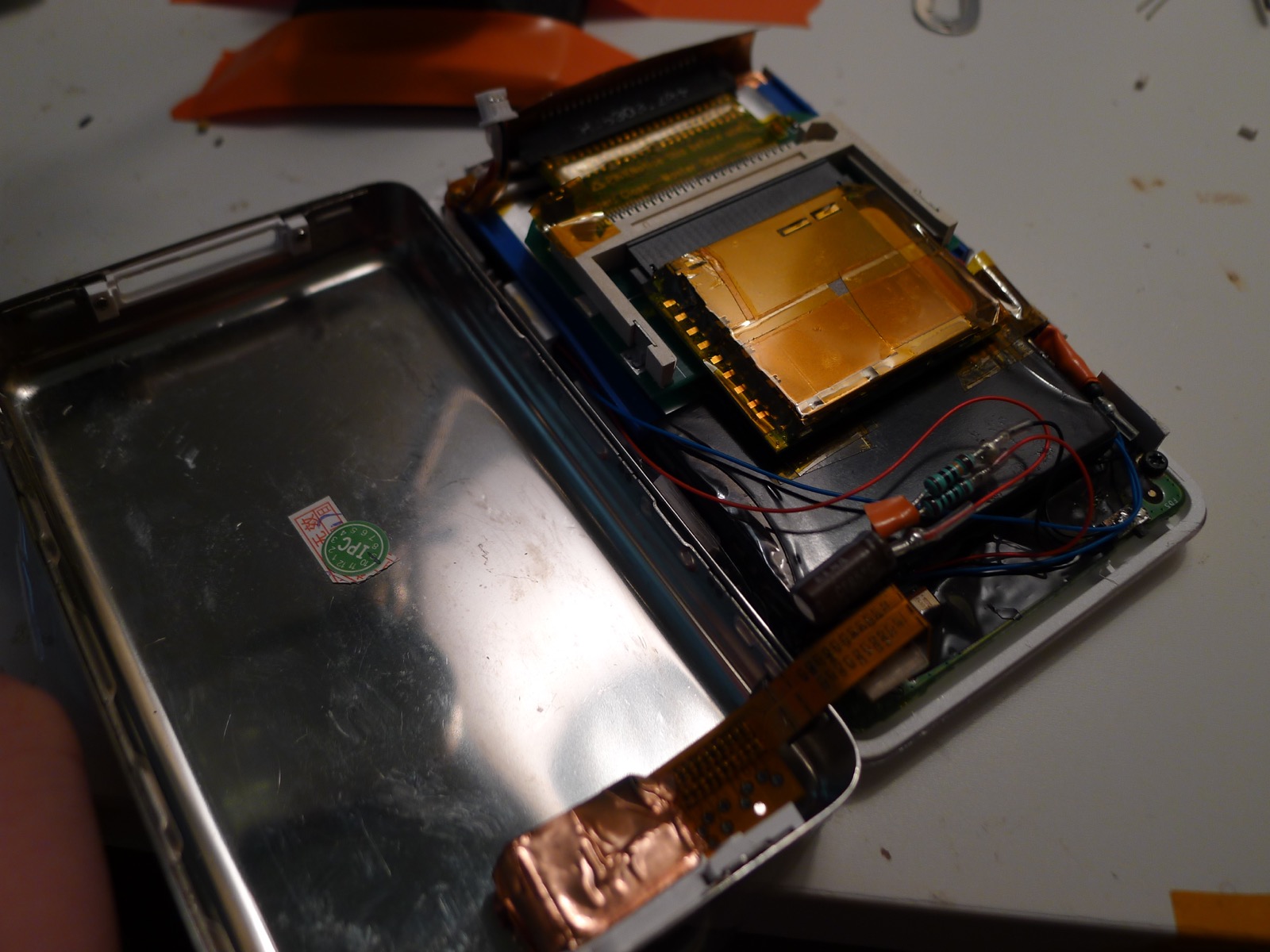

I did a fun mod on a 3rd gen, adding a high-pass filter (20Hz), audiophile capacitors, two batteries, and a 128GB SD card. It sounds phenomenal!
Why did you choose to put a second battery? Without the HD you won't need much power, and I supposed the circuit you added doesn't draw out much current as well.
I'm just curious because I'm thinking about upgrading one of my iPods with an SSD or a memory card. But before that, I need to fix at least one of the defective boards...
