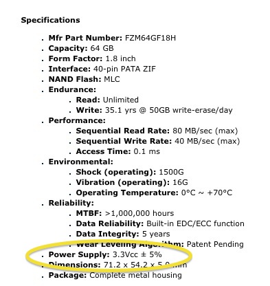

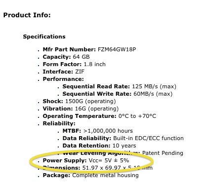

The reason the DuraDrive does not work is that it needs 5v versus the 3.3v that the MasterDrive needs. The iPod will only work with the 3.3v drive.
DuraDrive is the first graphic and MasterDrive is the 2nd.
