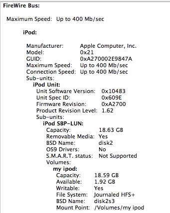

I have an old 20 GB iPod that i now use primarily for transferring files and backing up my current music library in disk mode. Some time back, my ipod turned into a volume instead of the ipod disk (see attachment 1). After i transfered a video project (aprx. 10 GB) onto my G5 and then deleted, i noticed that i didn't get the disk space back. So now, i transfered my desktop file, widgets folder and document file onto my TiBook, and now I only have 1.92 GB available. The combined space is not 20 GB and actually not over 10 (see attachment 2).
So, my question is, why am i only loosing space? I delete the files when I am done with them, but i don't get space back. I also included another attachment of what it is saying in System Profiler.
Please help!
-yankeefan
EDIT: Attachment 1 is the attached image. Attachment 2 is to the left and attachment 3 is to the right.

Emptying the trash did free up about 6 GB. It still appears that the video project is still on it.
used space is what my video project was + 1.5 GB.
