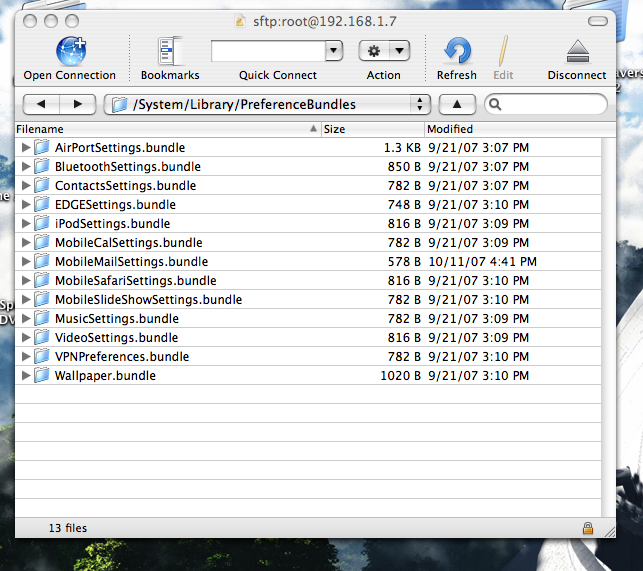

Here is a screenshot:
Everything correct?
Ugh
It still crashes
let me post screenshots of the sftp process

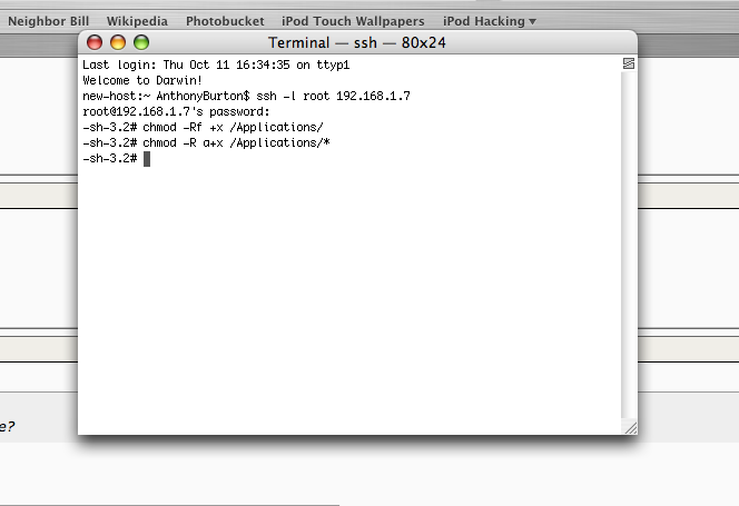

Yea, I had the exact same problem. Only I had forgotten to CHMOD so I had though both of them were bad. It finally clicked soon after...
