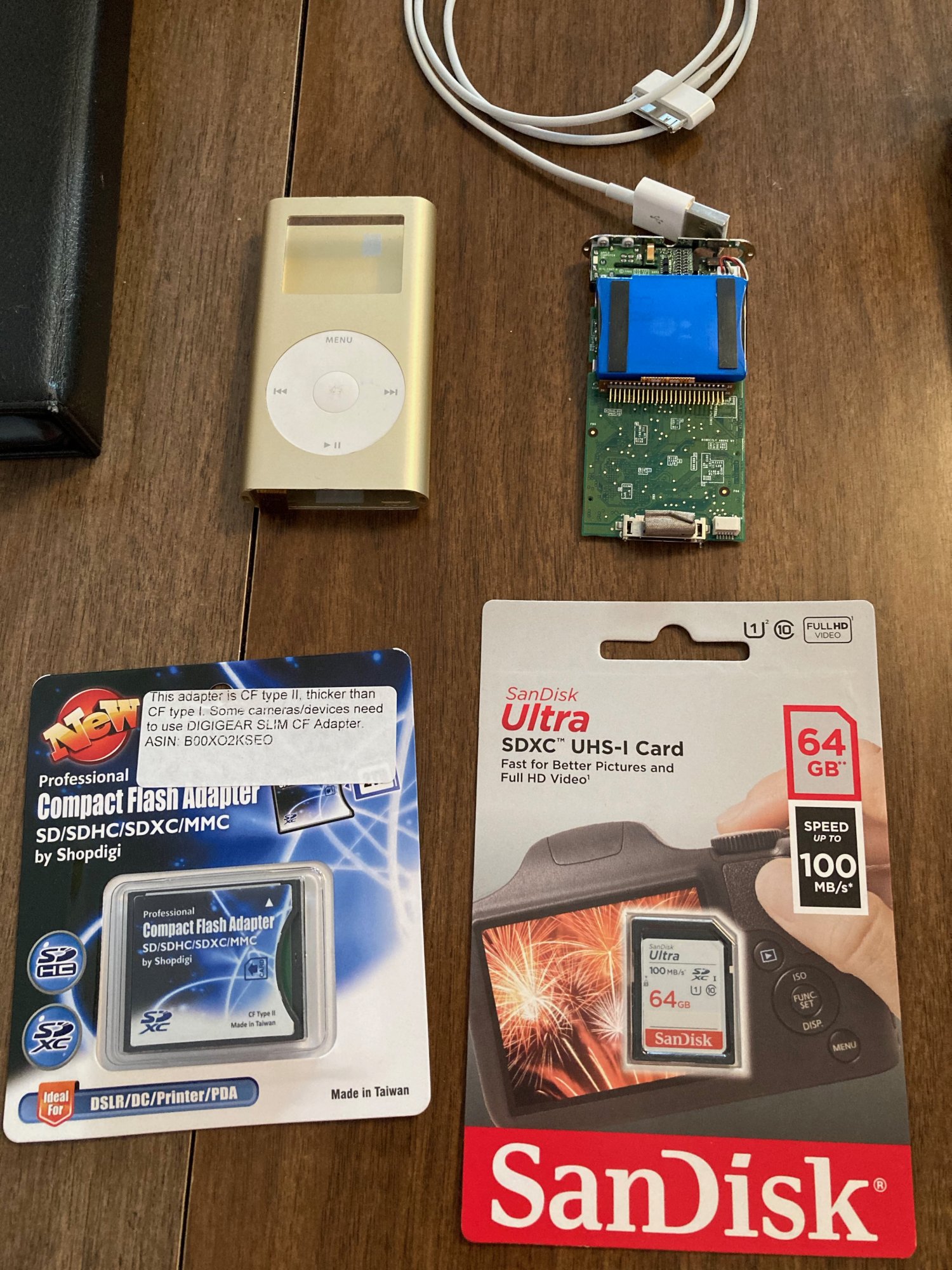

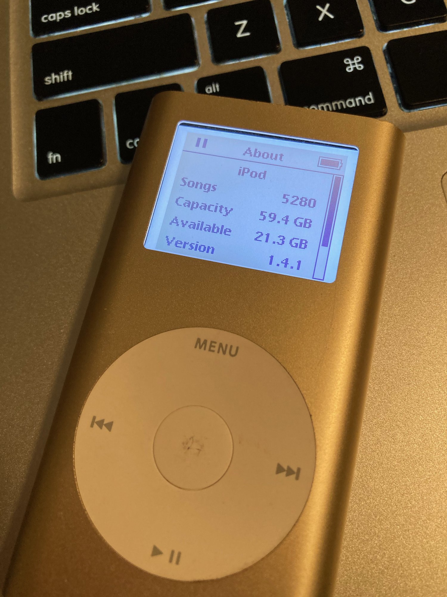

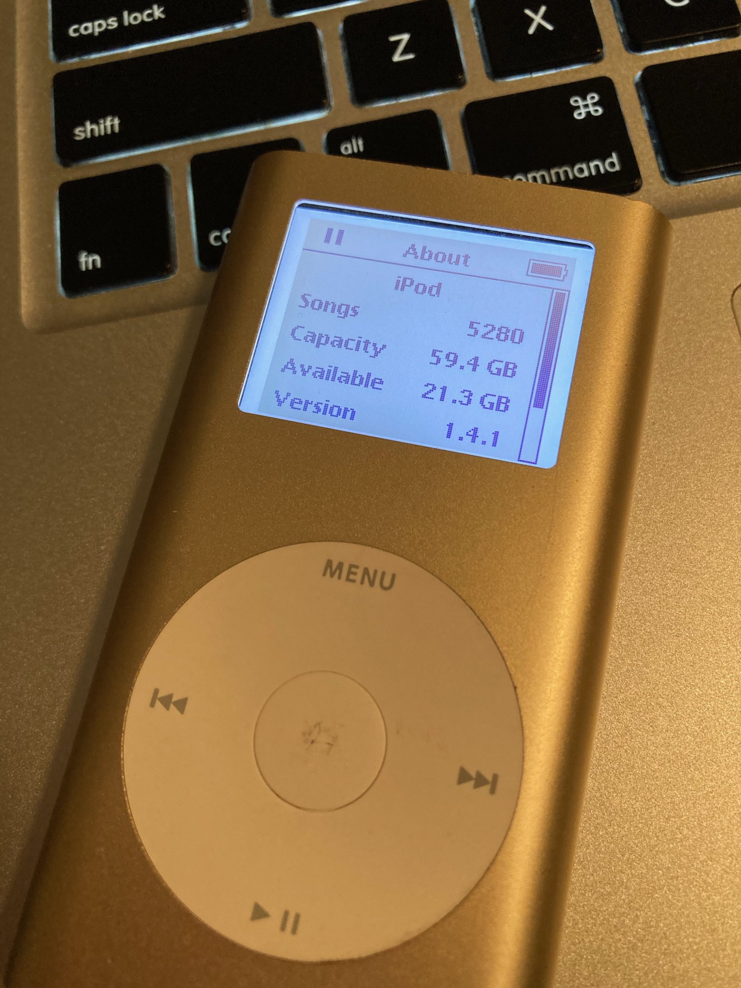

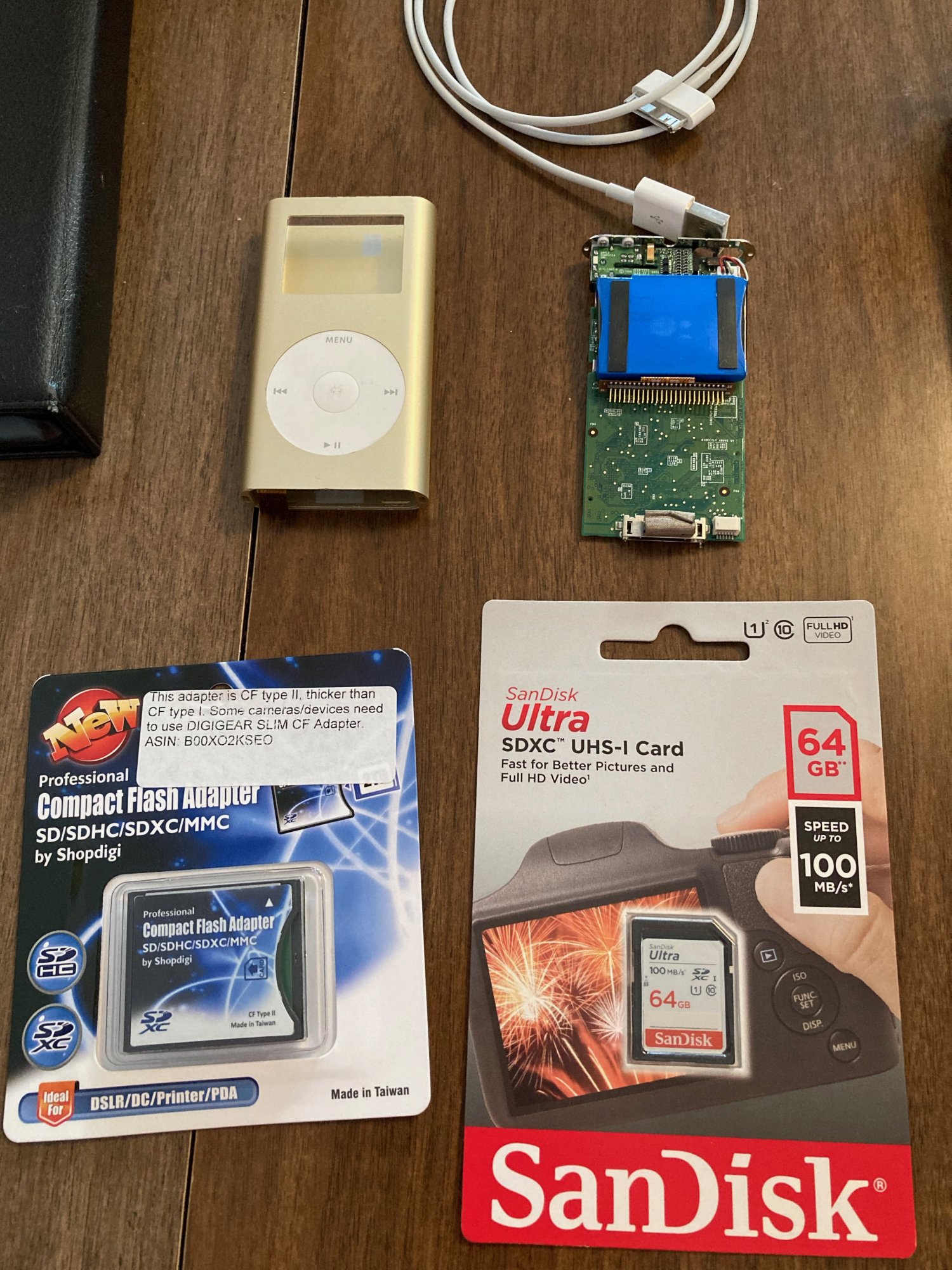

Hi @RockySquirrel. I realize you posted this a long time ago at this point, but I did a bunch of research myself before upgrading my newly acquired gold 1st gen iPod mini. All the results online seemed to indicate that only 2nd gens could be upgraded. I used a generic CF to SD card adapter, and a 64 GB SD card, and it works just fine. Not sure why every place online talks about how only 2nd gen minis can be upgraded, but I decided to try it myself. :p
Best of luck if you are still trying this!
